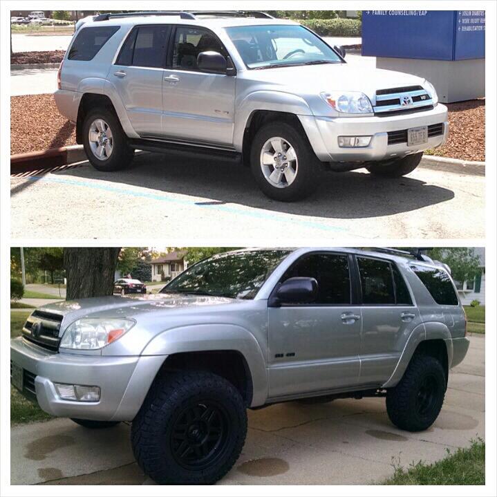

Before:
After:
I'm very happy with the ride, the lift amount, and the rake. Suits my needs perfectly.
And here is the pic after adding black FJ wheels and tires w/ 265/70/17 AT20s. Currently trying to find a semi-aggressive AT w/ snowflake rating.
