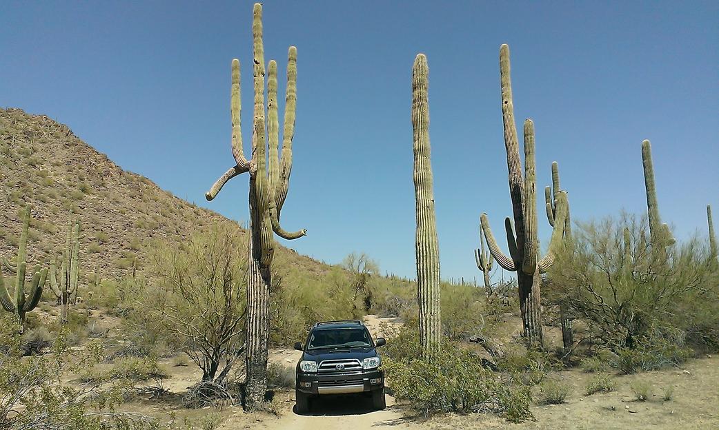

Did some desert offroading a couple of weeks ago. No rock climbing. Just over rough terrain and thru deep washes. The Bilstein 5100s with the FJ springs really shined. It is a nice setup.
