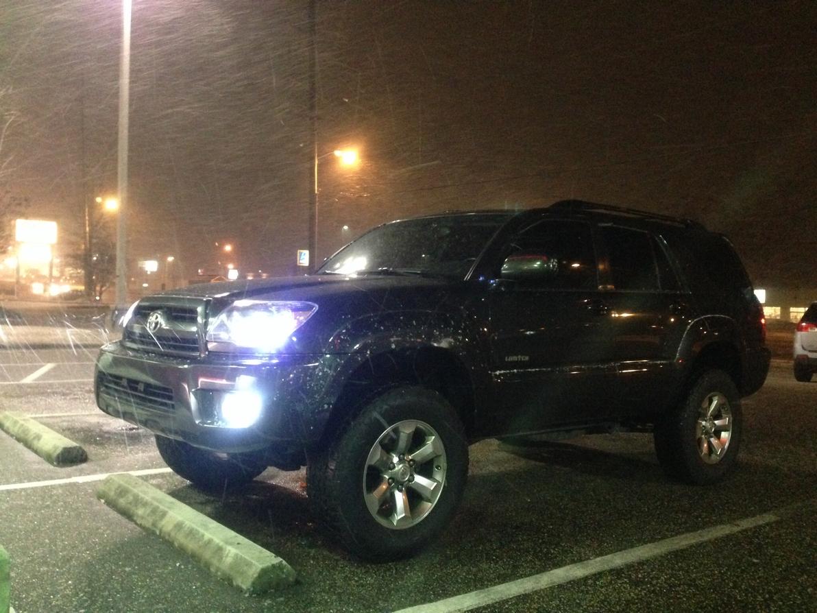

Thanks for all the help from people on this thread. I'm very happy with my current set up. 5100s set 1.75 with fj coils all around and 1.5 d/s spacer on the rear. Ride is firmer with the billsteins but to me it's perfect.
