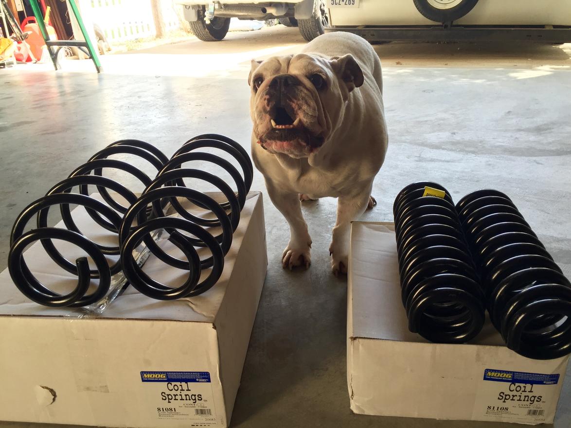

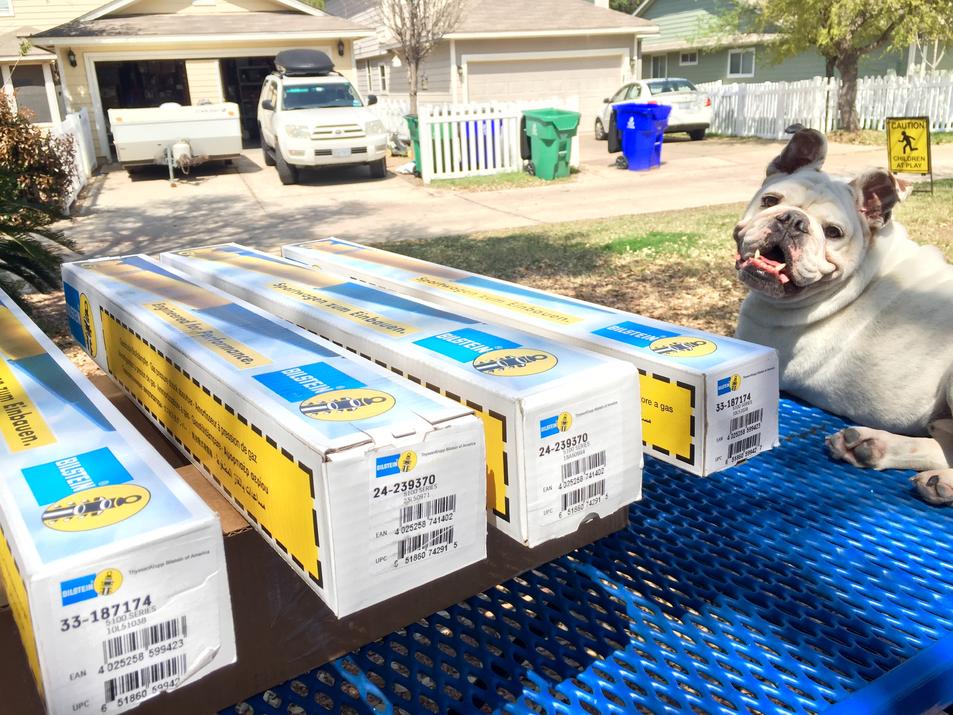

Parts are trickling in....

Mauidriver, what is going to be your end setup? Moog fj coils all around and 5100 all around? What are you setting the fronts at? And are you using rear spacers with the moog rear springs?
I'm very interested to see how it sits when your done if you could please lost pics, thanks!
I'm pretty sure gunna set front at the 3rd notch, which I think is 1.75ish, daystar 1.5" rear spacer. Hopeing it's not going to be too much, but from what I've seen here, it should be about right. I will definitely post some pics.
Awesome thanks. What I'm curious about is that I've read the moog fj rear springs provide about 2" lift by themselves. So I'm wondering with the Daystar spacers how high it will put the rear compared to the front.
I just bought some used fj springs but I might sell them and order the moogs instead
I'm putting together all the notes and trying to calculate that myself, but 2" seems a lot if I were to put the 1.5" daystar as well. Not sure to be honest.
Yea I have a hard time believing the moogs add 2" when they're supposed to be OEM replacements though so you'll prolly be good
[MENTION=90965]Pitbull410[/MENTION]
You will only gain an 1" to 1.25 " with the FJ/Moog Rear Springs if a 2wd rig.
4wd rigs normally see .50"
Combine FJ spring 1.25" with Daystar 1.5" will net you 2.50" -2.75" of rear lift add that with cranking up front 5100's and FJ Coils = sitting level front to back with a 2.50" - 2.75" lift all around just shy of that 3" mark.
Ran this exact set up for a long time with stock UCA and was able to get alignment practically spec on.
There you go boys. That should cover any of the questioning and concerns
