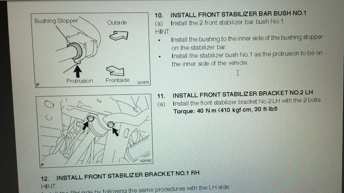

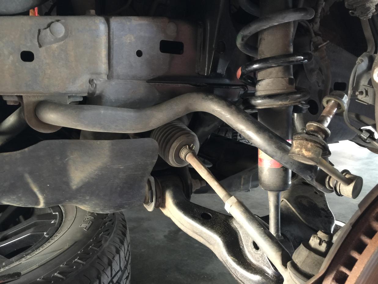

Ok, I'm wanting to move the stabilizer bar out of the way so I can get coil and shock out, do I just loosen these bolts to be able to free it to move out of the way.
If you disconnect the sway bar on both sides you can just pivot it down.
