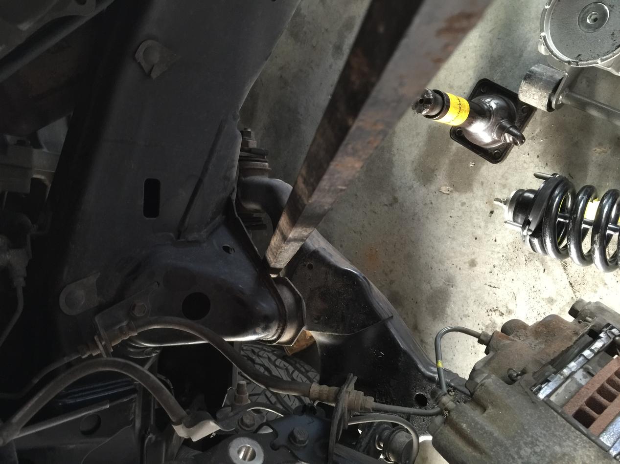

So here's where I'm at. I already had coils compressed in from my neighbor, so all I gotta do is learn how to get into full droop. I've done what most have suggested, but here I go. It's definitely a learning curve involved here, especially since I've never attempted anything like this or even close to this for that matter. Here we go folks....
As you can see, I'm close, but no cigar. This is using the bottle jack pushing down to free up a littl room, and yes, it's scurry :)
At that point I use a pry bar and push it under the shock working it up into the bucket. An extra set of hands here would really help as they can push while you pry up. Once it's in the bucket they will need to guide the bolt in as you pry as well.
Fwiw, I'd say your lca bushings are froze up and that makes it drastically harder. I can now push mine down by hand after replacing everything.
You can do it!!
