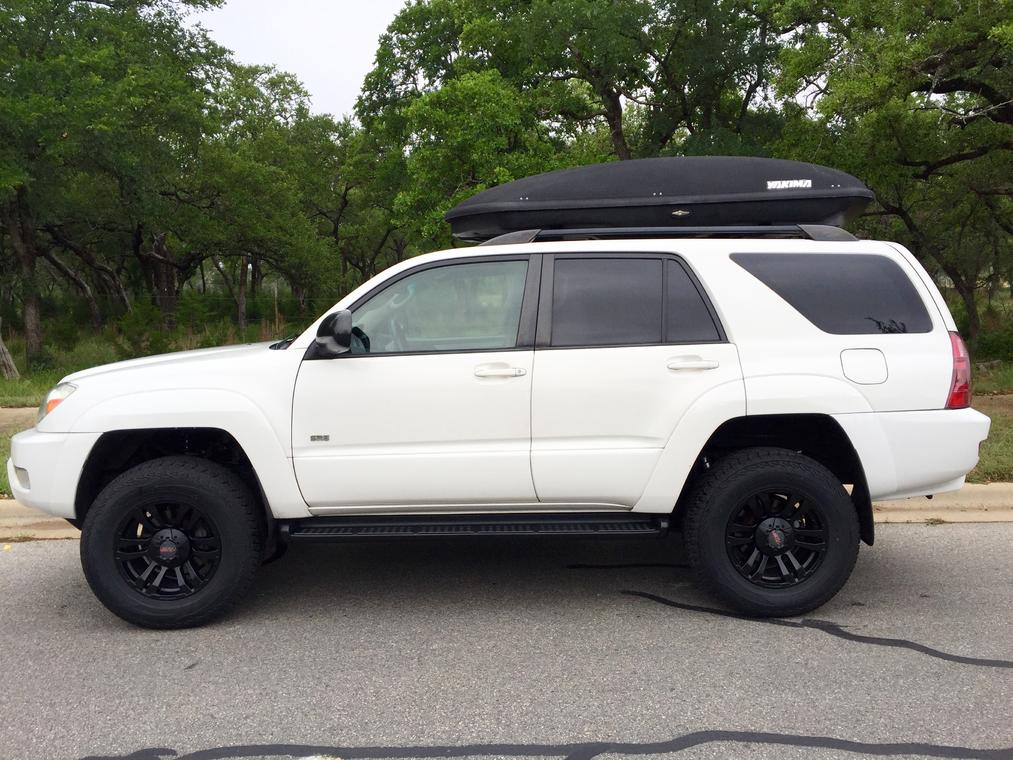

Here's my 4Runner completed, aligned and washed up. 5100's set on 2nd perch, FJ coils all around and no daystar. Thanks so much for your guys help and motivation in making me stick with it and install on my own. Extremely happy with the ride, and final look.

5th gen rear springs fit with no issue. Just to give a heads up if anyone cant find a set of fj rear springs. Like me.
Any lift or same as factory, I meant to ask you that yesturday
Sent from my SAMSUNG-SGH-I747 using Tapatalk
I kinda messed up my measurement when i had the stock springs i think but they had a sag. But between the ome 895e and the 5th gen their the same height. Ill double check the measurement.
For now thats what it seems a little more comfortable. I think ill keep the 895e if one day i need to load up the runner heavy. Since it didnt take me more then 30 mins to swap the rear springs. I still need to measure it i justed wanted to give it some time to settle
