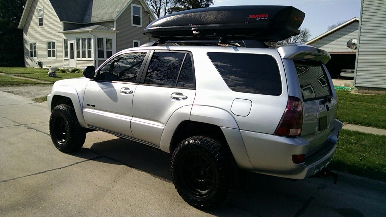

^^^^^ thanks! Here is another picture.

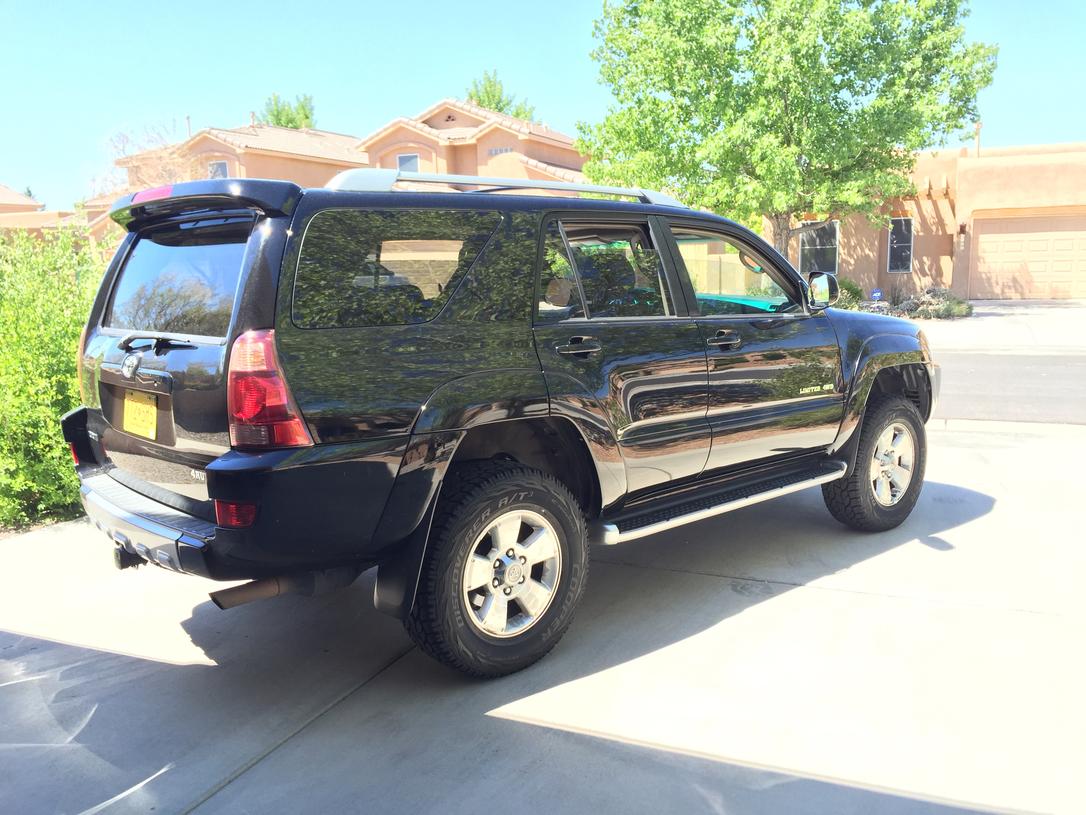

Vachss, alia176 is correct, I did set my front Bilsteins at the third and highest 2.50" setting and being new to all of this didn't even think about the effect that would have on the UCA. When I took my rig into the mechanic shop to do an alignment (a place I've been going to for years and trust), I told them to check out my work to make sure I didn't screw anything up, they did, and reported that although my "toe" alignment was way off and they fixed it, that everything looked good. I haven't had any problems while driving it in the city, highway, or off road (dirt, mud, rock crawling). In fact the ride is excellent.
I don't have any issues with the CV axle angle or with either control arm. My belief is that the way the Bilstein 5100 adjustable shocks are designed allows them to be put in without changing anything else like you would have to if you did a "traditional" lift with spacers, etc.
I think with a V6 you will be happy with the 1.75" setting and will not have any of the problems you mentioned. You can see in the pic that the highest setting for my 4runner looks pretty level. However, when measuring the running board, it is a little less than a 1/4 inch high in the front. The measurement at the wheel wells, though, shows the rear being 1/4" higher. So, the frame is not really level, it is a touch nose high, but the eye sees the truck as level because of the wheel wells. For my purposes, I like it like that.

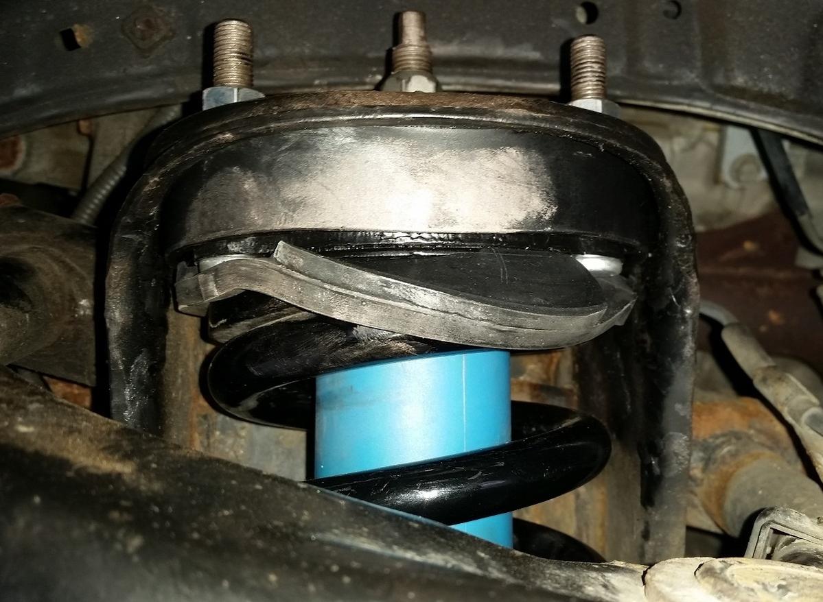

2005 V6 4wd
Replaced fronts with FJ Trail Shocks and Coils.
Added Daystar 1" budget boost - KT09117BK
I checked everything over at about 100 miles and I noticed the rubber piece that goes between the top of the coil and the upper strut mount has smooshed and pushed out on the drivers side. Coils are not upside down.
Any thoughts? Common? Bad?

2005 V6 4wd
I figured id start in this forum first.
Also interested. Just looked and mine is doing the same thing...
