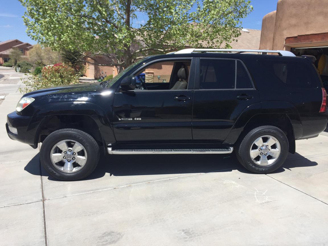

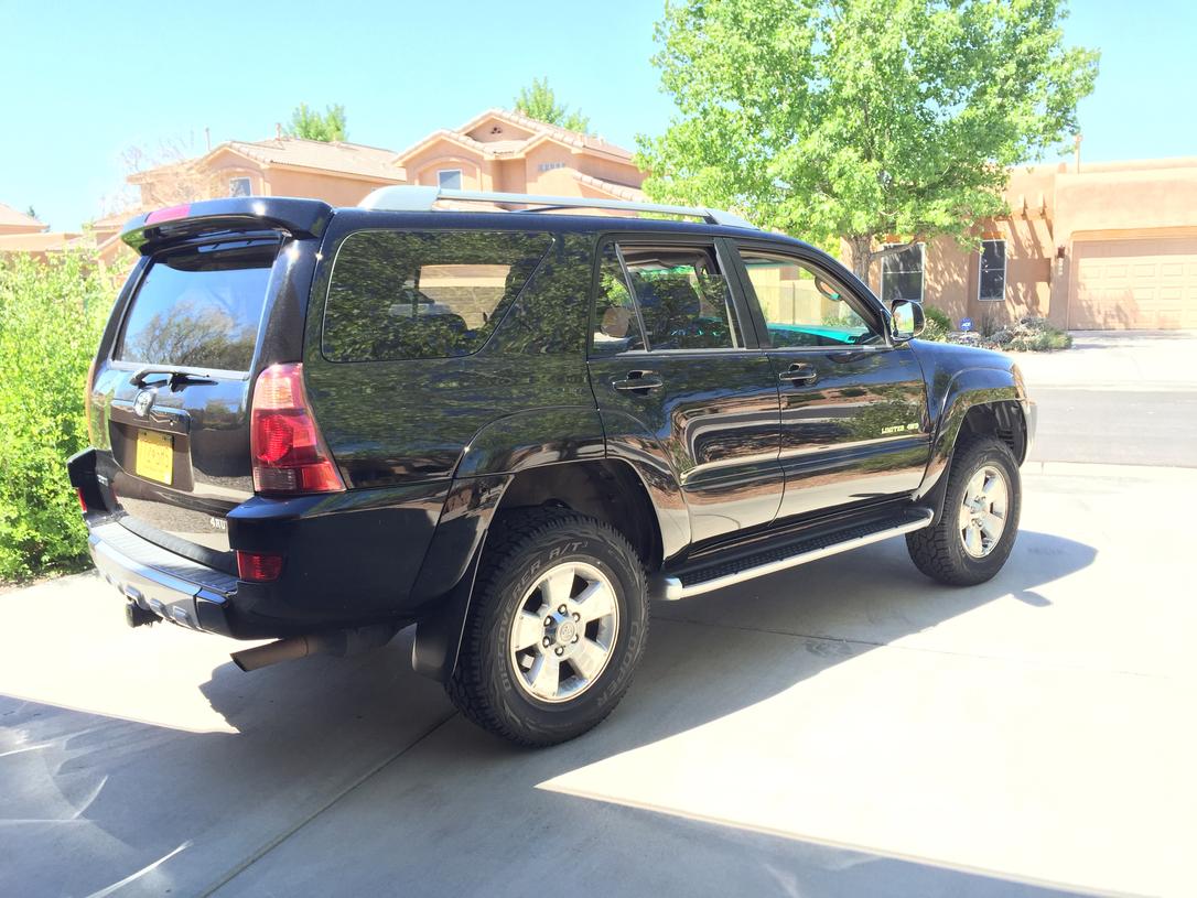

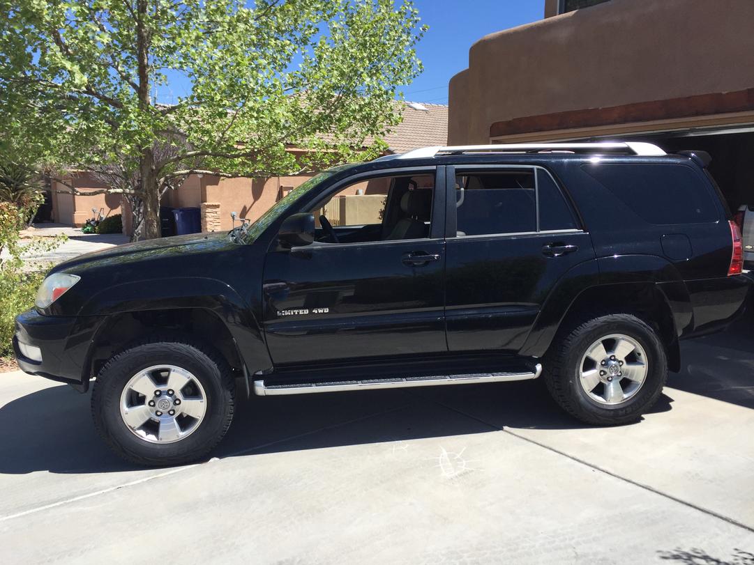

This thread was invaluable for me. Thanks to all who have contributed. I finished my FJ spring/Bilstein 5100 swap just last week and here are some of my observations:
I used the no spring compressor method and it worked up to a point, which I will get to later. First, installing the rear FJ springs (4x4 version new from MOOG) and shock was pretty straight forward. If at all possible for those who are yet to attempt this swap, get a helper! I was able to do one side by myself, but just could not get the other spring in without having my very helpful wife push down on the axle so there would be enough clearance for me to muscle it in.
Second, the front went well except for two points. The first was that with the rear already 2" higher than the front and a V8, I set the Bilstein 5100 shock to the 2.50" position, the highest one. With that setting I was unable to push the LCA low enough to get the everything in there. Perhaps the no spring compressor method works for those setting it at 0.85" or even 1.75", but not for me at the 2.50" setting. So, I took it to a Firestone auto care and half an hour and $30 later the springs were compressed on the upper mounts, which I had also bought new to replace the old ones. With that done putting the strut in its mount was actually not that hard! The second point was that I absolutely, positively, could not loosen one of the upper mount nuts on the driver side. After spending an eternity on the stuck nut over an afternoon and the following morning (AGHHHH!!!!) with PB Blaster and even a blowtorch and bending out some sheet metal from the wheel well into the engine compartment (yes, that actually had to happen) to get enough space to get a 10" breaker bar (the biggest one that would still fit in the wheel well) and 14 mm socket onto the nut, it came off. Bad luck for sure, because otherwise the front, once the strut was preassembled by the auto shop, was also pretty straightforward.
The upper mount and bushings looked no worse for the wear once I had them out, so my advice would be if you are not setting the 5100's to 2.50" then just leave the old mount in there (and not have to worry about a potentially stuck nut in an inaccessible position!) and use the no spring compressor method. Save the money and the hassle of removing the mount. For me, I would have had to get the springs mounted on the strut at an auto shop anyway because of the higher setting, so it's a good thing I already bought the new mounts.
The measurements I got before and after, both on level ground and with a full tank of gas are as follows (with the after on new Cooper AT3 265/70/R17's):
Before -- front from ground to top of wheel well fender 33", rear 35"
After -- front 37 1/4", rear 37 1/2"
I am VERY happy I set the 5100's to 2.50". The ride is great, the best I can describe it is exactly like in the OP's post, like stock when the car was probably new, but better. Less roll when cornering, but not overly stiff or harsh. Very smooth ride. I love that it's "lifted" without "lifting" it. Nothing other than new springs and shocks. I also love that it is very close to level front to rear. Goal accomplished.
Here are some pics to prove my limited mechanical acumen. The first is after the swap but still with my terrible Bridgestone 265/265/R17's and the last two are with the new Cooper AT3 265/70/R17's:

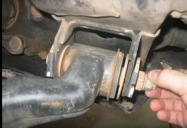

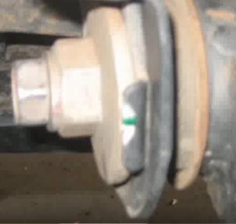

Glad you had success. The trick with the no spring compressor method, is you have to loosen the eccentric cams that connect the lower control arms to the rest of the truck. (See figure below)
First, mark the cams and the truck itself with a paint pen or sharpie, so that you can put them back to where they were before you started. Then loosen them. Once they are loose, and everything is disconnected, they can literally go down as far as you need... by that I mean a full 90 degrees so that they point directly at the ground, instead of pointing at the tires, and it doesn't require any force, pressure or prying. Once the cams are loose, the lower control arm will move freely as much as you want it to move.
Also, after you're done, GET A FOUR WHEEL ALIGNMENT.
Changing the suspension, changes the geometry, so your truck WILL be out of alignment. Even if it seems to ride well, if you don't get a 4 wheel alignment done, you'll see the result down the road as you prematurely wear out your tires... which will cost you a lot more than having the alignment done. Plus, I'm told if it's really off, there could be a safety issue too.

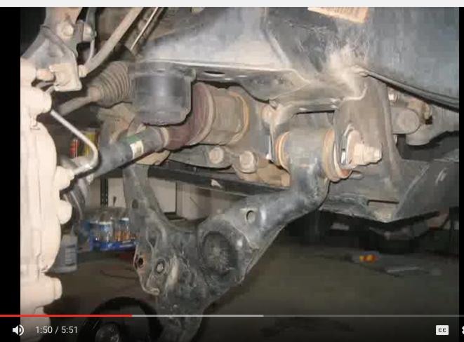

Tips and video for replacing struts without using a spring compressor...
Search youtube for videos. Here's a link to a great youtube video for this method on a tacoma. It's the same on the 4Runner.
This youtube video series (parts 1, 2 & 3) are also good. They are more thorough, and have a real person speaking, and showing you what to do and how.

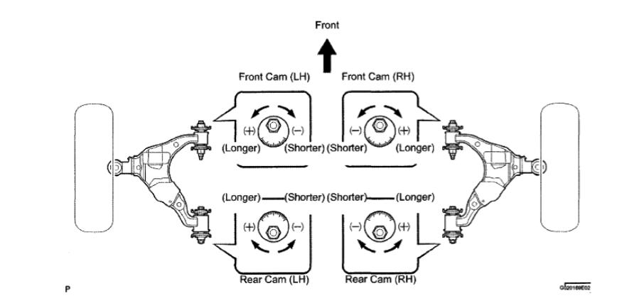

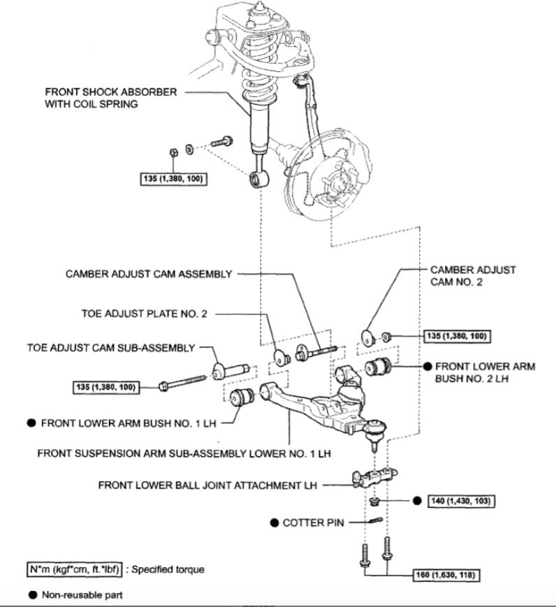

Here's a second figure that shows more parts with more clarity.
This image also specifies torque settings as N*M (kgf*cm, ft*lbf).
From this image, you may even be able to visualize how the no spring-compressor method works.
Look for a complete description about jacking up the truck, and supporting it on jack stands, and removing the tires.
I'm assuming you've already done that in this write up.
Next, you remove the two bolts at the very bottom of the picture, and move the brakes out of the way.
Then you support the lower control arm near the "front lower ball joint attachment" using a floor jack or a bottle jack. Jack it up a little bit, so it really supports it, or even compresses the spring a little more (a 1/2 inch to 1 inch is fine. Don't measure... it's approximate).
Now mark the settings (on the cam and the frame) for the "toe adjust cam assembly" and "toe adjust plate No. 2", and the "camber adjust cam assembly" and the "camber adjust cam No. 2".
Then loosen all four of the cam nuts and bolts. This part loosens up the lower control arm, so that it will be able to swing freely.
Now, remove the nut from the top of the shock absorber. Just the 1 nut on the very top.
The shock absorber (or part of it) may start to spin, instead of the nut turning. If this happens, you will find a place on
the shock itself that is shaped so that you can hold it from spinning using a open ended wrench (or possibly large pliers in a pinch, but
the large pliers will mar the metal).
Next, SLOWLY lower the jack that is supporting the lower control arm. As you do this, the spring around the shock will decompress, letting all of the pressure off of it.
Now you can remove the nut and bolt that hold the bottom of the shock absorber to the lower control arm, and remove the shock and coil spring completely.
The lower control arm can now move freely and go down as far as you need it to. aaa3_lowerControlArm.jpg
Reassembly is the reverse. note how the coil springs sit, and don't forget that FJ cruiser springs have different springs for passenger and driver side in the front. (the rear springs are the same).
Also, as you install the new shocks with springs, you may have to guide and "aim' the top of the shock to make sure that it's aligned with and actually passes through the hole in the center of the top hat, so that you can put the bushing, washer and nut back on.
Hope this helps.
-Phil

Fwiw I have a cheap set of spring compressors I bought from Sears many years ago. I had absolutely no problem compressing the springs far enough to assemble the coilover before installing. It's safe and easy if it's used properly
Thanks for posting those pictures pj. They really help to visualize the whole suspension assembly. Do you need to support the hub after you lower the LCA?

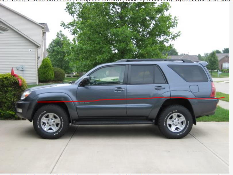

I'm sure this has been discussed before so just point me to that thread. Those of you who are "leveling" your ride, what point of references are you using for this task? Another words, how do you know when you're actually level?
At a distant glance, it looks like the front and rear wheel well openings have the same amount of opening. This is not the case on my landcruiser, where the opening of the front wheel opening arch is way higher than the rear opening arch in order to accommodate the front tires going up/down while turning.
Is this an accurate assessment?
edit: a uploaded a crude representation for illustration purposes.

Most measure the wheel well opening. Some the frame. I feel the wheel well is closer and the look will be right. If you measure the frame so it's the same front and rear it will look nose high IMHO. The stock rake is pretty drastic. I aim for the rear to be 1" higher personally because then if you put weight in the rear it's sitting level.
alia, on the 4runner, the point of reference for me and most of us is to measure from the ground (level, of course) to the center top of the wheel well fender. That gives an apples to apples comparison of if your vehicle is slanted towards the front or the rear and disregards any difference in space in the wheel well above the tire (which may be arbitrarily higher in one or the other but has nothing to do with which direction your vehicle is raked) .
In my case the before measurements showed that the rear center top of the fender was 2 inches higher than the front. After the FJ spring swap and setting my Bilstein 5100 front shocks to the 2.50" setting the same measurement showed that the rear was 1/4" higher than the front. Looking at it in person it looks level.
[MENTION=119796]alia176[/MENTION] On the 4th Gens the rear wheel well is actually bigger. To truly "level" the vehicle measure either the running boards right behind the front tires and right in front of the rear tires to the ground. If you do not have running boards, measure the straight lip right under the doors under the kick panel. Here is a "worksheet" of my truck for reference when when I was trying to level it out and replace the rear springs.

I have now added new rear springs and the vehicle looks level, but my measurements are actually RF = 38 3/4" and RR = 40 1/4". Not a great pic on a slightly sloped driveway.
100_3286.jpg~original
ahhh, got it. I still have my running boards on the rig and will use them as a point of measurement. I'll level the rig with a floor jack and a 4' level on the running boards then see how things look. Thanks for the info.
Normally, I don't measure from the ground up to the fender lip but use the center of the axle to the fender lip. This way doesn't rely on the tire sidewall bulge/air press/etc to mess up my spring lift measurements.
Thanks again for the info.

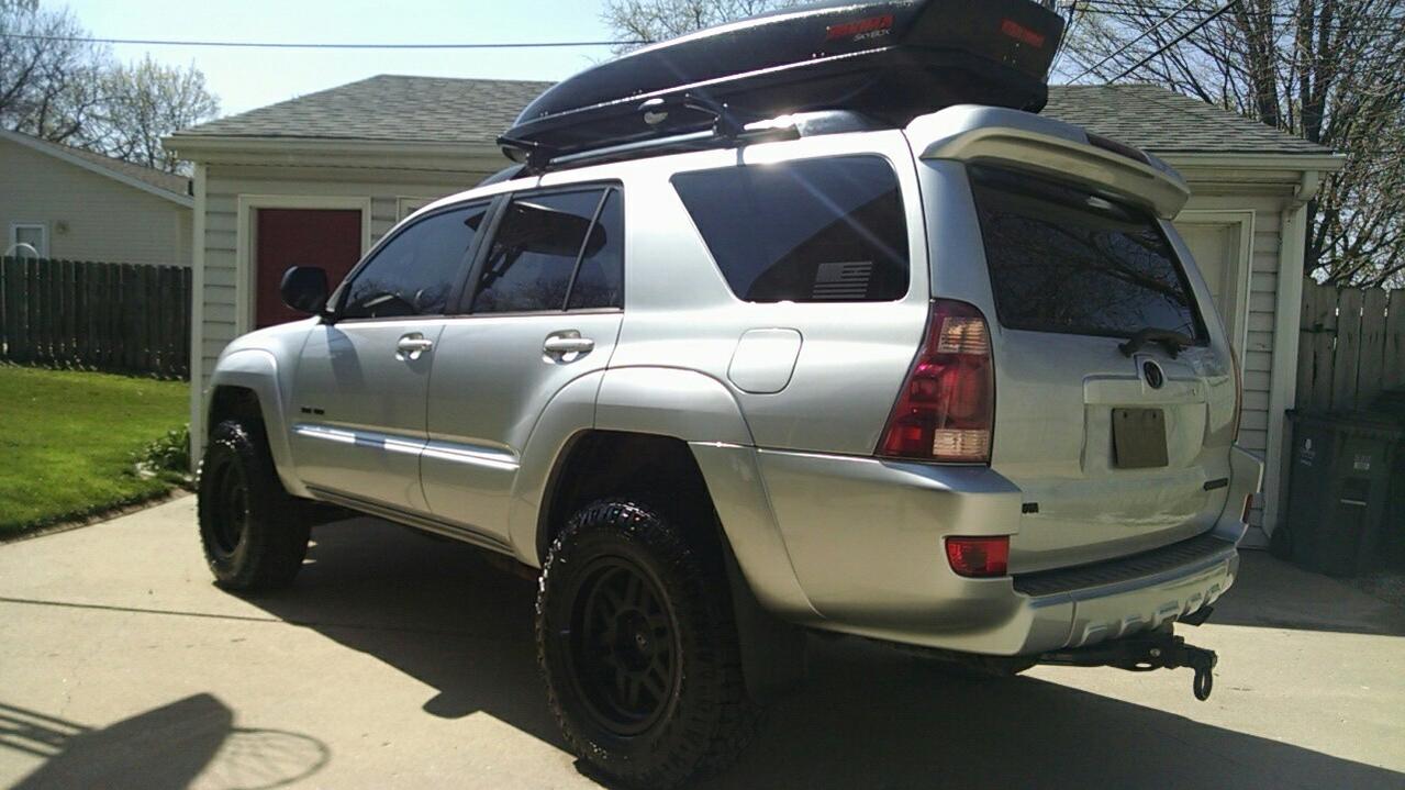

Here is my latest pic. Details in signature.
Wow, great looking rig, slvr. It looks nice and level with the spacers in the rear. Good to see someone else with the 2.5 Bilstein setting. I still don't know why I got such a high lift in the rear without using spacers (maybe because I used Moog FJ springs and not OEM FJ springs and they're not exactly the same), but mine without spacers and the 2.5 setting looks level. :wacko:
