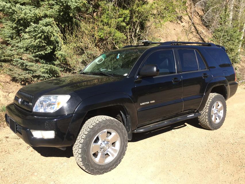

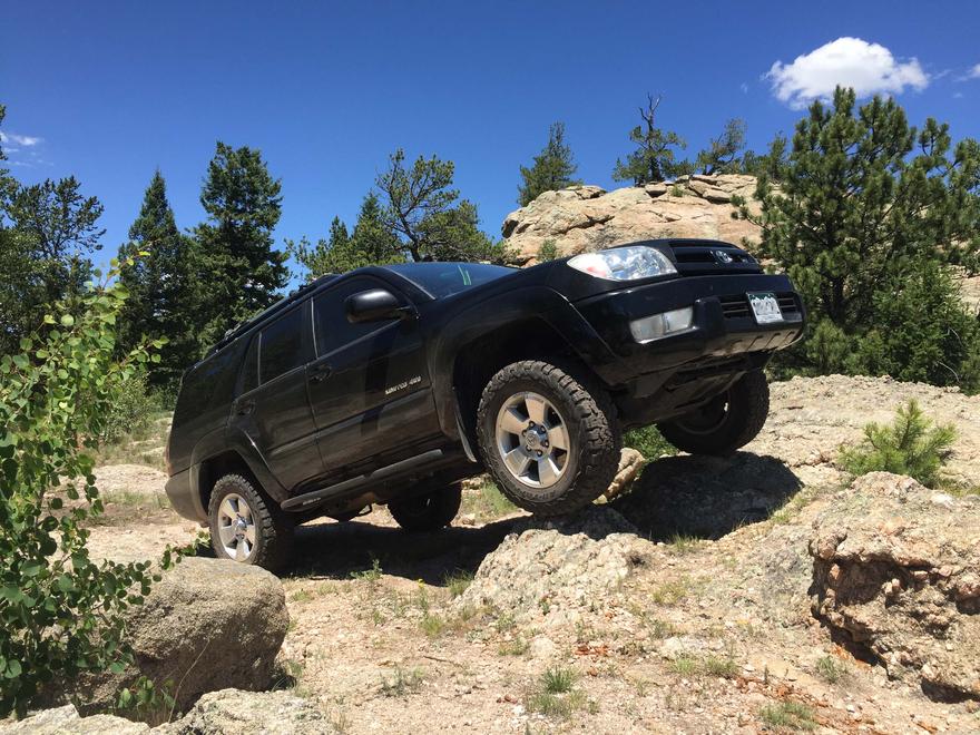

well here's how my lift turned out. Being a v8 it still has a slight rake to it. I'm more than happy with how it handles. 16mpg average... but who cares.
5100's set at 2.5, 07 FJ springs, 1.25" Spidertrax.
Looks great, what sliders are you running?
Agreed. What's the total lift? No spacer? I assumed a spacer was always needed in the rear to run the 5100's that high up front.
