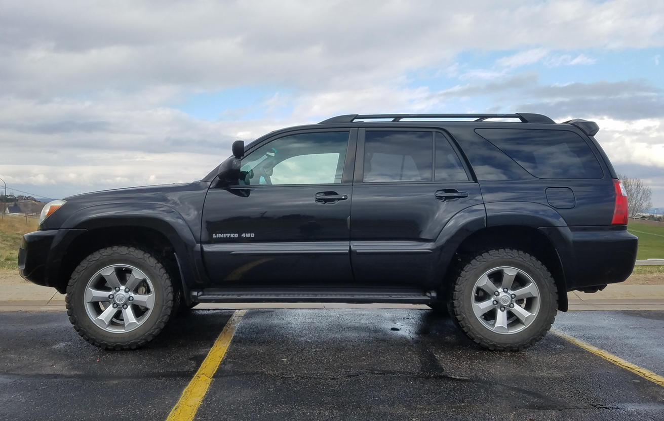

It goes into a little more detail and shows a picture of my set up after I installed everything. Also, I would highly recommend going to the bigger 265/70 tire as I did. You're going to all this trouble to lift (slightly) your truck, use the extra space and give yourself a touch more ground clearance with a bigger tire. Mine don't rub anywhere, fill out the wheel well and look good to boot!

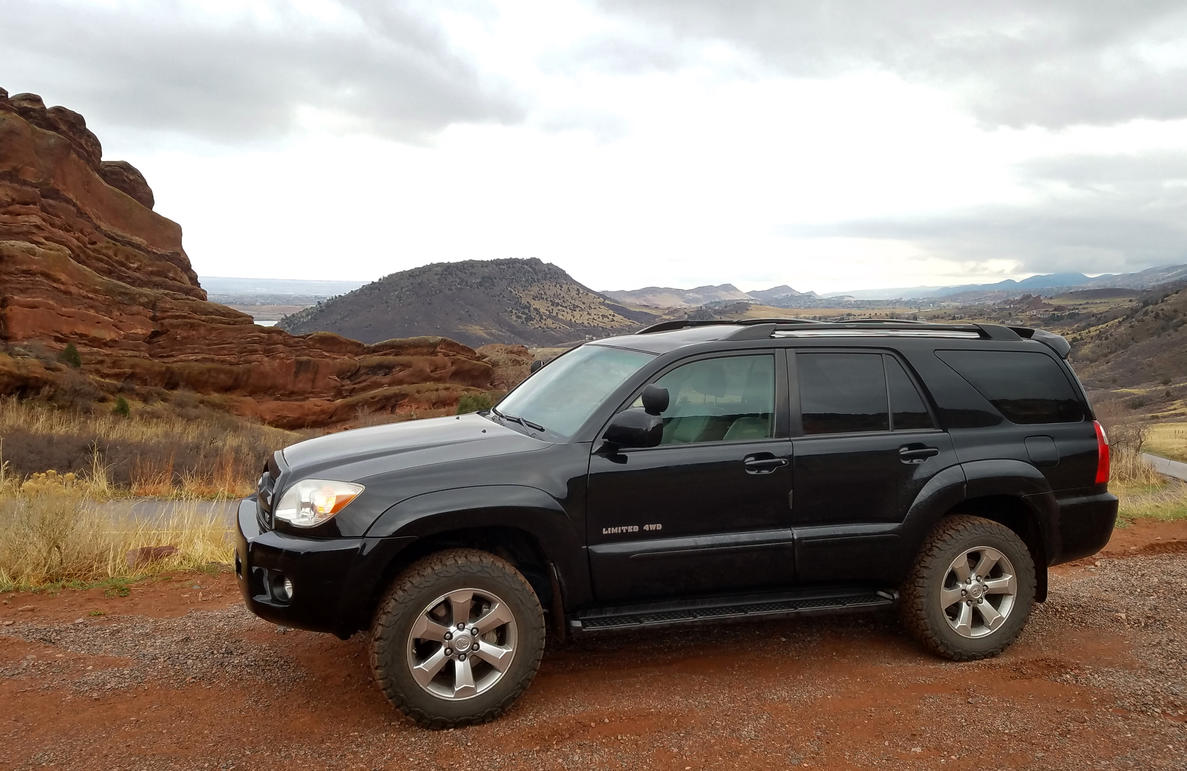

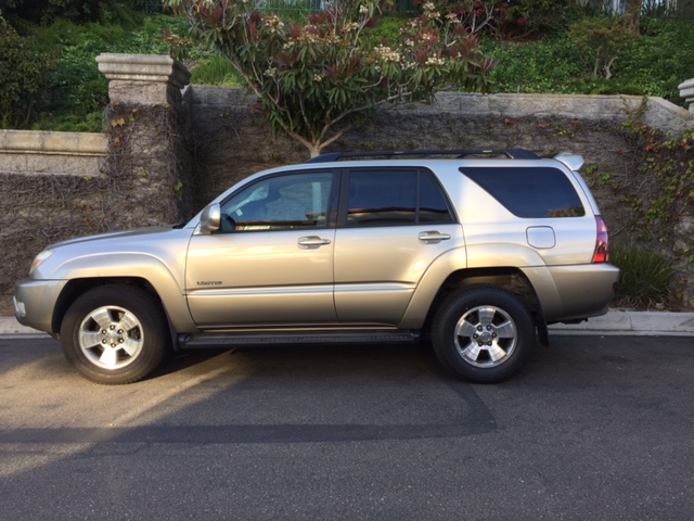

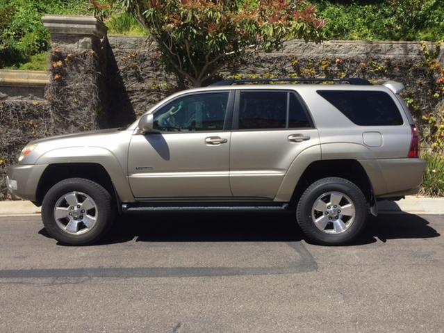

So I finished my install last weekend. Still need to get bigger tires and will do so as soon as these wear out a little more.
2005 4Runner Limited 2WD V8
Front: Bilstein 5100's @ 1.75", OEM FJ Springs
Rear: Bilstein 5100's, OEM FJ Springs, 1.5" Daystar FJ spacer
Tires: Bridgestone Dueler 840 265/65/17
Wheels: Stock Limited Wheels
Center of wheel to bottom of fender measurements:
Before:
Front: 18 3/8"
Rear: 21 3/8"
After:
Front: 22"
Rear: 23 3/8"
