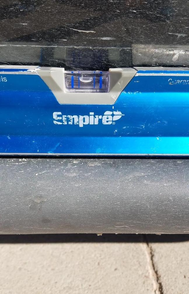

View attachment 251779I just had the 5100's (front @ 2.5") w/ FJC Moog coils done on my Sport V8, no spacers. Just put a level on the step rail and it has the slightest bit of reverse rake. I will reassess after I put new tread on it.
