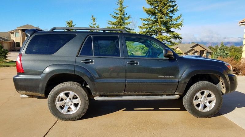

Got mine installed yesterday by a local shop. I went with the FJC (4WD) Moog coils and Bilstein 5100's, $447 for the coils and springs. The shop set the front at 2.5".

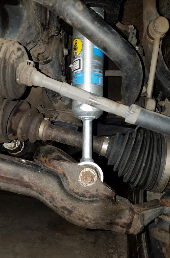

I recently installed 14 FJ Off-Road Bils and coils on my 07 SE. Too good of a price on CL to pass up. Requires grinding down a bit on the lower strut eyelet (fronts) and widening of the upper chassis mount (rear).
I hear the same is for 5th gen swap, but do confirm that.
TRD Taco's will fit too and provide a little more lift. Eyelet on the rear shock needs to be swapped out to a bigger ID bushing. Taco's run rear leaf spring(?), so no coil.

I had this exact problem recently. Exactly same front setup as you. What fixed it for me was tightening down the centre nut at the top of the front 5100's. I'm sure you know how much of a pain it is to do on this vehicle. I tightened to the point where it just wouldn't turn anymore. Next drive all sounds gone from the suspension. You got to make sure that rubber bushing under that nut is squished down good.
