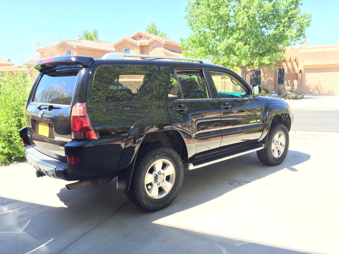

OK,here she is. 2003 V8 SR5, 146K. 2016 FJ coils and 5100's. Rear 1" coil spacer and front set to 1.75. New shoes also,2016 FJ TRD Trail Edition 17x7.5et15mm wheels and 255 75 17 Duratracs. Love it! Alignment next.Then a rack.

That looks pretty damn fantastic. Nicely done. I really like the TRD wheels and tire combo. My truck is black and I am seriously pondering putting out the cash for some matte black 4runner TRD wheels. I meant to put a pic in my earlier post so you could see the outcome, but forgot, so here goes.
Yours looks great as well! Im a big fan of OEM quality wheels, most people remove them and put black wheels on that arent as well built, heavier and not as well made. I looked and looked but couldnt find a better deal that the OEMs I picked up. Also black wheels are so common now,I wanted to be different.Dont forget to post pics when you get the TRDs.

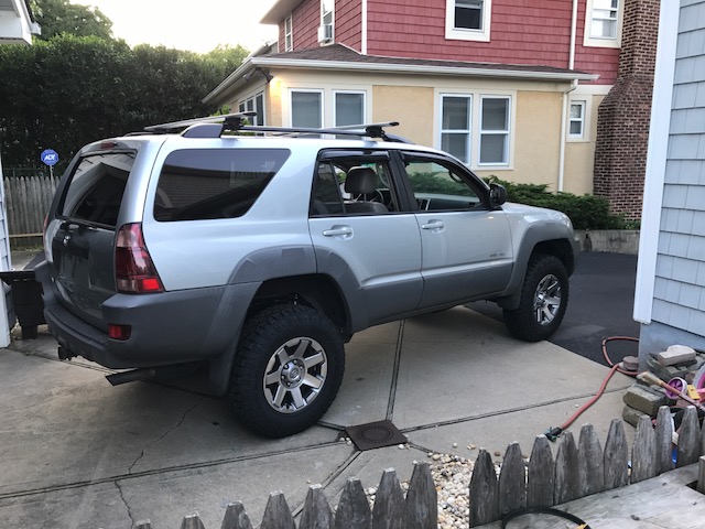

Here is a decent pic of mine after the 2.5 lift in the front and 1.5 DS spacer out back. And FJ cruiser 4x4 springs all around. I plastidipped my wheels black because they looked like shit when i got my truck. I cant afford new wheels right now =/. I am gona get darker tint on my windows, blacked out tails and smoked out headlights. And if things work out ill try and attempet MDX led jewel projector retrofit instead of the traditional HID projector retro. anyways my rig sits even as we speak with my 285/70/17s on its just a little raked looking because of the way my driveway is at my business.

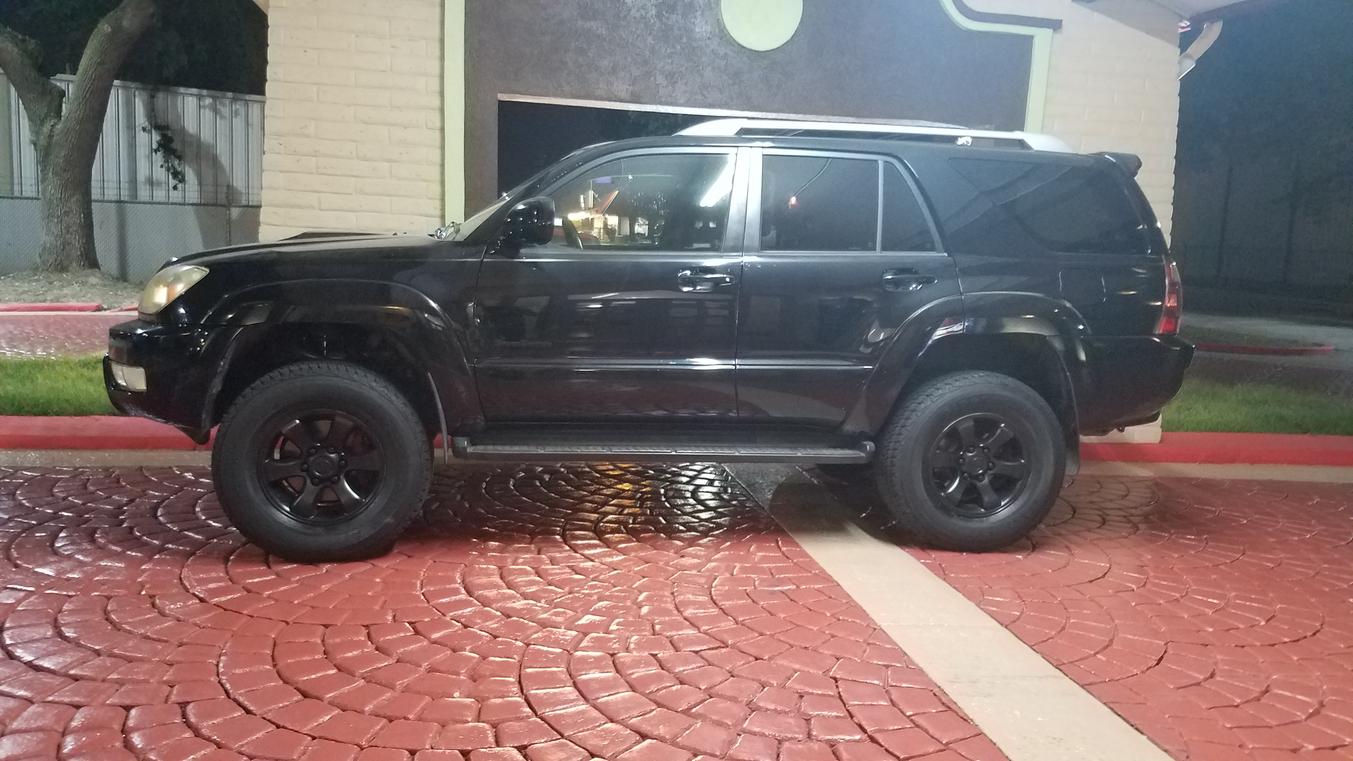

5100's set at .85 on the front, stock springs front and rear w 265/70/17 Nittos on TRD Pro Matte Grey wheels.
The roof line looks about right and the steps measure out pretty even but the front end still looks a touch low to me and I have about a 1.5" difference in height from the ground between the front and rear fender wells (center line of the wheels), plus the Nittos rub pretty good. I pushed the inner fenders forward which helped but was thinking about bumping up to the 3rd ring, still concerned that might be too much w the stock springs and no rear lift.....
Considering doing either a .25" or .5" ToyTec spacer on the front for just a little more.

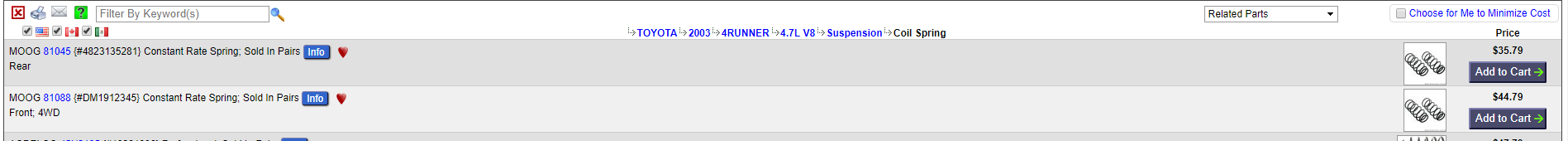

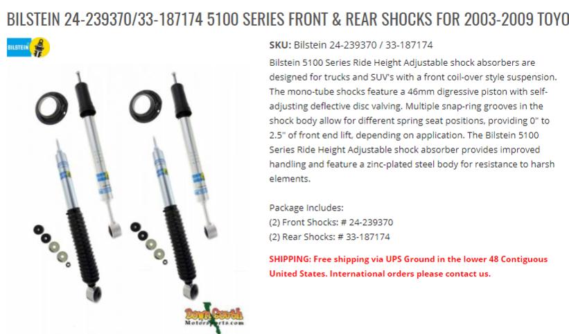

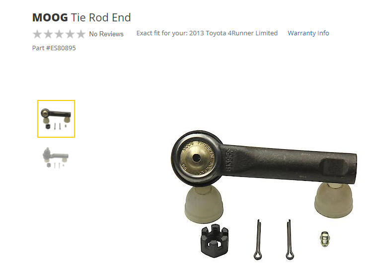

OK I'm apologizing in advance for the "explain it to me like I'm 5" nature of this post but here it goes... Dealership said I need new struts and of course quoted me an astronomical price. I'm mechanically inclined and have access to all the tools and patience (as well as a helper) I can need.
I have a 2003 Limited V8. Of course I have the X-REAS system and air suspension in the rear. I want to scrap the X-REAS system because my money tree out back hasn't bloomed yet.
Based off my research I THINK I want to go with the Bilstein 5100s all the way around and then replace the stock springs/air bags with Moog springs. I've attached photos of what I've got sitting in my shopping carts online. Have seen that I'll want to replace my tie rod ends due to the likelihood of damaging them in the process of swapping everything out. Am I missing anything?
