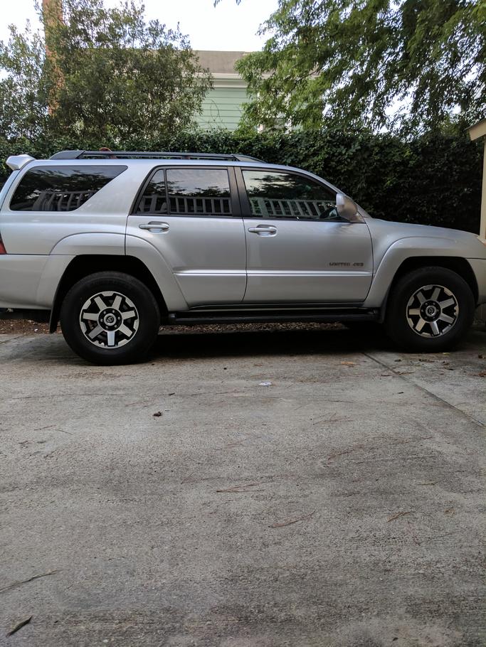

Got my bfg ko2 on, 275/70/17
Sits perfect now.
Bilstein 5100 all the way around, shocks set at 2.5 in the front- $358 on eBay
2012 Fj cruiser shocks with around 10k miles on them all the way around-$100 found on Craigslist
Origionally had the XREAS suspension on my 03 4Runner and wanted to get a beefy look so I swapped them with 5100s and FJ shocks and love how it turned out. Gained 2.5 in the front and 2.0 in the rear. Right now there is 265/65/17 on it but plan on getting 275/70/17 bfg ko2 this week. I'm stoked. Ride is great. First time poster here but long time reader. Stay tuned for more[emoji48]

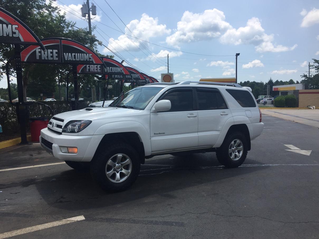

fj/5100 lift for 4runner limited 2005 V8

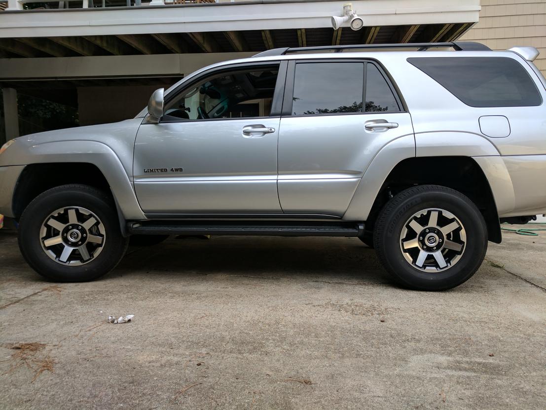

Just finished my lift with some help from a fellow member! Fj coils all around! Bilstein set at 2.5 in front and spacer in rear. Little bit of rake but I don't mind!

Those of you who have done Bilstein 5100's @ 2.5" in the front with Moog FJC's all around + a Daystar 1.5" spacer in the rear...
How are your alignment numbers?
Did you need an aftermarket UCA?
Pics?
I'm currently @ 1.75" with Moog FJCs all around. No rear spacer.

im doing that exact setup but front set to 2.5. i also went ahead and got me a camburg UCA with moog bj. they say anything 3" or more you will need to upgrade the UCA. but are you 4wd or 2wd?
well i went to go to my buddies place last night. he is the one doing the work for me and i got the suspension all done. front is set to 2.5 and the rear im using a 1.5 daystar spacer. i notice a slight reverse rake. in the future if i want to put a taller spring the the rear without the spacer which ones would you guys recommend
Good to know. I'll have to debate whether I will go the 3"+ lift by going to the 2.5" setting... I'm 4wd..
someone suggest OME rear 2" heavy duty springs if you do a 2.5 lift in the front. Just so you wont experience the rake. but im hoping my front settles in given im v8. Do you have a diff drop and sway bar relocate kit with your lifT?
Good to know. I might just opt to keep mine where its at then, unless I find a good reason to get a lift + tires again.
I dont have a diff drop and swaybar relocation kit.

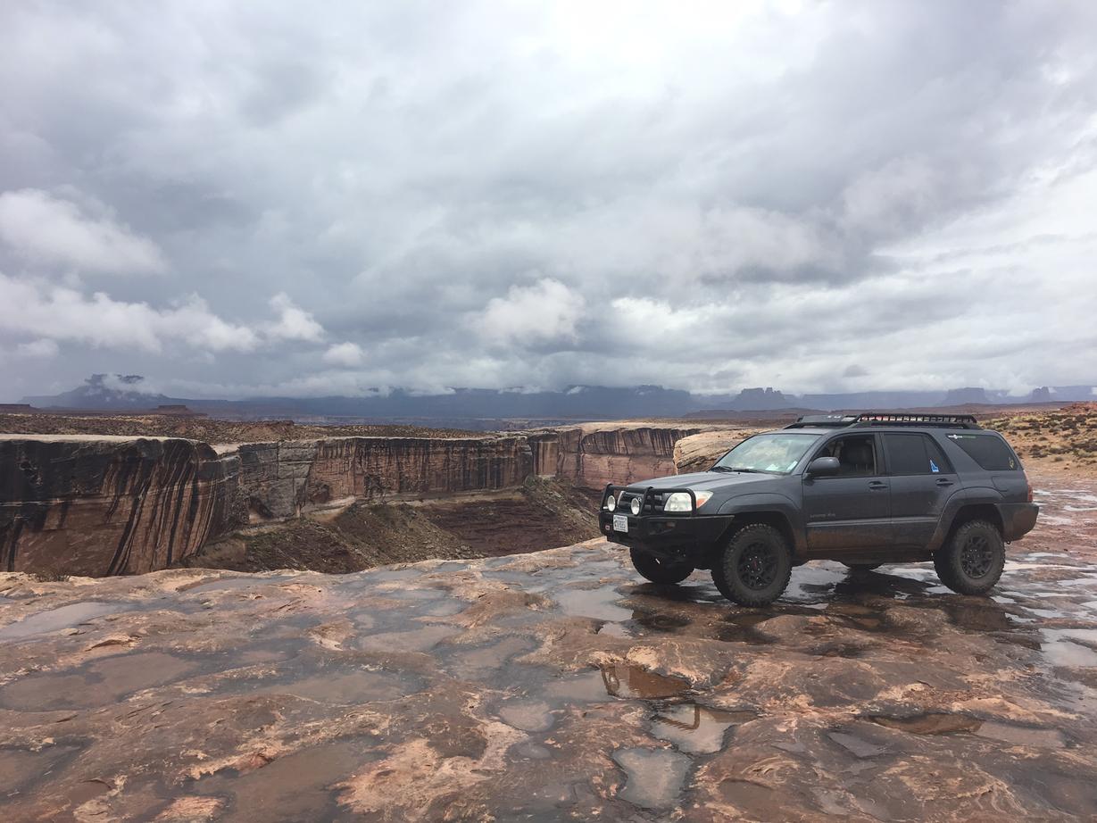

New to the forum, looking for a little advice. I've got a 2005 limited V6, currently running a daystar 2.5/1.5 on stock suspension. I'm going to replace it with bilstein 5100s that came off a 2014 4runner with 15k. The front struts are assembled, so I'm going to use the springs off the newer 4runner with the new front struts. I'm going to replace the rear shocks, but leave the stock springs with the 1.5" spacer.
Here's the kicker, I just installed an ARB bull bar, so I've got extra weight up front. Do you guys think I should run the front struts at 1.75 or 2.5"? From the sound of it I will get a bit of lift just out of running the newer front springs.
I don't have a winch right now, but may get one at some point in the future.
Other factor to make it complicated: the truck has 207k so I imagine the rear springs are a little tired.
Here's a pic of how she sits right now, just for kicks
My understanding is that simply raising the strut to account for the extra weight could be seen as cutting corners. Ideally, I think you would go with a heavier spring to maintain drive quality.
Don't the 5th gen 4runners have a heavier spring rate than the 4th gen? Either way I think an OEM spring with 15k will handle better than an OEM with 207k haha
mmm i'm not sure...I was kinda under the impression that they werent too much different but I could easily be remembering wrong. Id definitely agree that a new spring will feel great either way.
