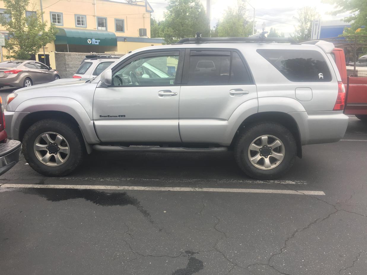

Like the title says. Just got the car back from the shop with 5100 (.85) on the front and 5160 in the rear with used fj coils all around(with 20kish miles)
I got the work done at Mikes Custom Toys in grants pass for 400 bucks. Mikes is loosely affiliated with wheelers.
I forgot to take measurements prior to the work but currently it's sitting at:
FL- 35 1/8th-2/8th
FR- 35 5/8
RR- 36 3/8th - 4/8th
LR- 36 3/8

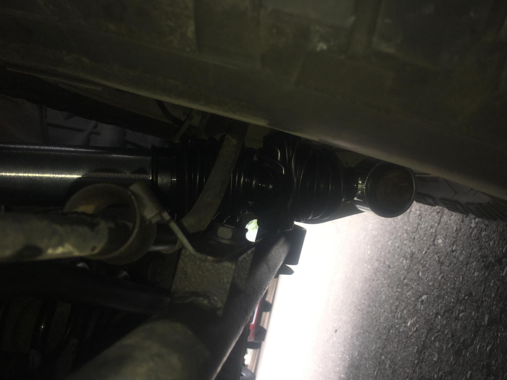

First thing I noticed when looking under the car was how the covers on the rear shocks were all scrunched up....kinda funny but I assume it doesn't matter? Unless they pinch on something maybe?

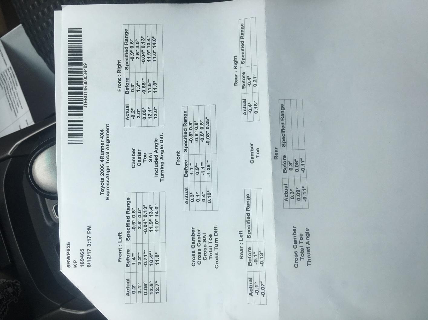

Here's how it aligned....these numbers mean nothing to me but mike said it was all good.

Like the title says. Just got the car back from the shop with 5100 (.85) on the front and 5160 in the rear with used fj could (
Like an excited child on Christmas Eve I forgot to take measurements prior to the work but currently it's sitting at:
FL- 35 1/8th-2/8th
FR- 35 5/8
LR- 36 3/8

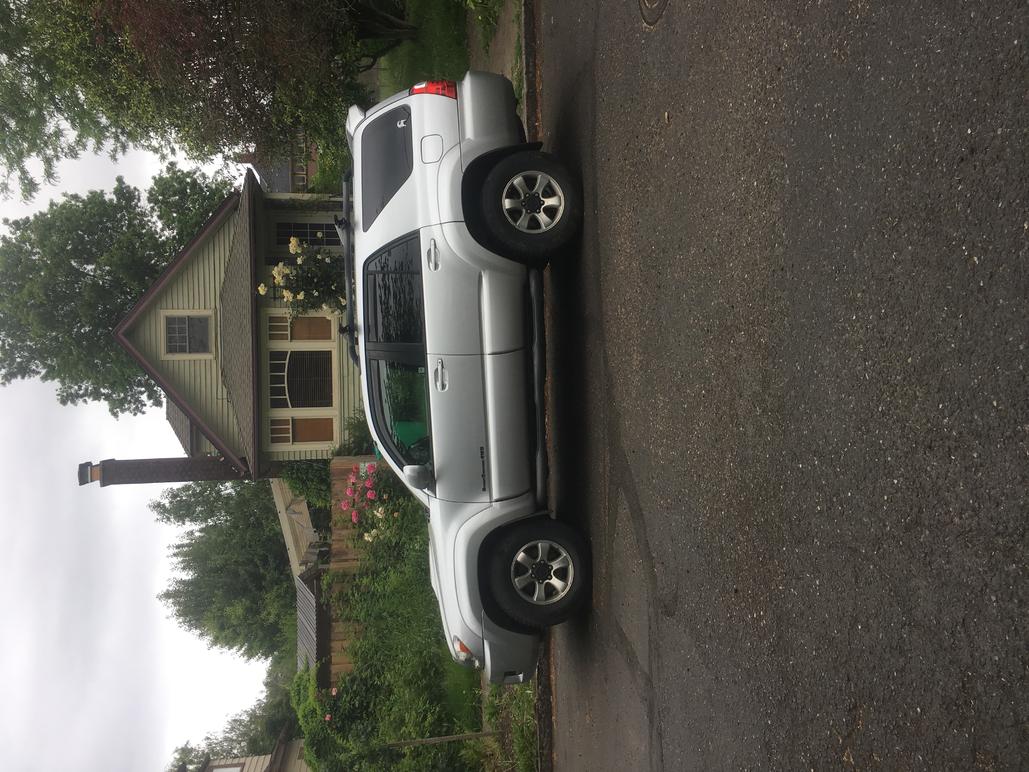

Before: View attachment 255750
After:View attachment 255751
That turned out very well...
Looks weird, like the dust boot is either torn in half or there are 2 boots on it.
Yeah, I'm super stoked on how it turned out! Looks and feels great...this is how it should have come off the lot. as far as the shock sleeve I think it just needs to be straightened out but I havnt messed with it yet.
Can anybody confirm that those alignment numbers are decent?

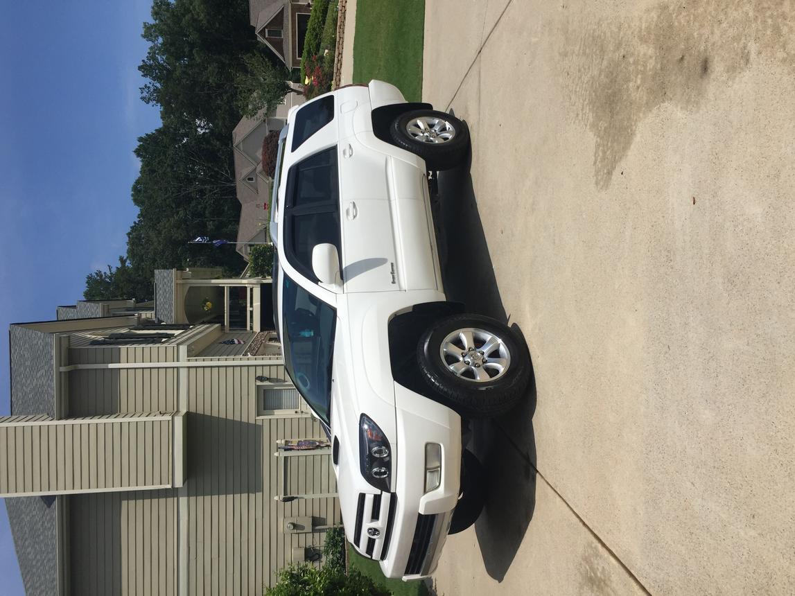

Finally finished up my suspension
06 v6 4wd
Moog FJ springs all around
Bilstein 5100s all around with the front set to 1.75''
I'm still undecided if I wanna add the rear daystar spacer. I'll see how it settles out after some miles.
19554036_10155358287181760_2727931669156639883_n.jpg~original
