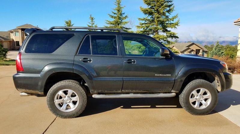

Just did FJ coils on mine.
2004 limited V6, 4wd with 120k miles.
I used 2008 FJ Trail Team coils and shocks all around, got rid of all XREAS. They reportedly had about 50k miles on them. Also added the Daystar 2.5" spacer lift, KT09115BK. Tires are Falken Wildpeak A/T3W, 265/70-18. They are on a 9" wheel that had a little less backspacing than stock. I took off the front mud flaps and also trimmed the inner fender up front to stop some rubbing. The ride is stiffer but not harsh. Corners a lot flatter with minimal body roll. I really like it better than before.
Before:
Center of hub to wheel well opening; RR 21.25", LR 20.75", RF 18.25", LF 18.25"; ground to bottom of front lic plate 19", ground to bottom of center of running boards 11" both sides.
After:
Center of hub to wheel well opening RR 23", LR 23", RF 22.25", LF 22"; ground to bottom of front lic plate 24.75", ground to bottom of center of running boards 15.5" both sides.
I gained about 4" front and 2" ish rear from the springs and spacers and another 1.5" from the tire difference.

Pretty nice, can you tell us about those wheels?

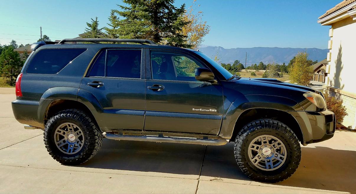

Finally got new tread to finish off the lifted transformation. I did the 5100's set at 2.5" and Moog FJC coils this past spring. GY Duratracs 285/70/17 fit w/ a little trimming! Next is some new UCA's, probably JBA's.
