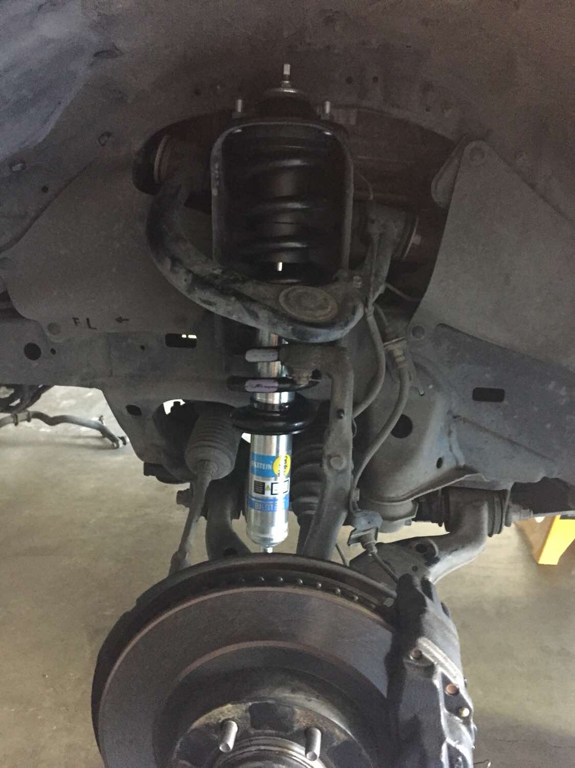

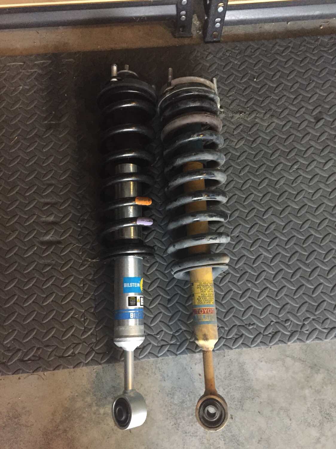

I completed the front install of my 1.5" StreetRays Spacers and 2013 FJ Springs with matching Bilsteins. I expected to get about 2.5" total but sure seems higher than that lol. I didn't take BEFORE pics so I have to comparison but I'll edit later with AFTER numbers.
Tomorrow I'll be finishing up the rear with Bilsteins and FJ Springs with Daystar 1.5
Well instead of drilling out the upper shock mounts, I did use the 4runner washer and the FJ rubber bushings by pulling them apart. I know someone else explained doing that, however they said they used a chisel and a vise. I had neither, so I used pliers and a heat gun. Worked like a charm. Bushing jumped off washer when it got hot.

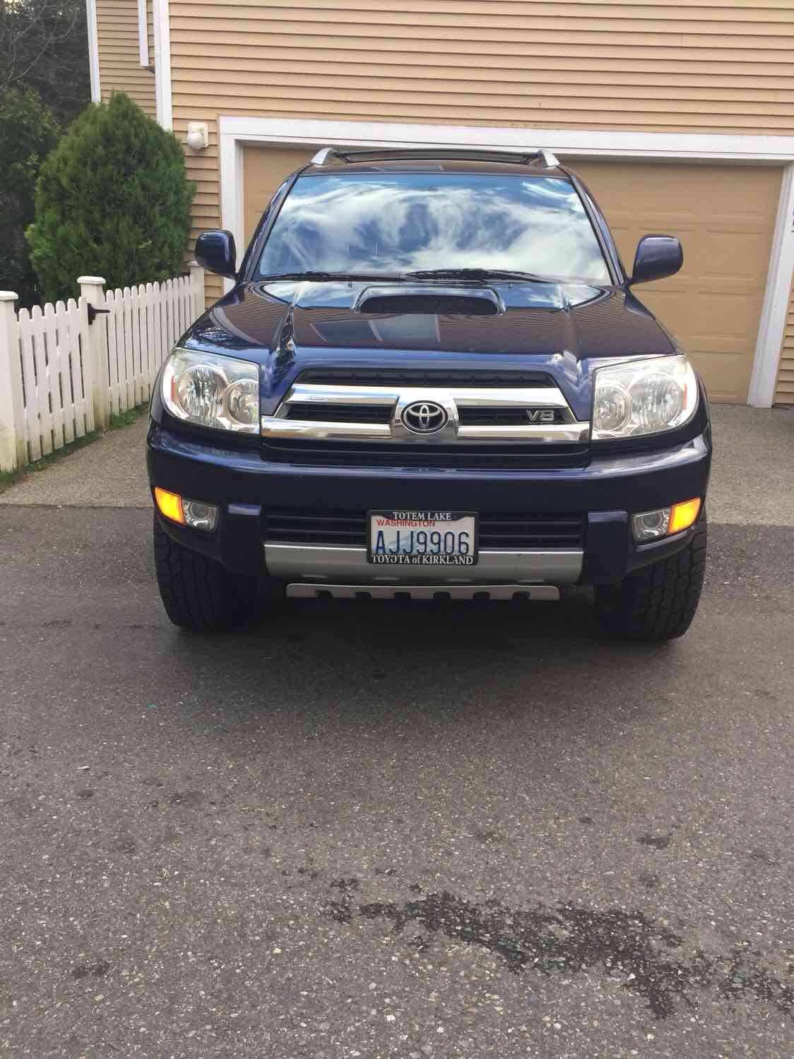

I promised photos after my install.
I did 5100s all around with 2010 FJ springs. I only have a couple photos from before but I'll post them up as well
It is sitting perfectly level on all 4 corners now

Looks great. Still looks like a few inches of rake there, which I like. Can you say anything about the ride?
It rides amazing! Far better that stock in my opinion. Front clip is at .85. No spacers. And it definitely eats up the road better in my opinion

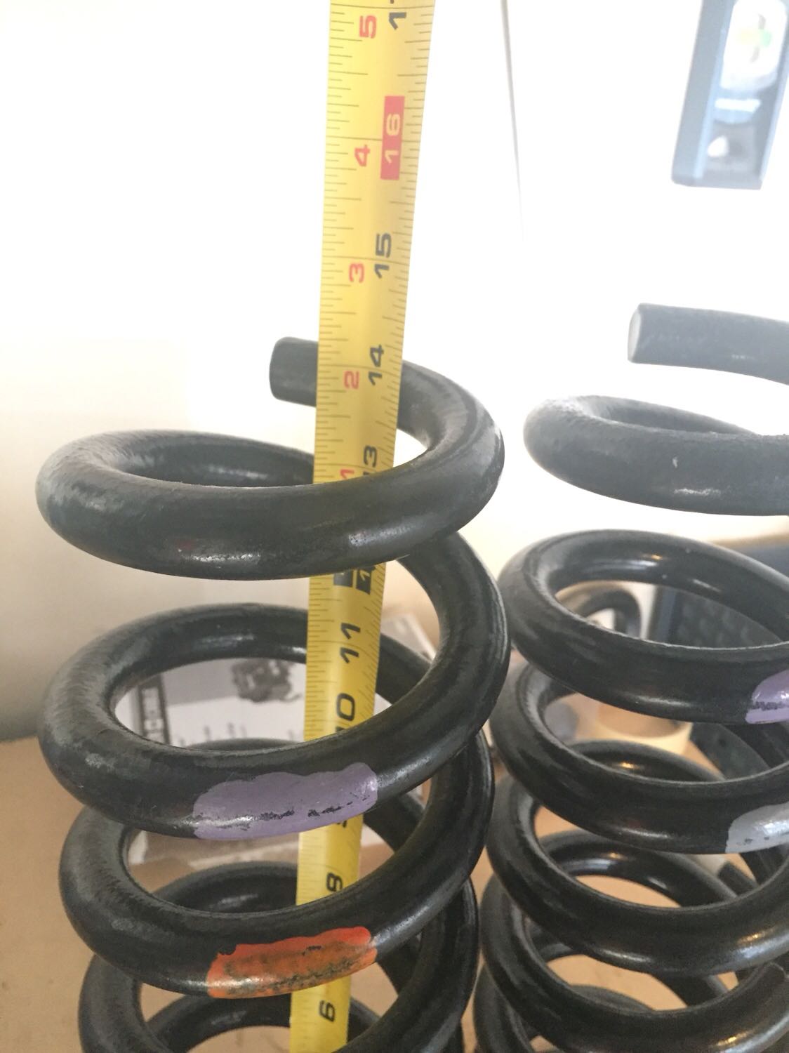

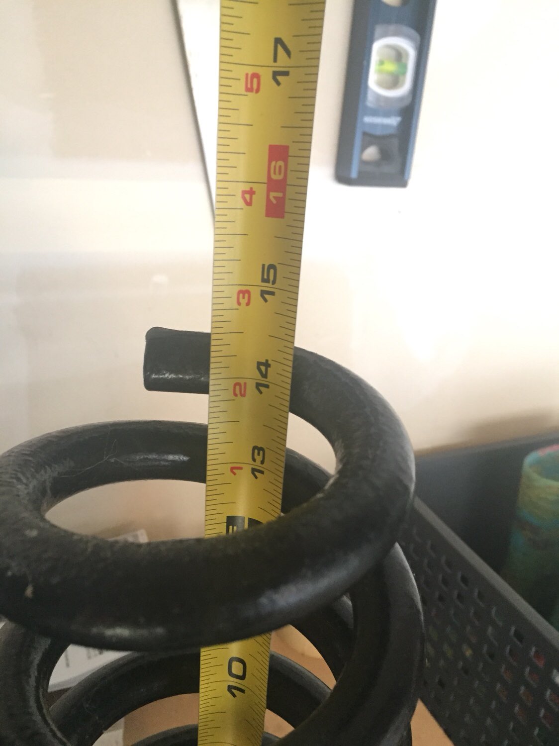

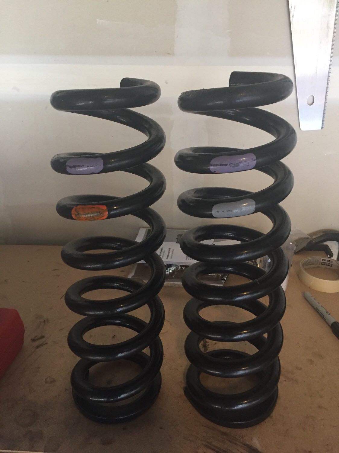

Just installed some 2012 FJ 4x4 springs (take offs, so basically brand new) with some Bilstein 5100s on the 3rd perch (1.75”). Took a measurement and they were taller than what I’ve seen posted. 14.25” on the driver side and 14” on the passenger side.
Was planning on getting about 2.5” out of it, but ended up at 3” pretty dead on (36.5” from ground to fender). I have 265/70/17 so I have about 1/2” from those.
Very pleased with the ride quality, not harsh as I’ve heard some complain. I use to have an Audi A4 with H&R coil overs and 18” BBS wheels so I’m well aquatinted with stiff/harsh rises and this is no where near that. It’s barely stiffer than the Taco TRD Off Road springs, but the dampening from 5100s is a much needed relief from the float. Can feel small bumps a bit more as the springs aren’t progressive like the Tacos.
