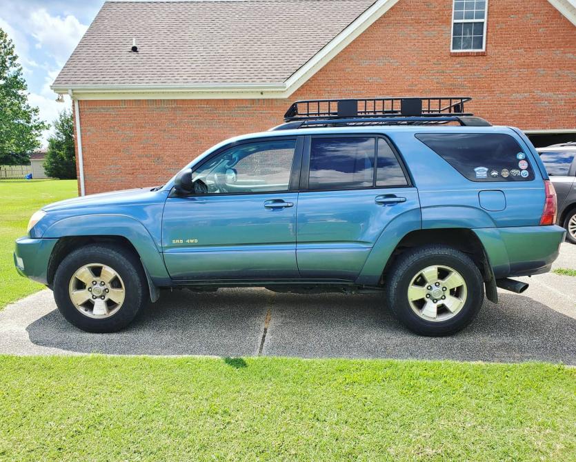

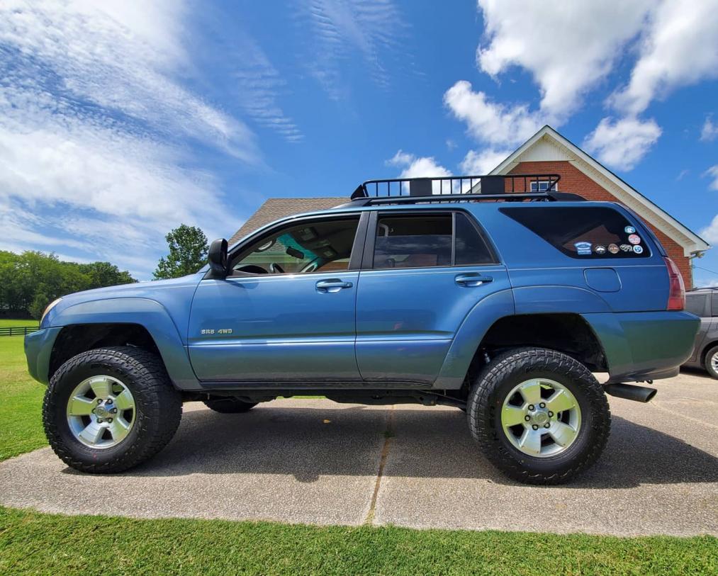

Posted this in the Lift Pics thread as well, but since this thread was probably the most helpful, I wanted to post here too. After reading for hours on this site, my dad, son, and I spent a long Saturday putting 5100's, FJ Springs, a Daystar rear lift, new UCAs, 1.25 in wheel spacers, and 285's on the 2004 Sr5 I bought last year. I'm loving it!! Thanks so much to everyone who posted their stuff on here. Couldn't possibly have done it without this forum.

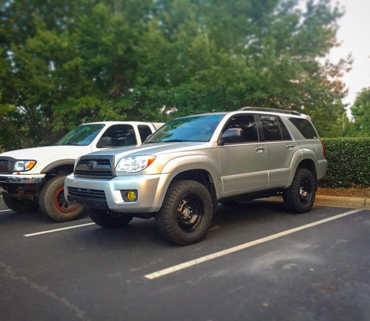

FJ Offroad Package, coils and shocks plus 2012 FJ Wheels. Then 255/75/17
Looks great! What year was the FJ? The off-road package shocks are Bilstens and look like 5100s (maybe there are) right? Was this a direct bolt on or did you need to modify anything? Thanks!
