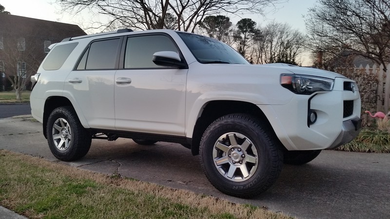

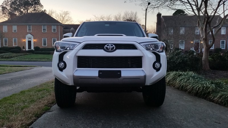

Cornfed 1" front spacer to level only...
So many threads were helpful when I was trying to figure out my lift, I thought it might help to see another pic with a lift option. This has the 1" front and a custom 0.5" rear Cornfed spacer lift with 275/70/17 Cooper AT3. Easy lift, installed by Mr. Cornfed himself in his Virginia shop. I got to watch him make my custom rear spacers on the spot after I told him my OCD couldn't handle the 0.5 inch rear frame droop,with just the front in place.
What are you wheel hub to fender measurements with the spacers. Looks perfect

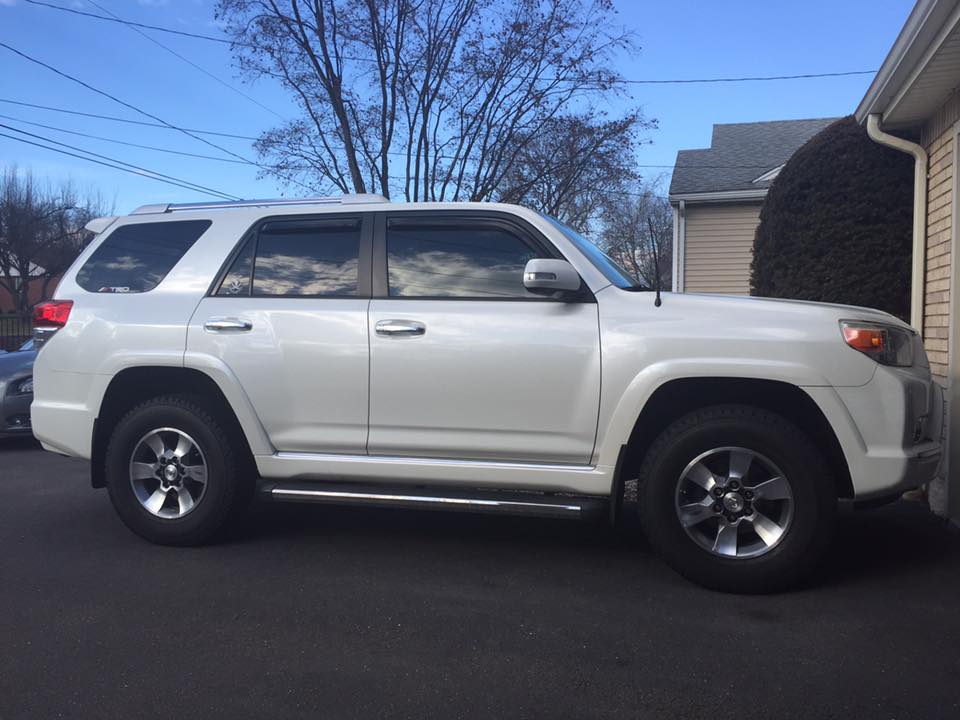

Had my 1" Cornfed spacers installed today on my 2012 Limited, and either I'm completely crazy, or bumped my head, but my truck runs better than stock. It actually runs smoother on the road, and especially on the fwy. I can't believe it.
All I did was have the spacer installed in the front. Am I nuts, or do these spacers make the ride better?
Please note my LE is a 2 wheel drive, not 4 wheel.
Hello [MENTION=134511]Navydivedoc[/MENTION] & [MENTION=90499]mx355[/MENTION],
Is that pic showing ONLY the Cornfed spacer being used to lift or is there something else lifting it? If that's ONLY the spacer that's very good!
Did you get those measurements?
Mine is 37" rear & 35" front, stock.
love it...I am old school and would welcome a slight lift in the front. I purchased the cornfed spacers and have not installed as of yet and am encouraged by how they not only leveled but gave a slight front lift.
Great looking truck.
