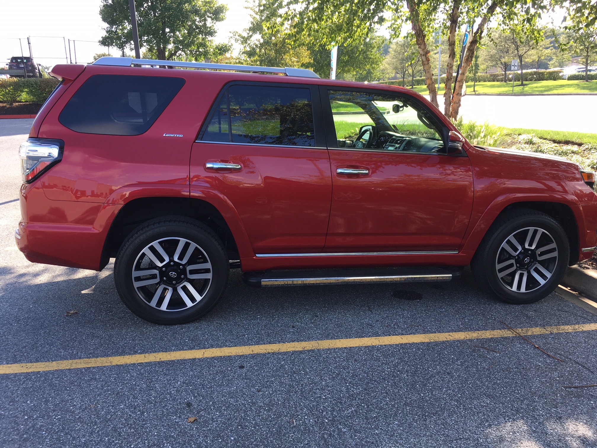

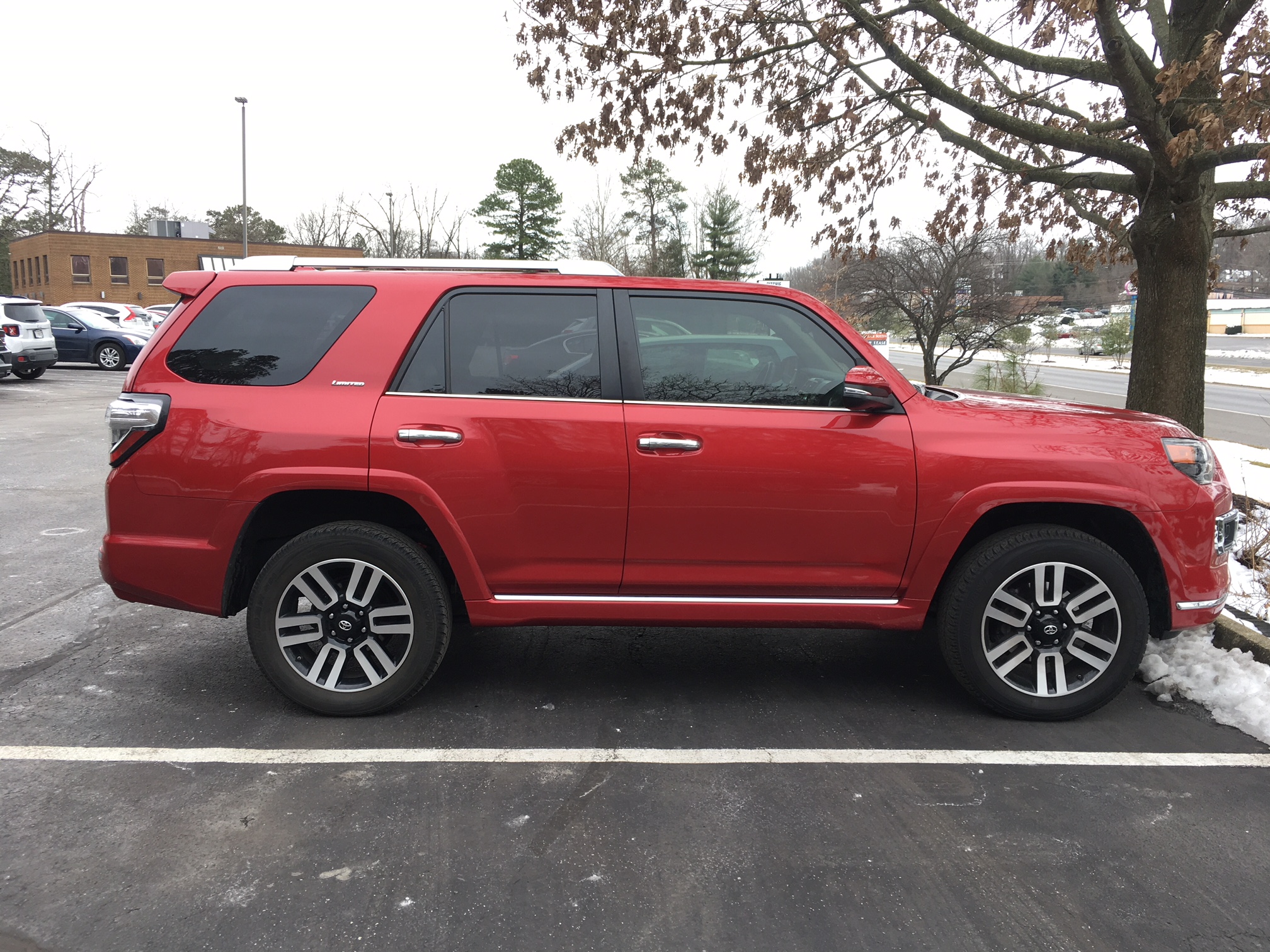

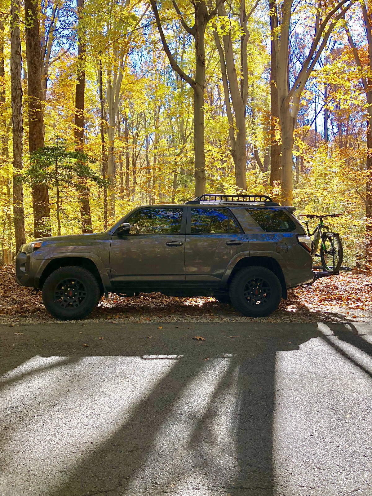

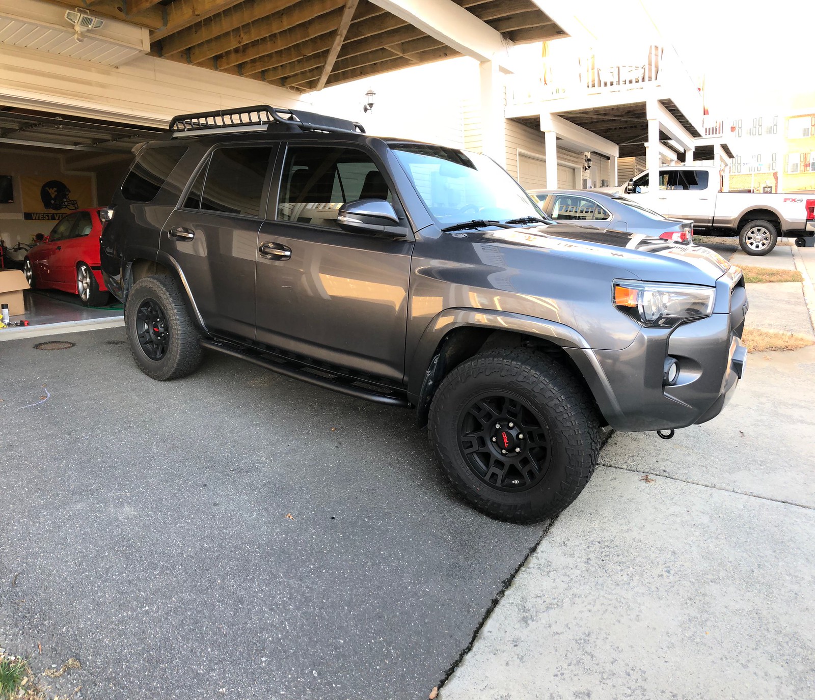

Here are before and after pics - not quite apples-to-apples since it's a different location and angle. There is stil some rake, but it's reduced. Somehow, the driving position just feels better now.
Also, I obviously removed the OEM running boards so now I actually have some ground clearance.
Before:
After:

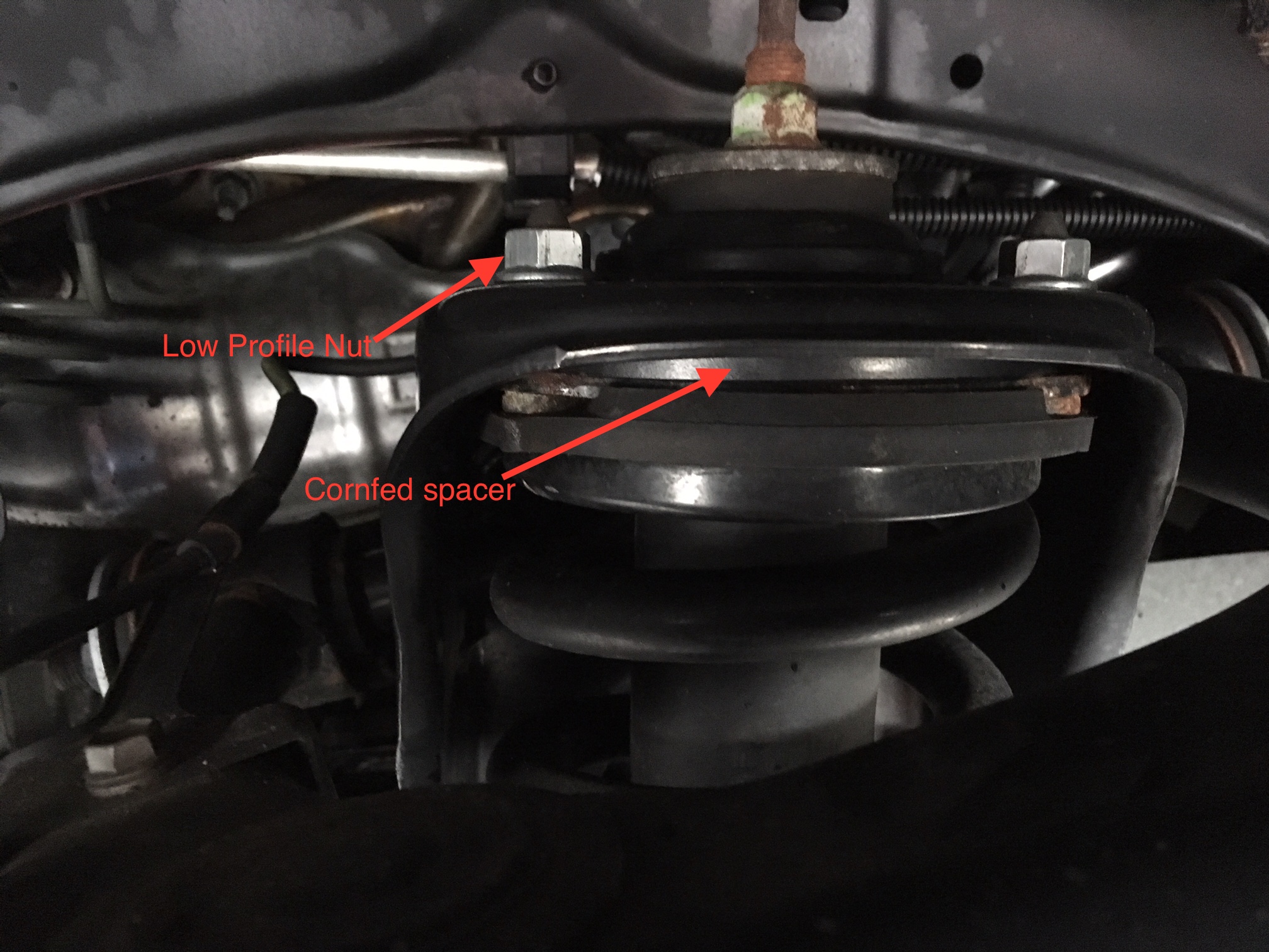

Yep. 6 nuts, 2 spacers, instruction sheet, and a sticker.
Here's a shot of the spacer installed using the low profile nuts. Looks like any thicker and the nuts wouldn't fully thread onto the OEM studs.

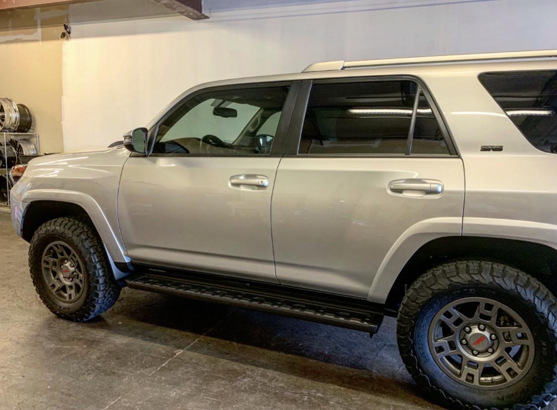

Got the cornfed 1” spacer installed to the front. Subtle but noticeable. Thank you guys for the info and David from Cornfed was fast with everything from replying to shipping!

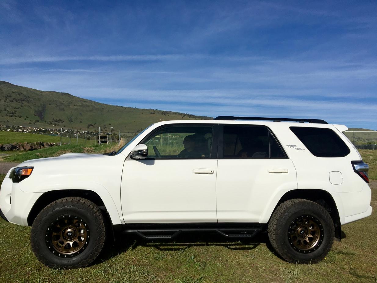

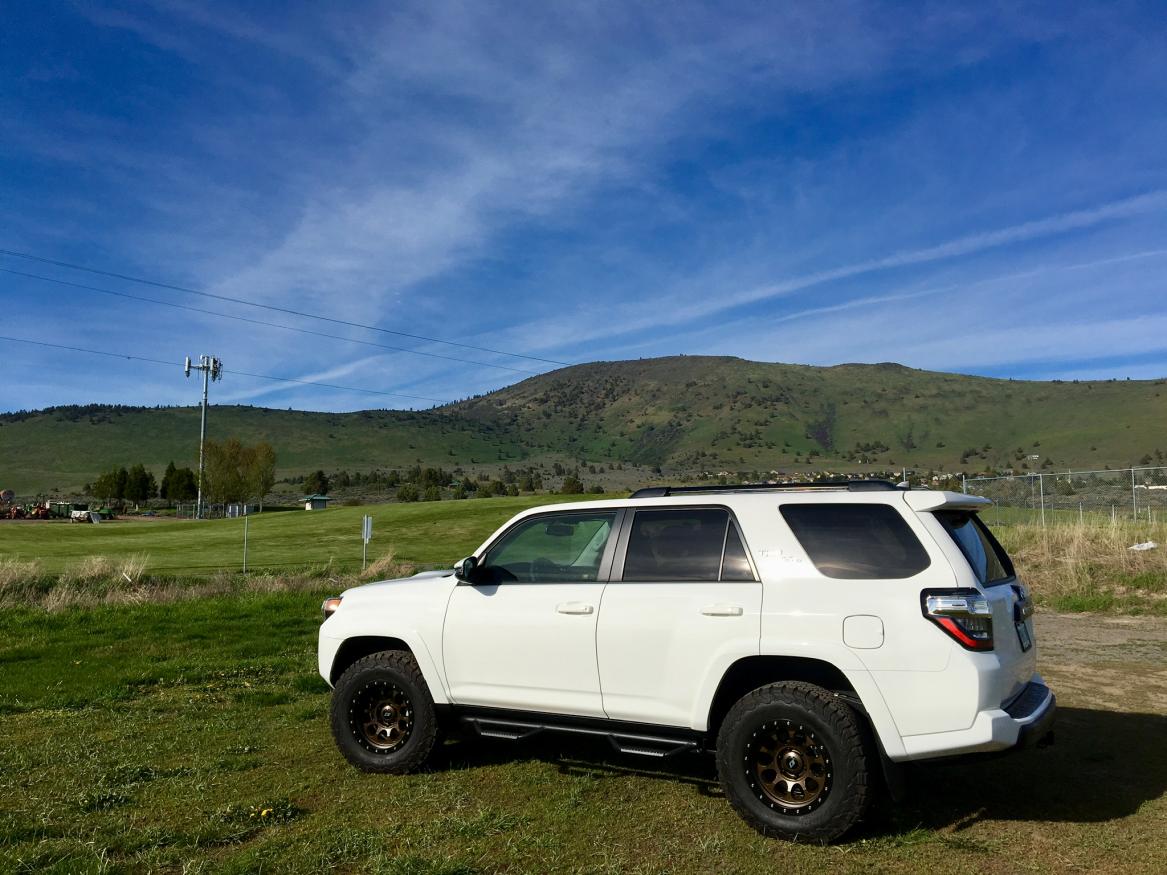

After reading through this thread multiple times, I decided to give the 1” lift from cornfed suspension a try and I’m very glad I did. The lift is quite subtle, but to me makes a big difference in the appearance. We also mounted Stealth Custom Ray 10’s at the same time. Tires are 265/70/17 KO2’s.
