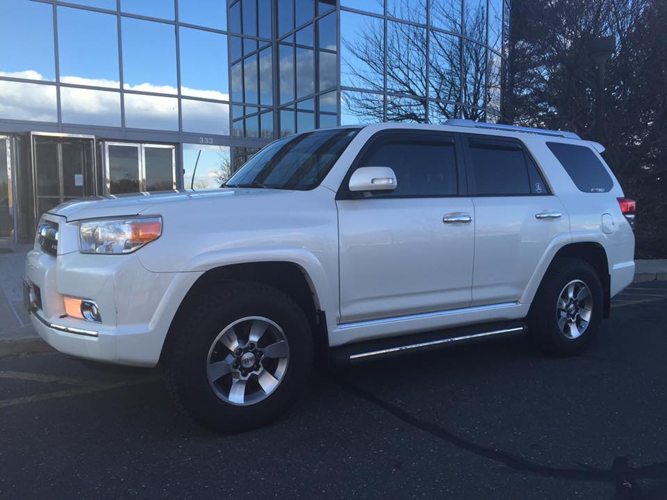

Can you run 285x70x17 tires on 17x9 wheels with the above setup ?
I currently have a 2 inch lift and zero problems( no rubbing, no BMC) , but frankly, I'd probably prefer to have ony the front lifted to level it.
Perfect - The stock wheels & Tires are my winter set up. In the summer I run 18 x 8 1/2" wheels with 265/65/18 tire.

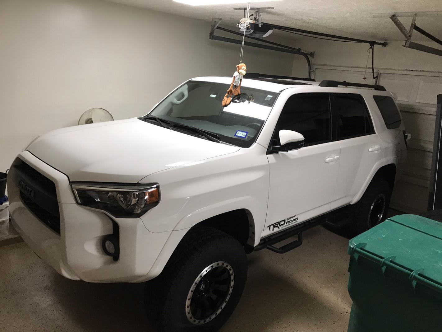

Just had my 2/1 spacer lift installed. Rides like stock.

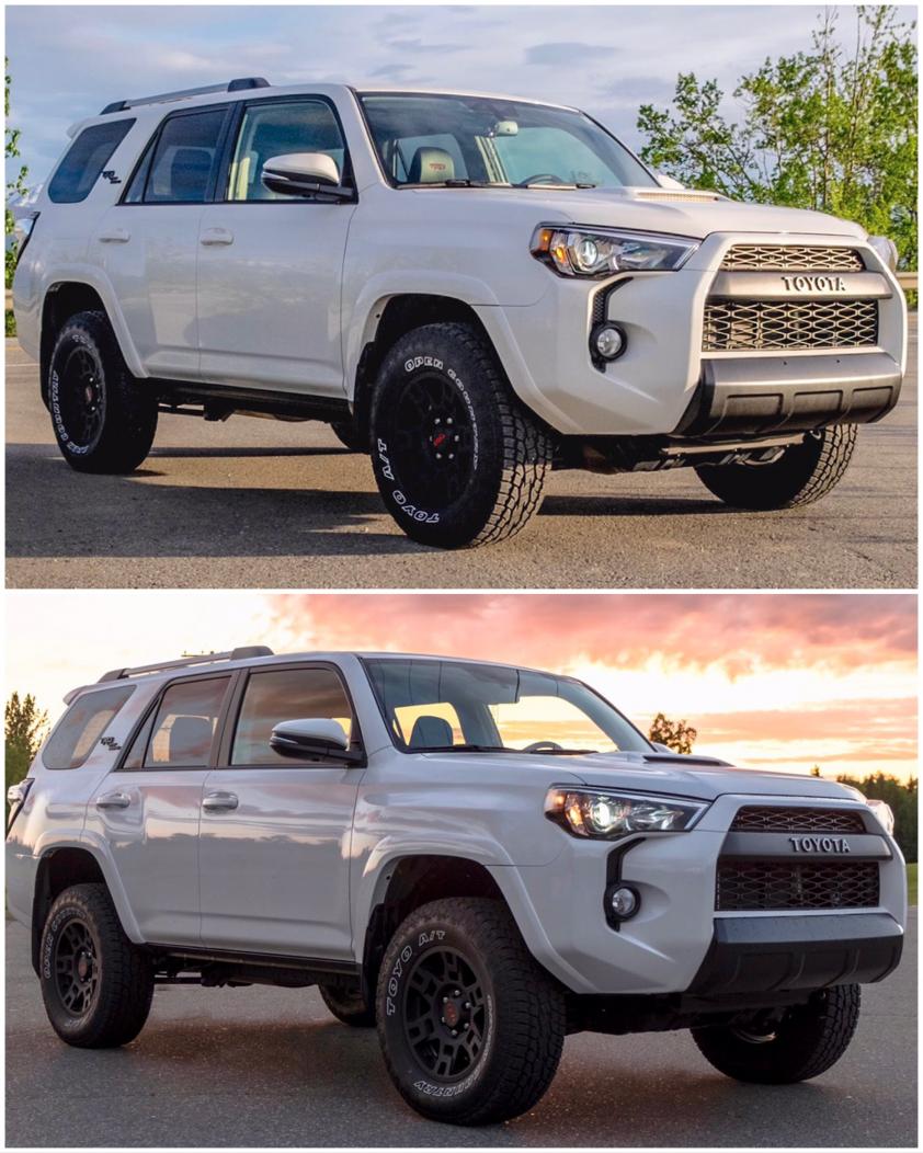

After reading through this thread multiple times, I decided to give the 1” lift from cornfed suspension a try and I’m very glad I did. The lift is quite subtle, but to me makes a big difference in the appearance. We also mounted Stealth Custom Ray 10’s at the same time. Tires are 265/70/17 KO2’s.
Do you have KDSS? really like your lift, nothing crazy
