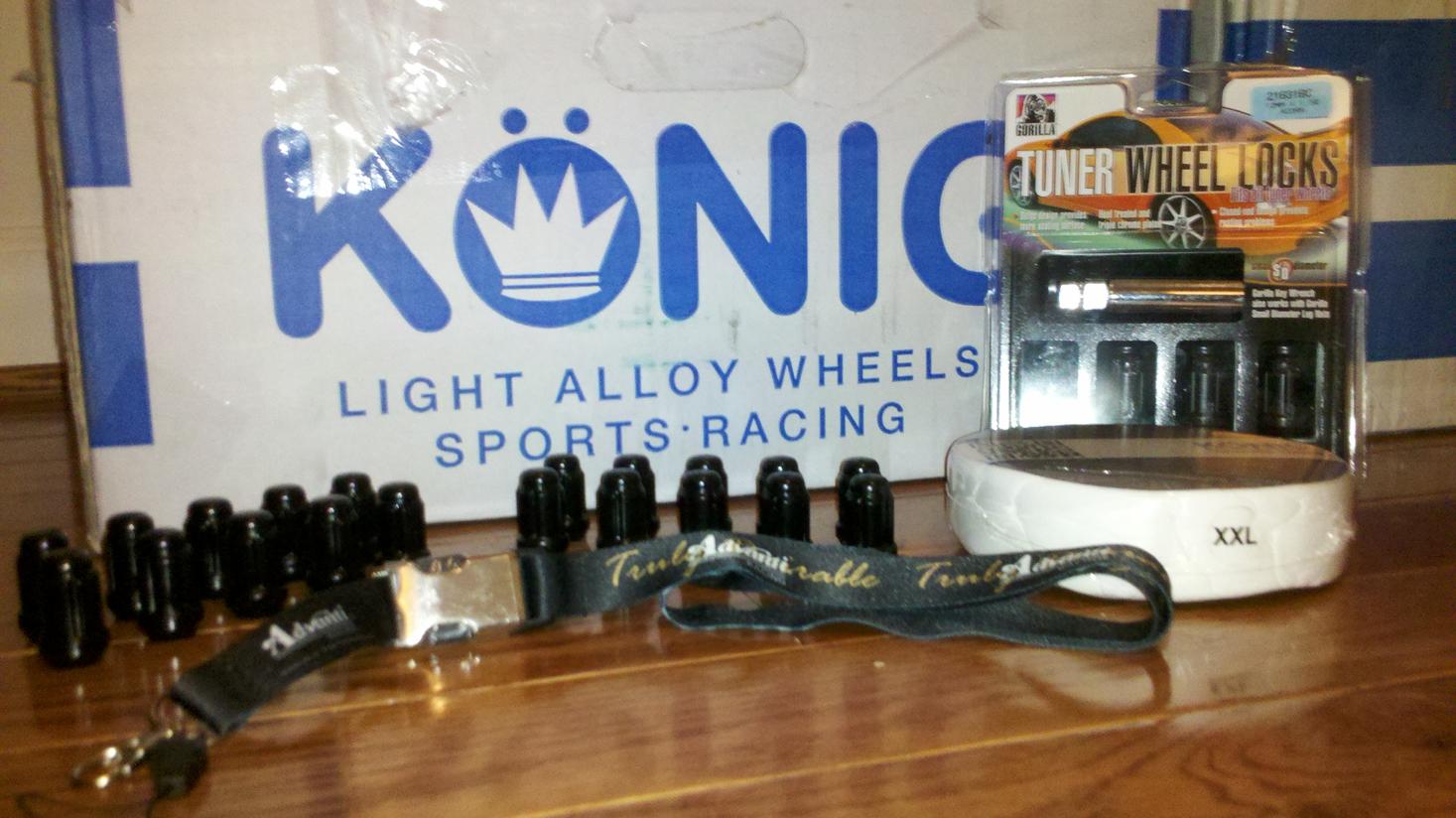

You did buy new conical seat lugs nuts as the oem ones will NOT work.
This is all the stuff that came with the rims.
Small diamiter acorn nutz and locks.
Yes , those are the right lug nuts.

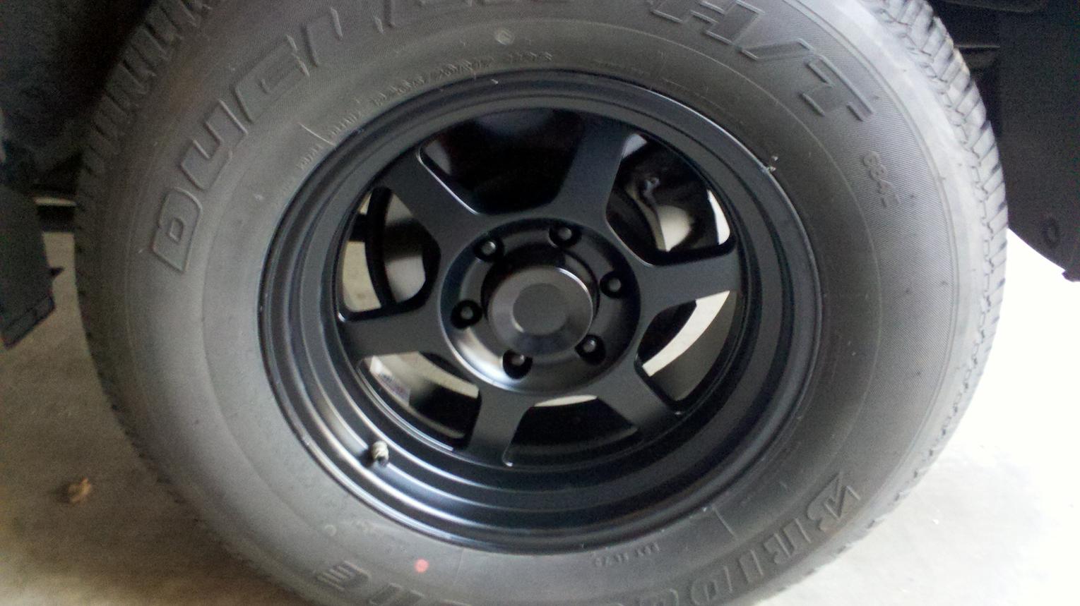

The custom ones he gave me are nice (better then the konig ones) but if it comes down to caps and bad balance or running over my center caps and having a ring with a great balance, i will crush them all day long :(
