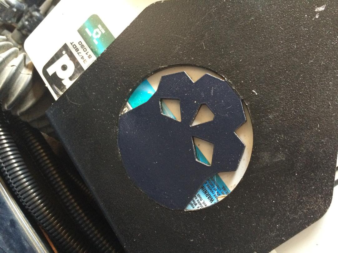

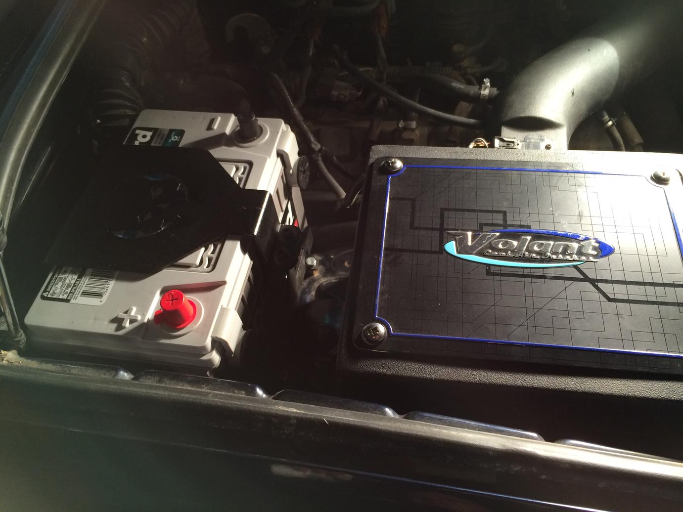

I also got my 2nd battery mounted and modified Volant cool air intake installed
I think it's about time for me to do this mod especially now that i'm going to be installing a winch and a couple more lights soon! What battery tray is that? I'm going to go with the die hard platinum..
Yeah it's a little hard to see the dark blue in the pic.Nice thanks man i'm going to pick one up. Did you have to make brackets for it to mount it flush in the corner?
Yes i had to make brackets but the volant intake helped give me more room to get around the main wire harness

Yeah i figured,can easily fab some up. I have the AFE intake so it will pretty much sit in the same spot. But i was thinking of maybe putting the battery in front of the intake and using that corner for my future arb air compressor. Still debating?

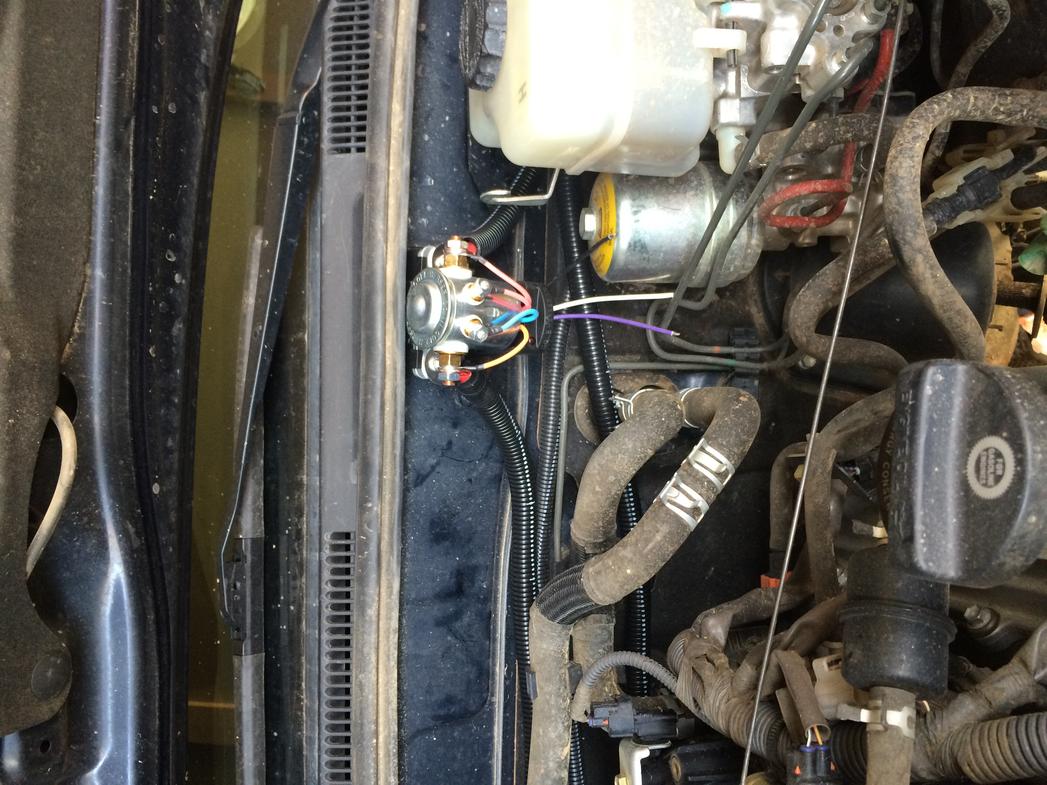

How did you go about wiring the second battery and what kind of switch did you use too keep it charging(bad wording but I cant think of the proper term).
I haven't wired it yet but I have a
Battery-Related Products | Battery Isolators | Smart Battery Isolators48530 | Cole Hersee - Littelfuse
it looked like the easiest to hook up, one button jump start, and it will not overload the alternator plus from research on this forum allot of people liked it

with this one you just hook the one side to the main battery and the other side to the 2nd battery. the boost wire just has to be connected to a switch and I guess ground and your done!

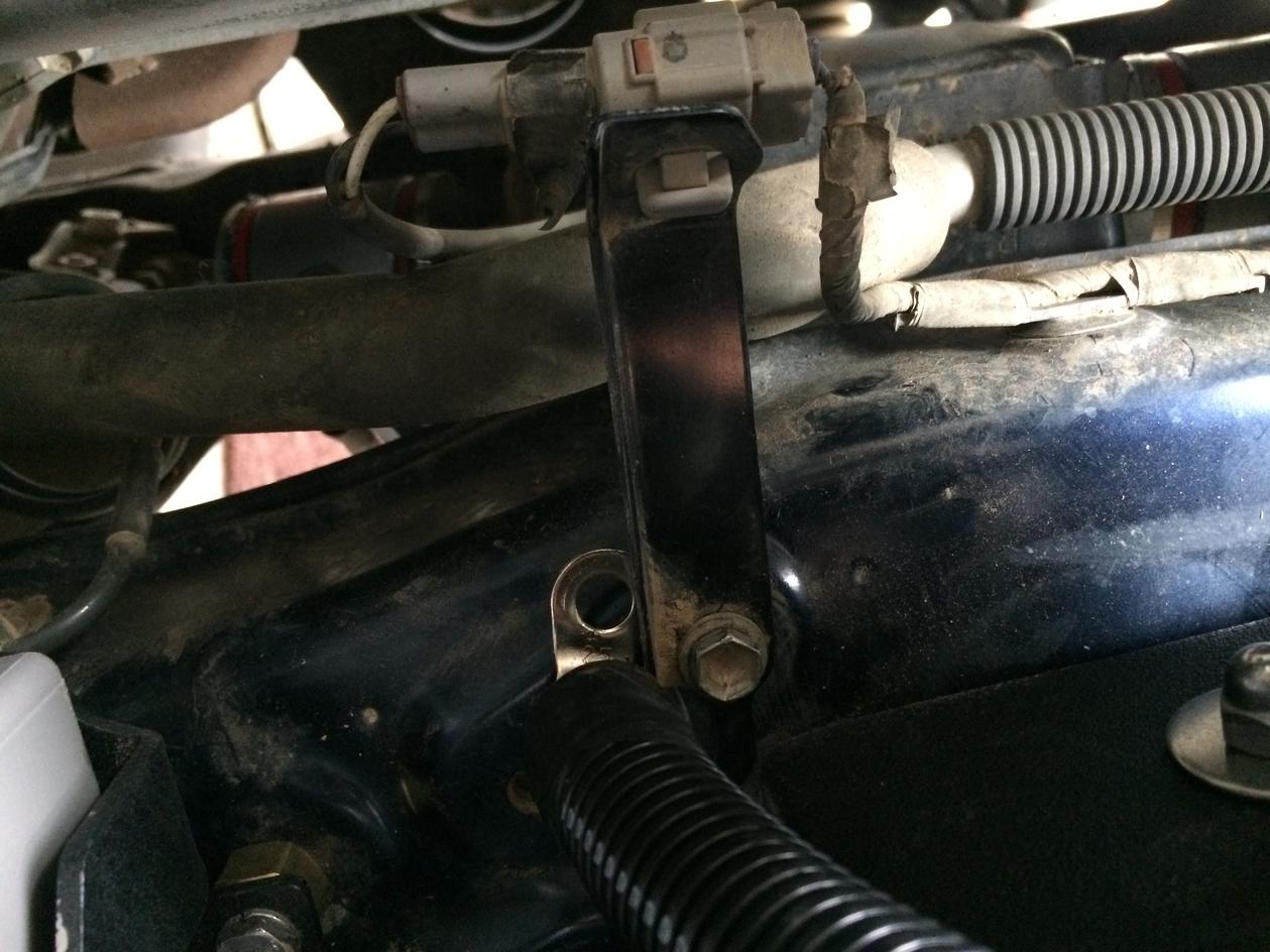

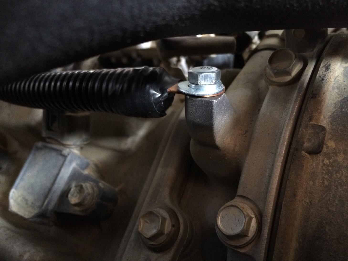

I found there was a ground on the motor on the drivers side and the same area on the passengers side had no bolt but a threaded hole so I used that
