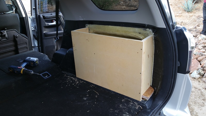

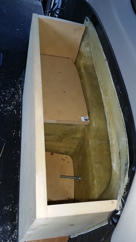

I have to fiberglass the MDF to the other fiberglass, cut the top MDF piece, and seal the box. When that is complete, I can install the sub. Trying to get the box built completely then I will take the front off, cut the hole, and install the sub.
I built up two plates underneath the box to attach it to. I have to carpet those as well. Then carpet the whole thing.
