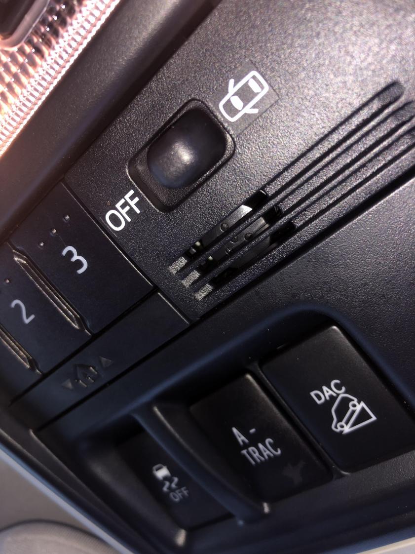

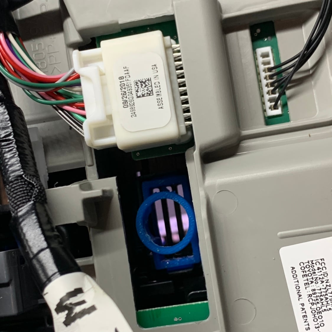

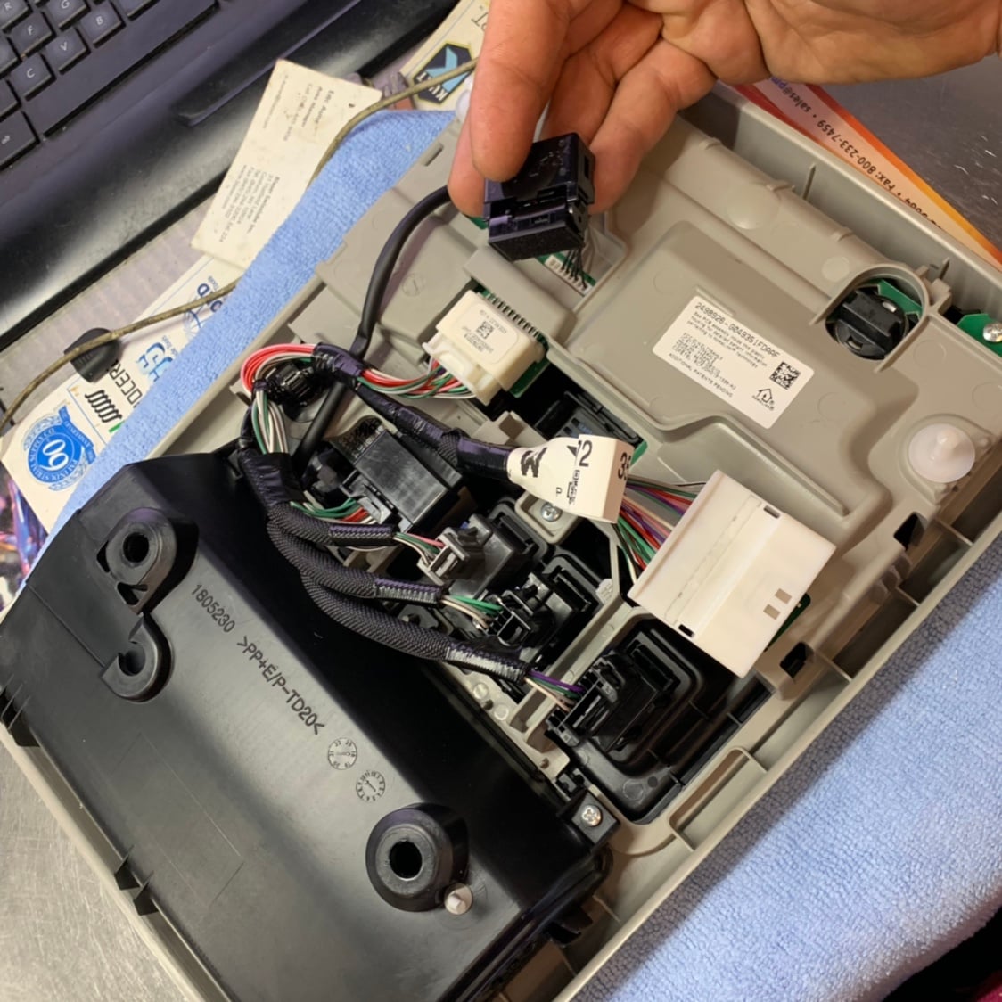

Overhead console with the factory mic:

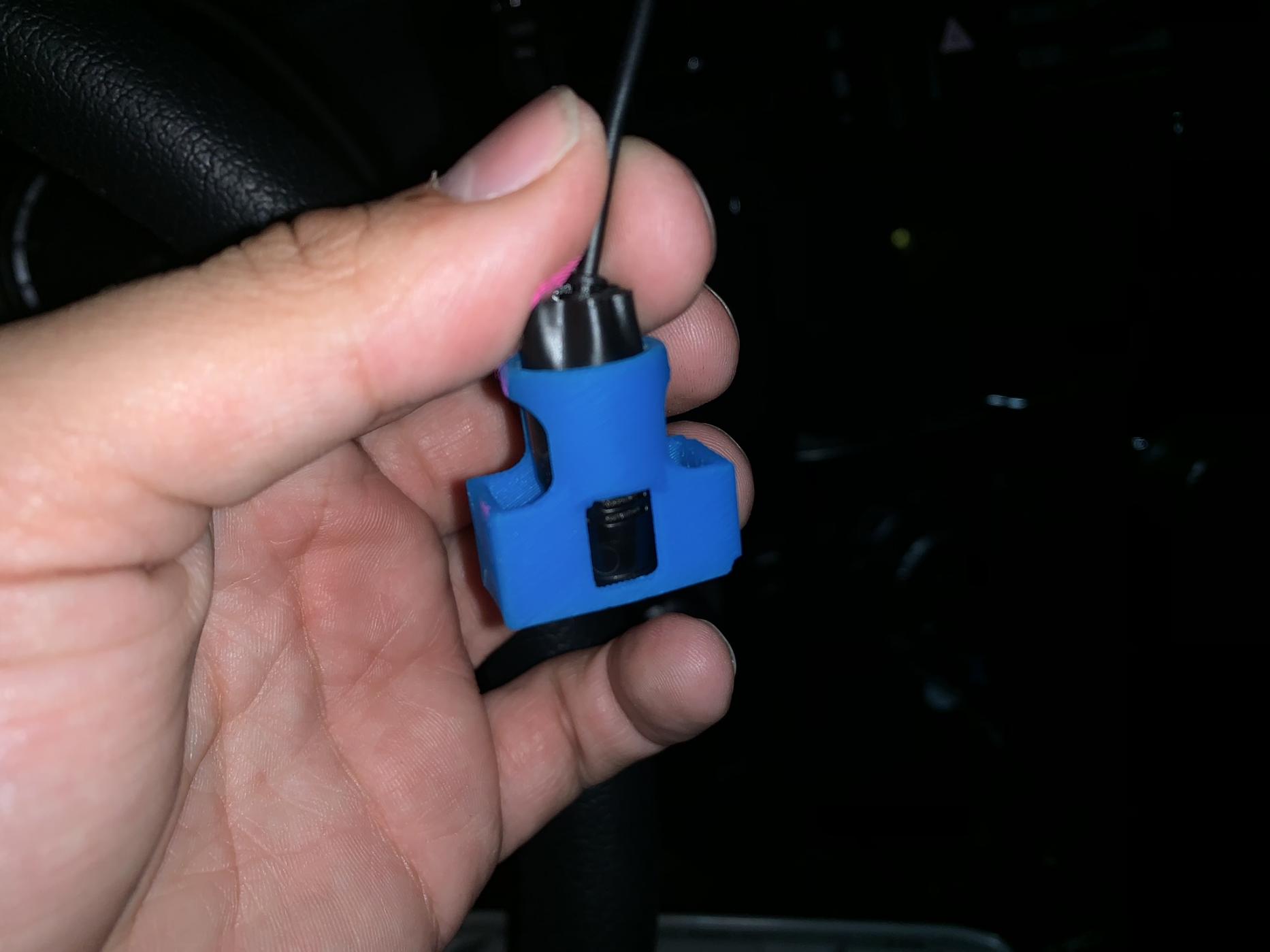

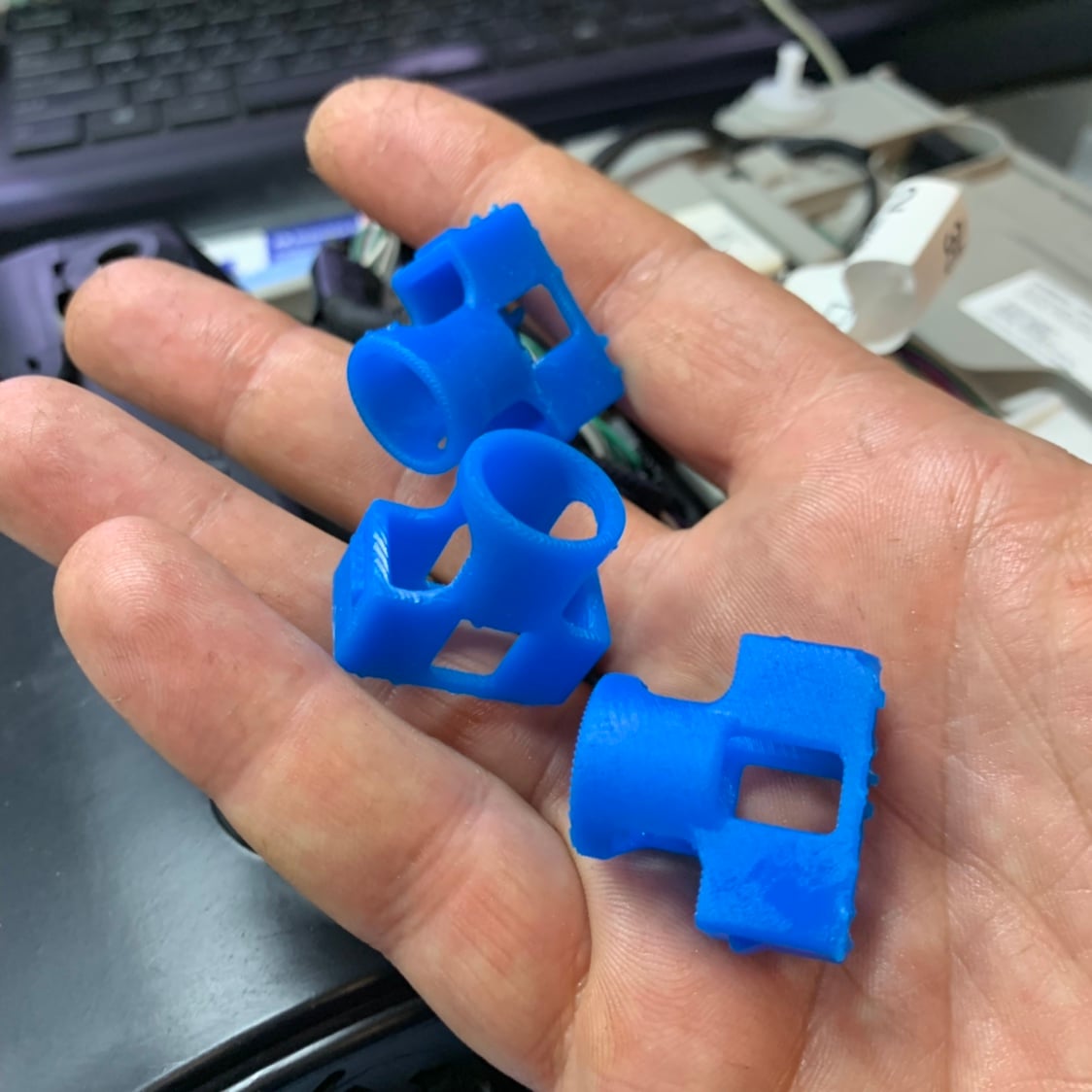

My 3D printed brackets, fresh off the printer. I designed them as open as possible to make sure the side facing mic openings weren’t obscured, and the upper mic bore is ovalized to give it a little spring pressure and hold on to varying diameters better:

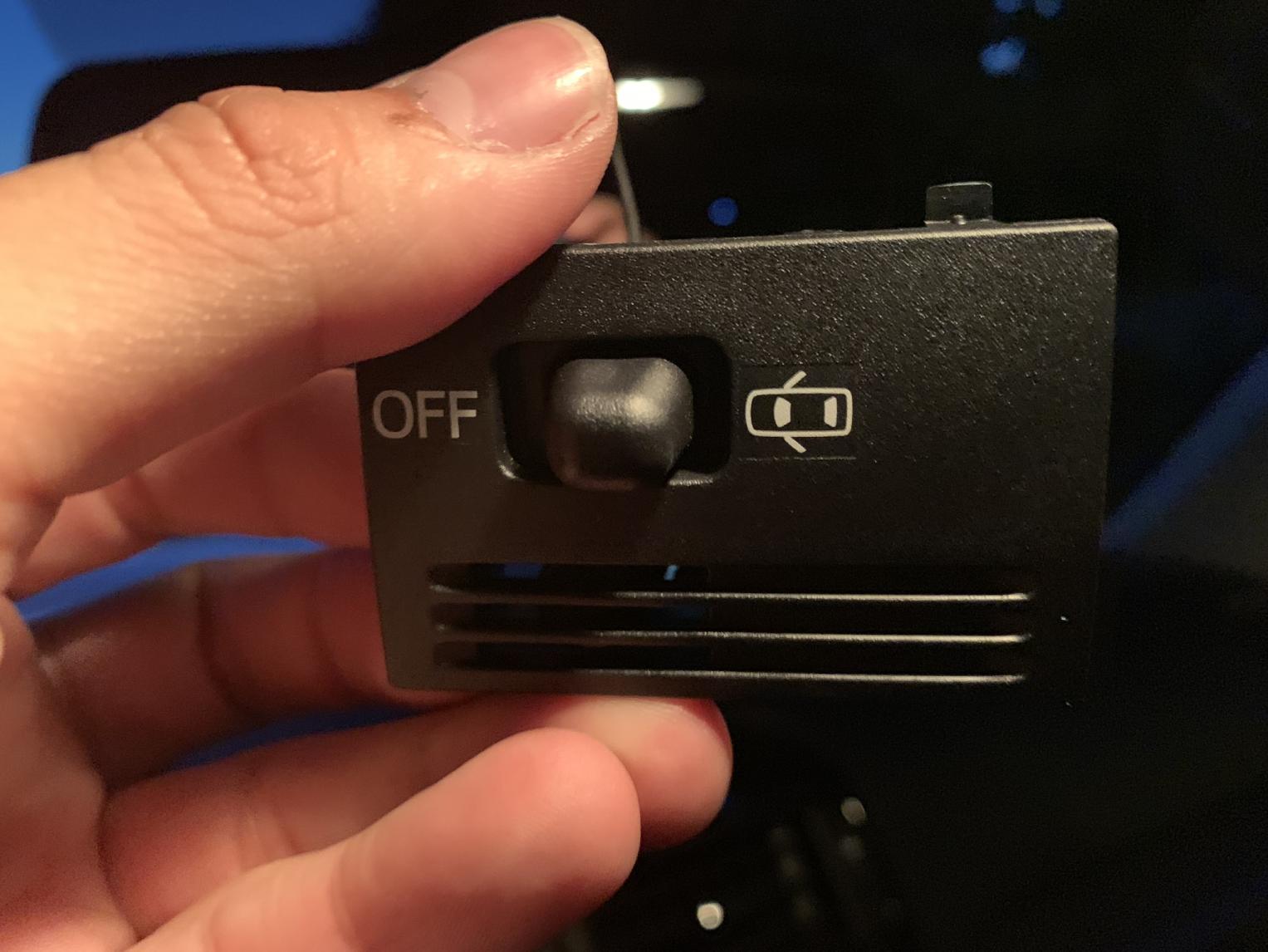

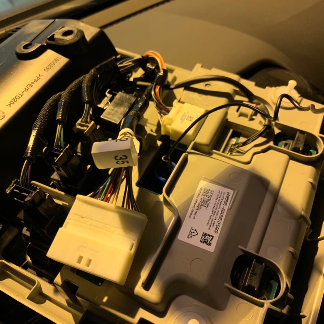

Fitted in the console:

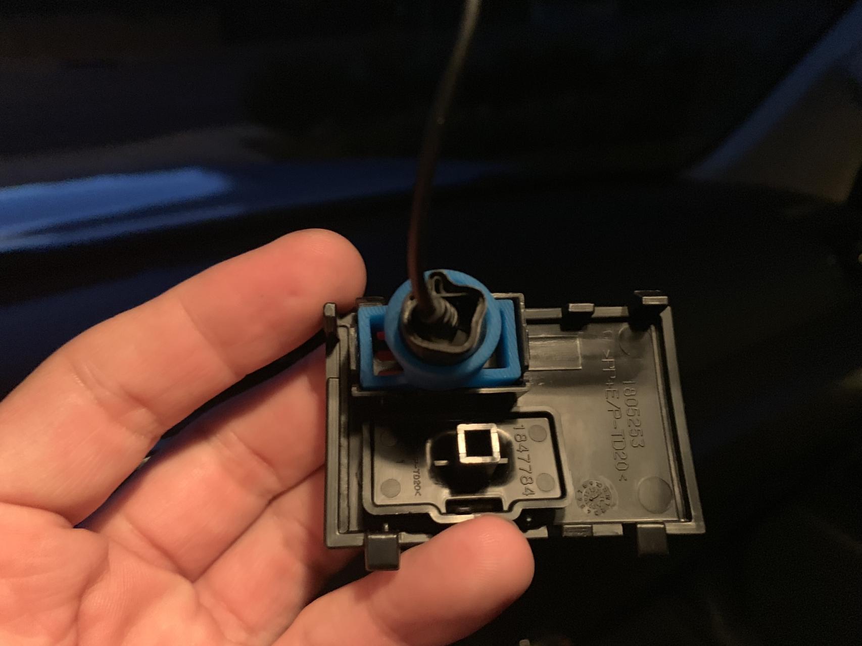

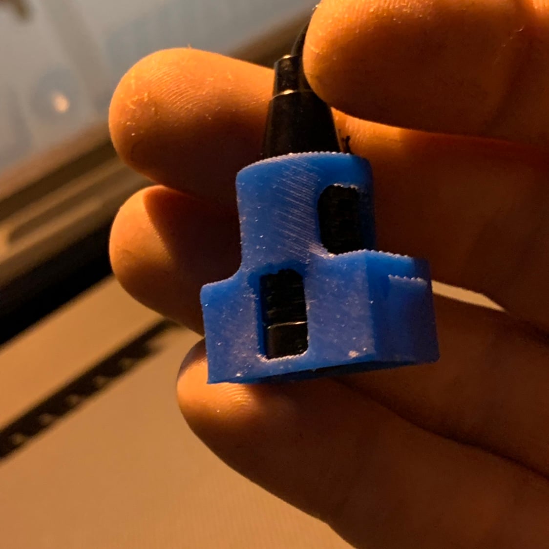

Fitted to the mic (sorry for the dark pic, I did this after work tonight):
Mated up (again, sorry it got dark after work):

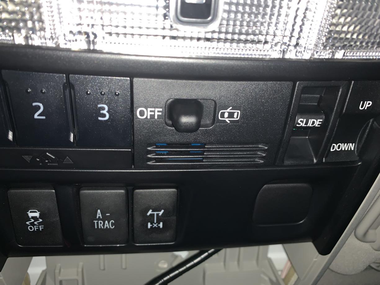

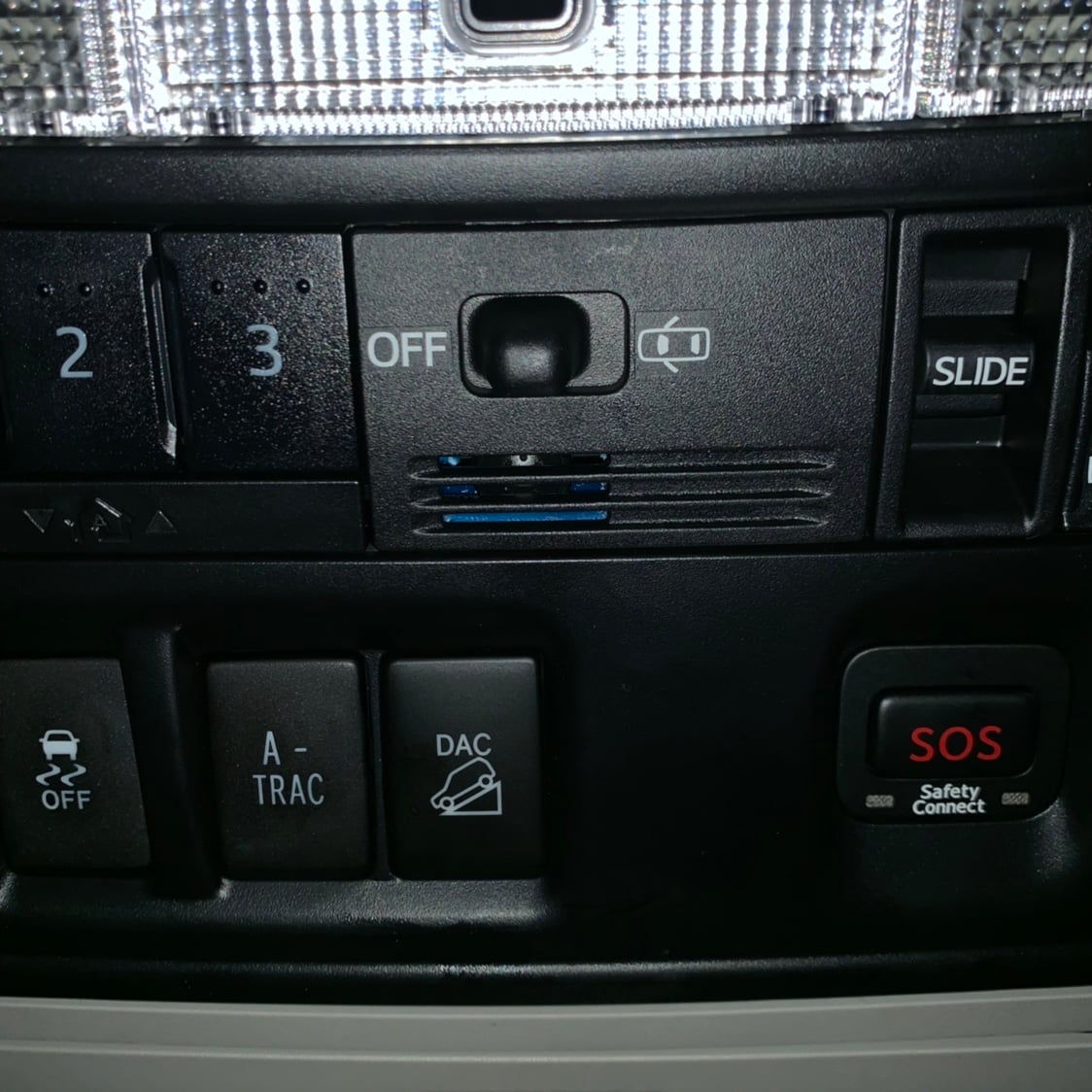

And reassembled. The blue isn’t visible without the flash and the mic is perfectly centered in the opening:
Seems to work great. Everyone I called said I sounded clear and not muffled. Siri works as well as ever (faint praise, at best).
It’s designed around a Kenwood mic, but should work for any mic with about a 0.525” outside diameter. PM me if you want the STL file to print yourself. I wouldn't recommend printing this on an FDM printer as many of the cross sections have to be fairly thin to make it all work. I have an SLA machine, and that works pretty well. I'm sure you can get one printed at any of the online places.

You can't actually see the bracket at all once it's installed unless you specifically shine a light into the openings. Either that, or I ran out of black resin for my printer, lol. Pick one. ; )

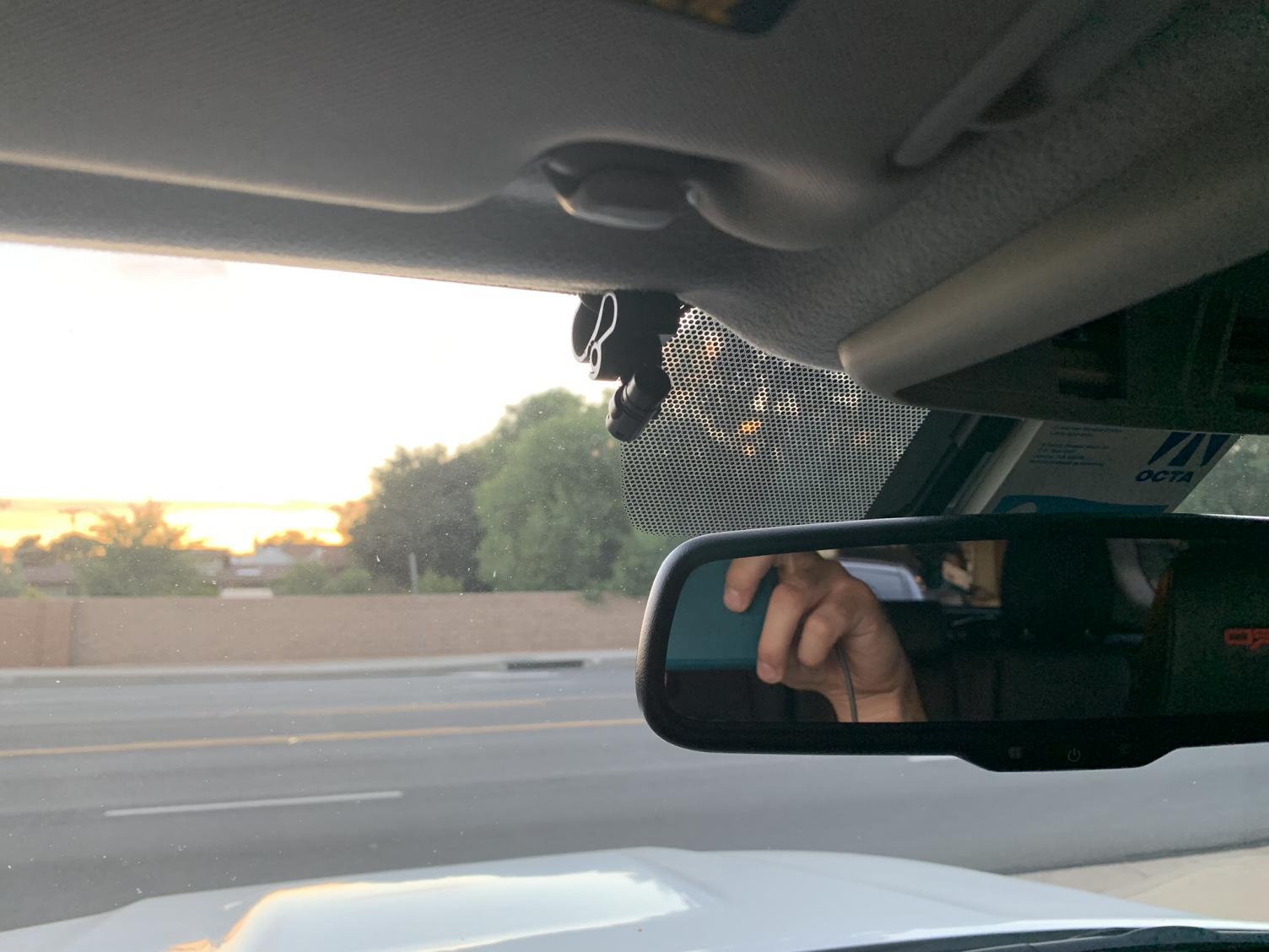

Ran mine in the same spot for my Alpine ILX-F309FRN, works perfect.
