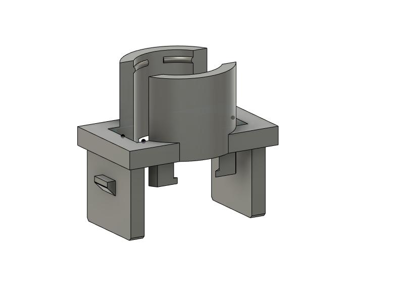

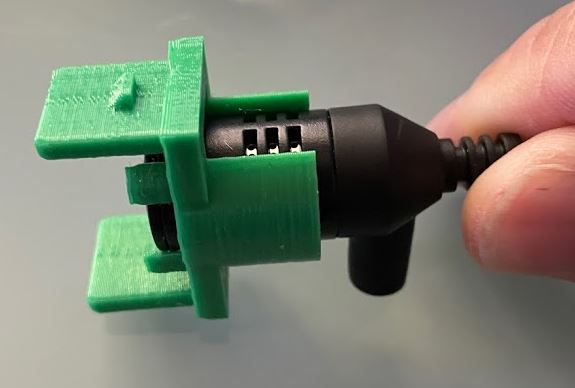

Here is a design I made for the Alpine mic. I still need to do a test fit with everything once I drop the overhead console.
5th Gen 4Runner Alpine Microphone Mount by jasonjason - Thingiverse
It's a remix of KPTexans version, but meant for the Alpine Mic. From what I understand Alpine only offers 1 mic only. I designed this one since I'm going with the Alpine ILX-F309 in my 2015 4runner Limited.

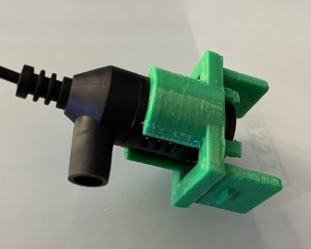

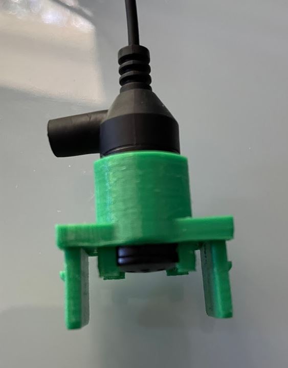

note that the Alpine mic measures 14mm +/- 1mm in diameter. Oddly the +/- is because the mic is not perfectly round. Nor is is oval... It's just not perfectly circular.
--- Update 11:30pm April 27, 2021 ---
A friend brought over his Alpine mic, he too is about to install an ILX-F309 into his 4runner. His Alpine mic diameter measured between 14.05mm to 14.12mm in OD, where as my measured between 13.85mm to 14.01mm in OD.
Needless to say v1 of the STL file originally that was in the Thingiverse link isn't going to work. I've modified the solid model to 14.15mm ID, I've also increased the wall thickness that holds the mic to 3mm thick, as the original 1.5mm wall thickness was too thin and cracked easily.
