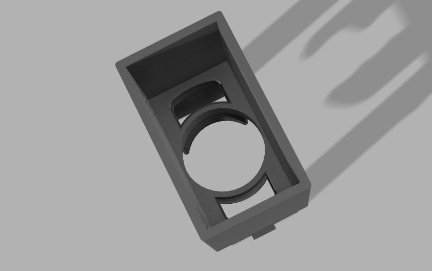

Custom hidden mic bracket for aftermarket head unit

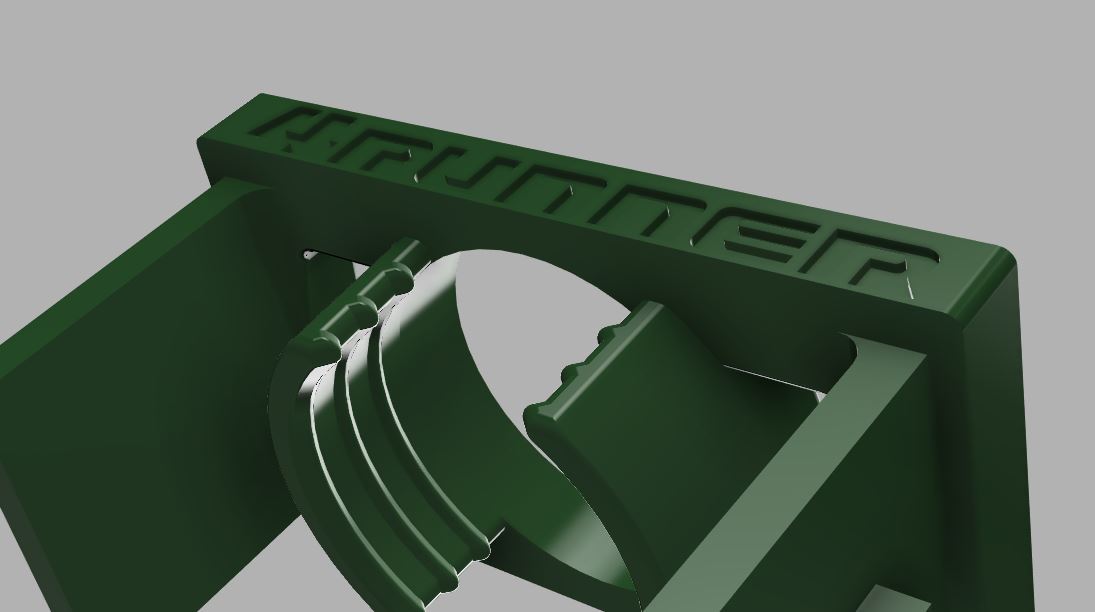

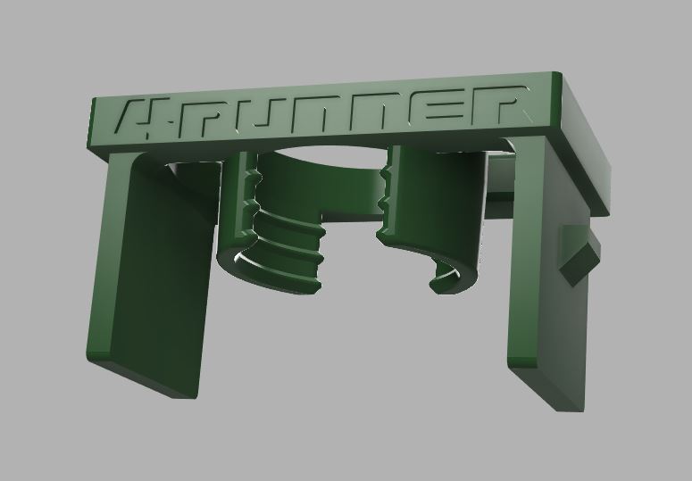

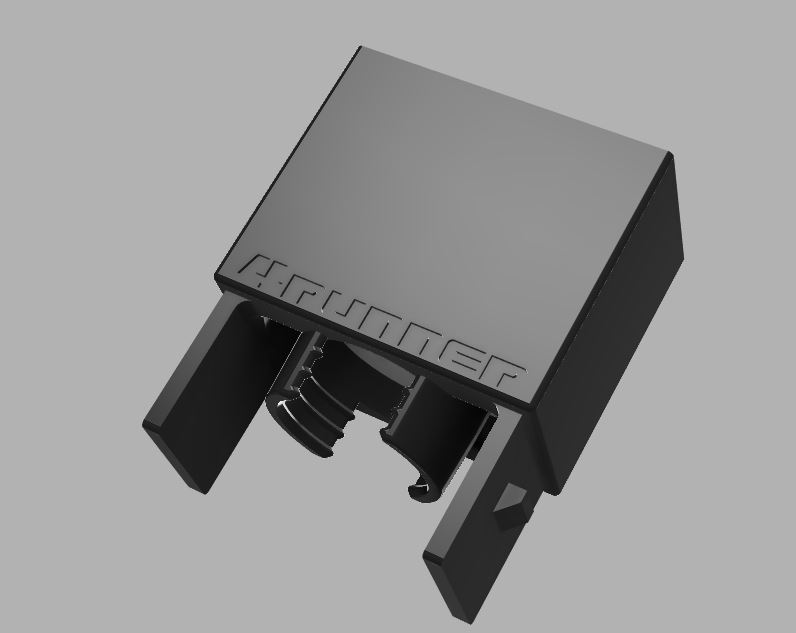

I'll probably end up using the one you printed, but I also played around with a few other designs. Not that it matters since it will never be seen, but I also tried to do some engraving. One design is pretty much identical to the one you printed (dimensions are the same, but with engraving), and one has sides that extend closer to the top of the mic since I was thinking I could insert a piece of foam there to block sound from the roof. Who knows, it may echo worse or something since I'm not an acoustics engineer!:

OK everyone, I had all of my designs printed and was able to do some testing. Bottom line, I ultimately ended up going with my original clip design, but with the later improved bottom dimensions. I recommend you go this route if you are able to pass the microphone connector through first (as if you are doing a new install). This is most likely dependent on the material, but r5's bottom clips are too short in my opinion and it's hard not to break them when pushing the mic through the top. I also found out that trying to do engraving on something that small is difficult and the detail just isn't there.
I've updated my Thingiverse link to have the one I ended up using (r7) and the other version if you absolutely have to pass the mic through the top (r5). Thingiverse link so you don't have to dig for it: 5th Gen 4Runner Kenwood Bluetooth Microphone Mount by KPTexan - Thingiverse
