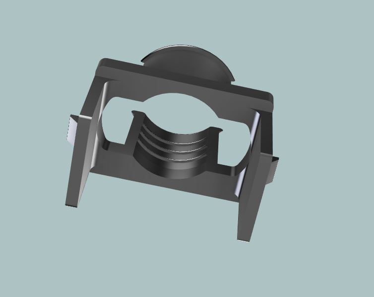

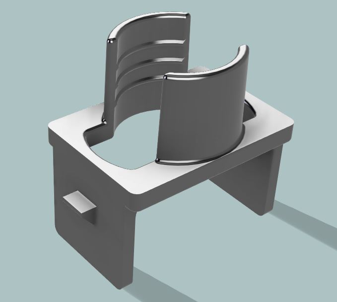

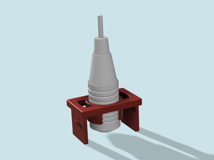

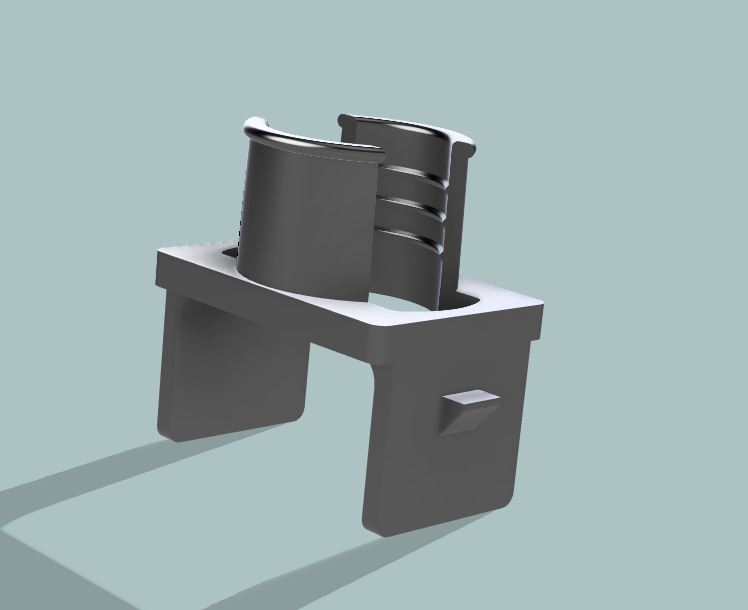

That being said, this gave me the opportunity to play around with some 3D software and it's been a good learning experience. I've been working with AutoCAD for almost 20 years, but AutoDesk Fusion 360 is completely different.

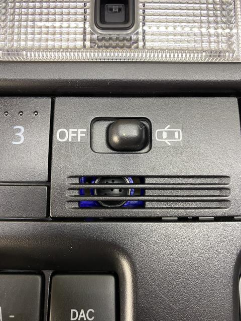

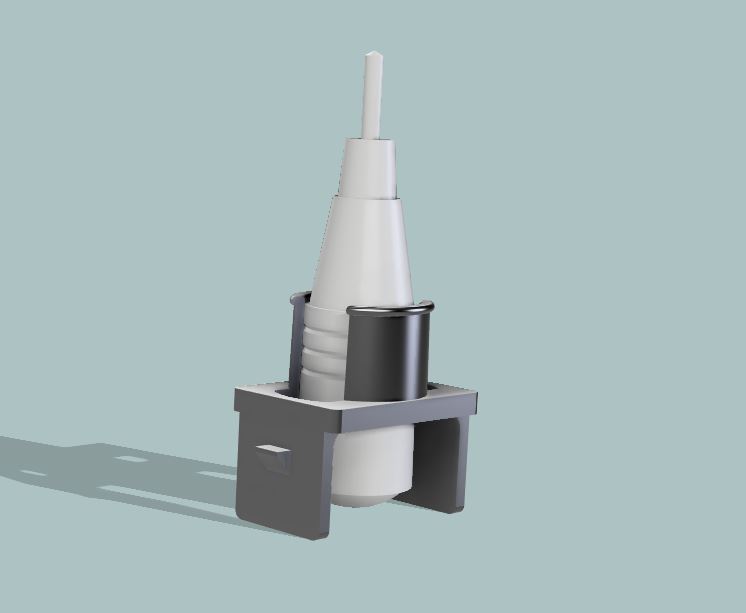

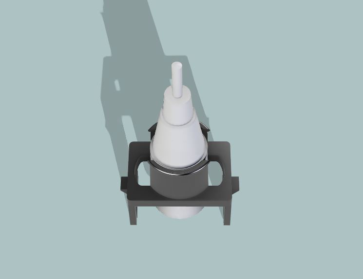

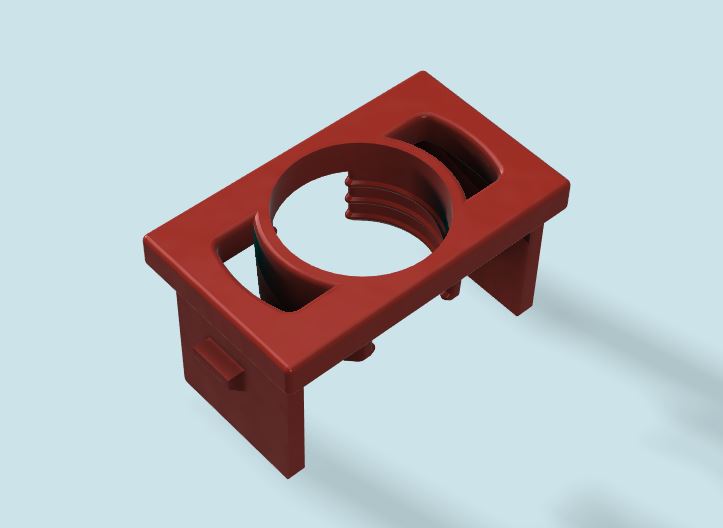

Anyway, I'm going to give this design a shot. I pulled the factory mic and took some dimensions with my calipers - plenty of room for the Kenwood mic in there. It will obviously require some supports during printing, and I admit I've got little experience in this area.
A couple images:

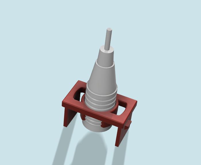

I originally had that rim around the top since I planned on tightening it up with an 1/8" zip tie - would've worked without a zip tie since it should have a bit of spring pressure but I wanted to be sure. Now that my design has the teeth to interface with the grooves in the mic, I've gone ahead and removed the rim and softened up some of the edges:

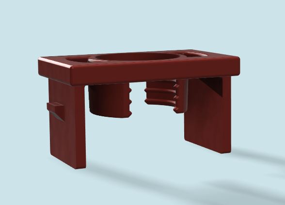

As mentioned, I made a few modifications to the design, primarily due to the OEM microphone pocket dimensions. It actually would've worked the way it was and it technically fit, but it was not close enough to my liking. I also didn't realize I could remove the microphone plate from the outside of the console, so this allowed me to do a more precise job on the dimensions.
I made 1 leg slightly less wide than then other so as not to interfere with the catch on the panel. Another enhancement I made is that the mic can now be inserted from the top. The last one was designed to accept the mic from the wire side first - this essentially meant that you had to pass the connector and wire through the bottom of adapter before fully seating the mic. Kenwood put a taper on this mic that makes design a bit of a challenge! For this latest version, the mic can be inserted from the top of the adapter and it engages the bottom 3 grooves of the mic. The top 3 grooves of the mic also have holes for sound, so it may be better not to interface with these anyway, even though I did have a cutout for them.
The Thingiverse link I posted above has been updated with the latest design. A few images:
