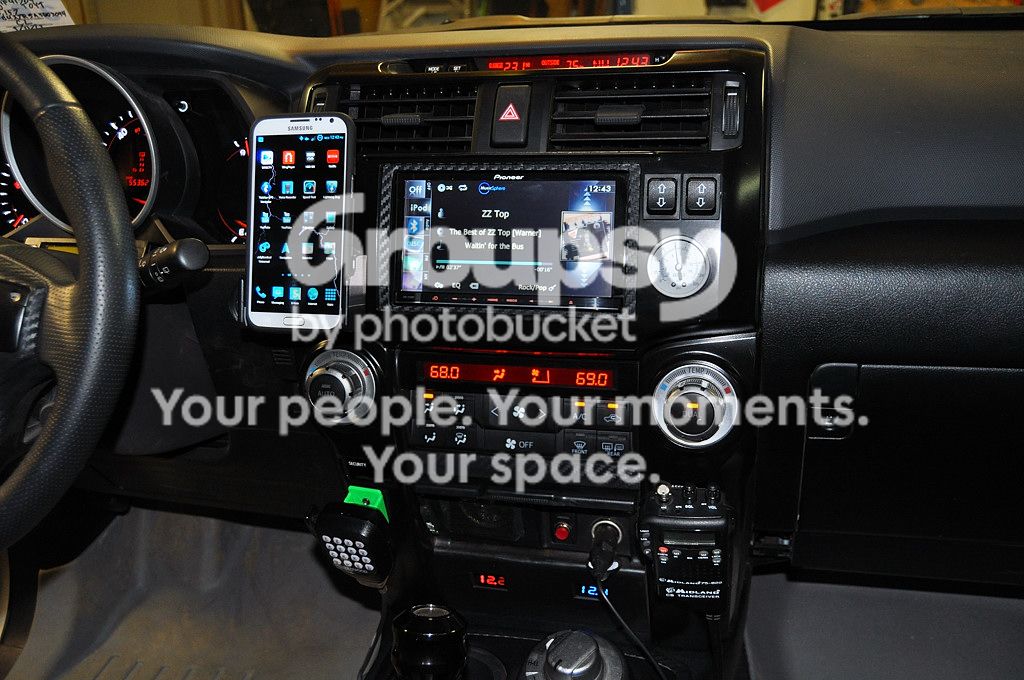

I took the Metra dash adapter for my Pioneer out and made the cutouts
Picture019-6_zps2fae1ea0.jpg~original

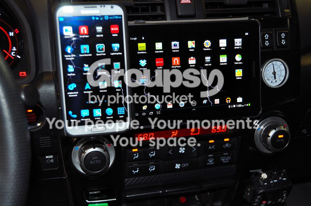

And here's with my tablet in place and tethers wirelessly thru my rooted Android phone app and the sound goes thru the Pioneer Z120BT with bluetooth.
Picture031-1_zps863c86b3.jpg~original
I put in glow in the dark mic holders for the Kenwood mic and the Midland 75-822 CB
I wanted to reference what Garry did as I want to do something similar.
What do you all suggest to do to cut and secure some switches and a battery gauge?
Never cut trim before, whats there to take note of? I also need to cut into my rear bumpers for some reverse light install so whats to note?
Hey Danny
I use a pneumatic pencil die grinder made by ARO that I've had for years but they aren't cheap new.I got mine used from a Lockheed aircraft surplus store in Georgia about 20 years ago.It has a common 1/8" chuck that you can chuck up cut off wheels ,sanders,ect.
I suggest something like a Dremel rotary kit for just cutting plastic but I also use a drill to drill small holes in the corners of what I'm cutting after I lay it.Then use a small cut off wheel to cut hole to hole and a file to fine tune the cutout. The air gauge for the lockers was cut out with a hole saw and has clips on the back to hold it in place.
Hey Danny
Thanks Gary... what did you use to hold the gauge/switches in place? Glue? double sided tape or just slid in?
