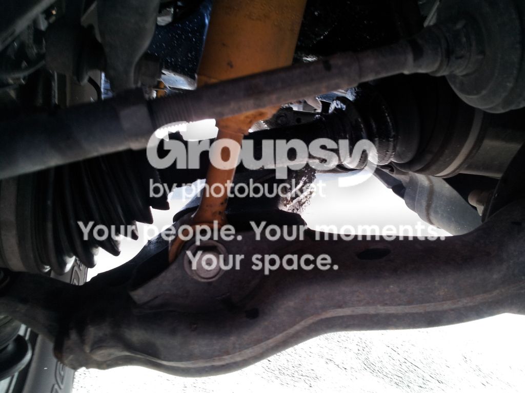

Its leaking from the inner one (closest to motor) I think.
20120419_183041.jpg~original
Common problem. I tried the hose clamp fix. It lasted for a short while then the clamp tore the boot. I ultimately replaced the boot myself. Here is a great write up - http://www.toyota-4runner.org/4th-gen-t4rs/101038-how-install-new-cv-axles.html#post914207.
