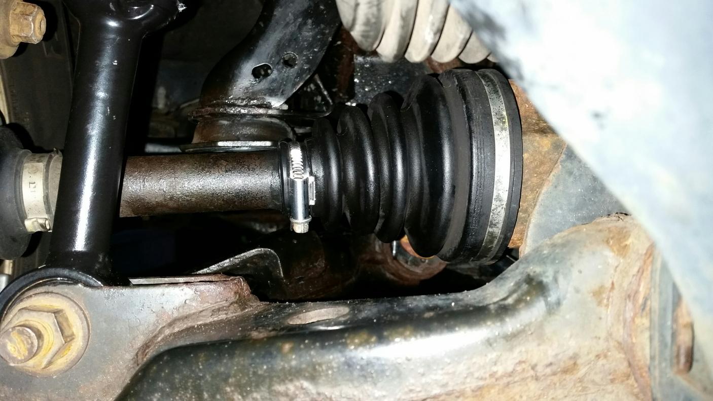

Installed the clamps from McMaster Carr literally 5 minutes ago. I'm going to go for a ride shortly to check out my leaking CV problem with hopes of no more grease.

I'd like to report that after my 10 mile round trip to and from the gym I no longer have grease coming out of those CV boots. I'm going to keep my eye on them, but so far so good with the McMaster Carr clamps.
Put 100+ miles on yesterday and still looking good.

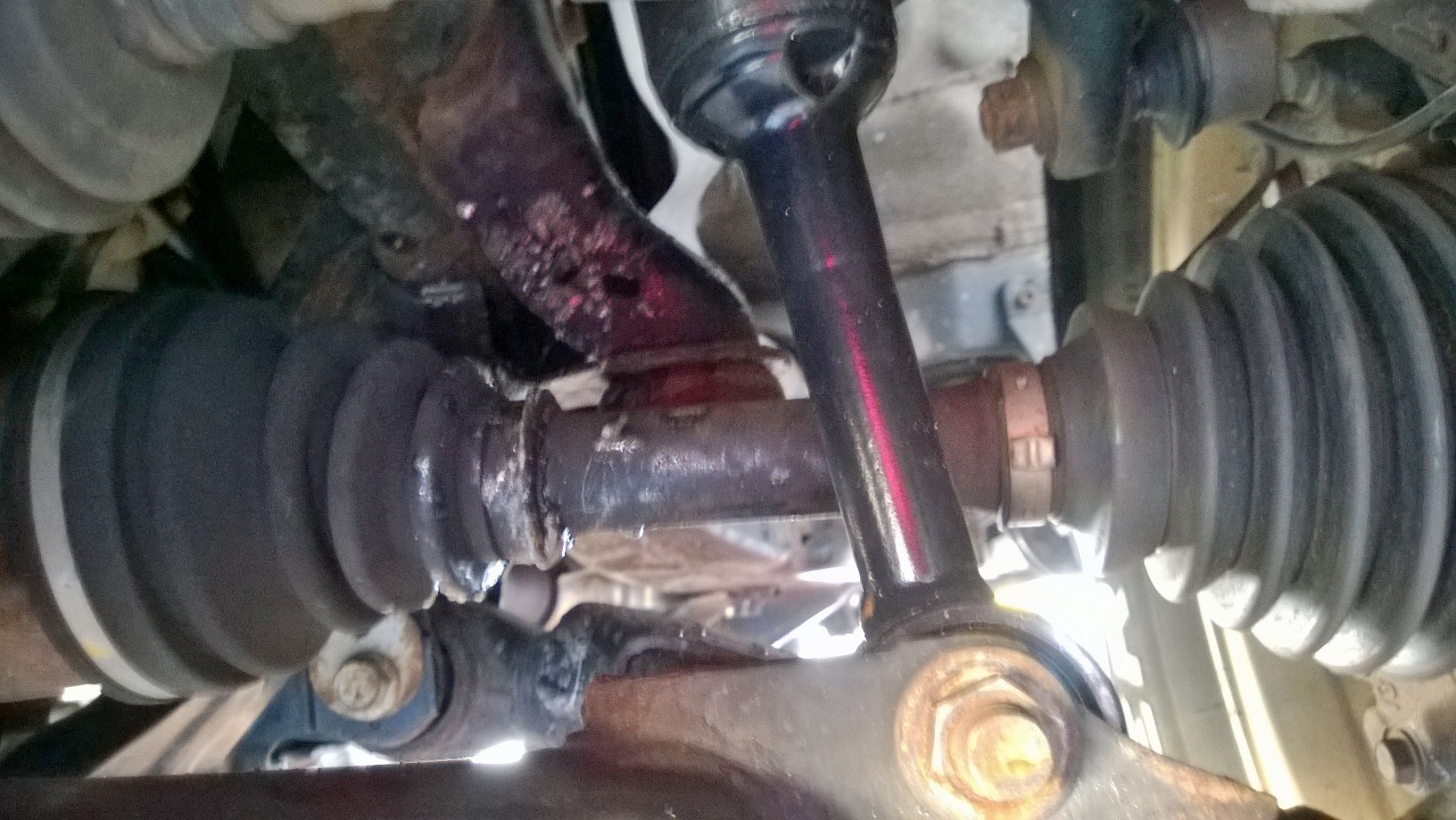

Once I added my lift i tore my driver side boot first then a day or two my passenger tore. sprayed CV greese everywhere on both sides it was the inner boots that tore. I know a buddy at a drive line shop an took the shafts to him one saterday just to see what he had to offer. You can have some machine work done on these things and have bigger bearings installed and beef them up so to say. He offered to take my old one and give me a "built" one for 215.00 per half shaft. Being broke an all I didnt take his offer but in our converstation he had pulled out a tundra CV axle he had on the shelf he was just pointing a few things out when i noticed The boots have the same diameter openings as our shafts but there longer! just long enough to completly forgive our negative angles. Knowing that CV axle failure mainly comes from torn boots i had them rebuild my shafts with tundra boots. I've got 9700 miles on them with a 3" lift no diff drop. Running great!!
