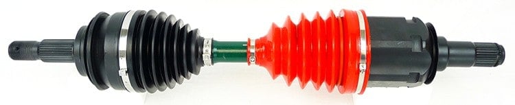

I ended up just springing for the CVJ remanned axles, after doing the OME lift and bilstien 5100's with the diff drop kit, my old oem axles were starting to click especially after wheeling in the snow this last weekend. Can't say a bad thing about the staff there at CVJ, this is the model I ended up with:
9808 TR - CVJ Axles
Going to do Hubs and front bearings at the same time when the axles show up.
The reason I mentioned this axle is they use a red boot thats is suppose to be a bit more robust, I have not done a lot of searching but wonder if they are available by themselves?

Do these handle a drop well? I am looking to mod/take care/refresh my 4 runner thats a bit old. I wanted to lift the car but a bit hesitent because of the CV angles and this is my daily - so not looking to have to replace thse often or have to worry about it.
I think the OEM boots/CV's are pretty damn good as far as quality. I talked to the guys at CVJ they said these are the best you will get for a lift with the stock suspension arms. Factors that make a difference: do the diff drop kit when you lift, do the boot stretch mod so the ribs don't touch, be wary of your CV axle angles. That being said none of them are completely bulletproof, but these are damn good.
I'll post an update when they show up and I pull everything apart and post some photos too.
