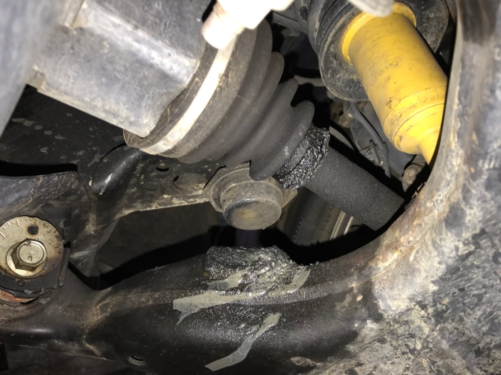

Its leaking from the inner one (closest to motor) I think.
20120419_183041.jpg~original
Is the boot cracked?
