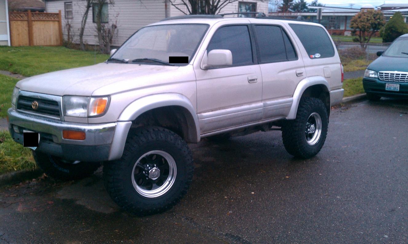

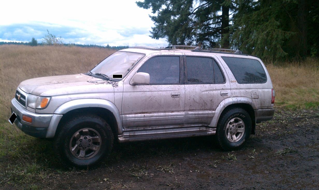

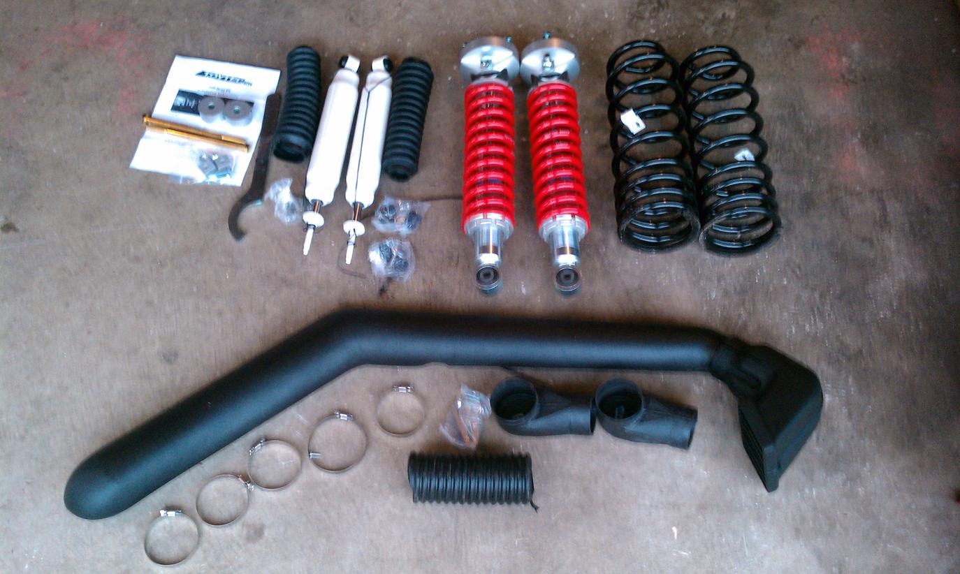

Here is what I have so far.
Toytec ulltimate lift with red coils on front and OME 891 with pro comp 9000 shocks along with a 1 inch diff drop. I have 285/ 75r16 good year wrangler duratrac tires on my 97 4 runner limited. SO after I put the lift on and drove it a bit I started noticing that my cv boots were loosing grease and slinging it everywhere..... I think i got around 3 inches out of the lift total but i figured with the diff drop the cv axels would be ok... any ideas?

BTW your rig looks great!
Off topic, but are you blocking out the vin # on your dash? I can't even read those when I'm right in front of them.
That sucks about the cv's, but its going to happen. Your 4runner looks sick though.

thanks for the info guys.. ill def have to get some of those clamps.. and here is some updated pics with the new snorkel on there..
jmt2404-albums-johns+97+runner-picture1161-full-size-pic-truck.html
dont know if that link worked.. haha ... newbie.. whatever if you wanna see the snorkel its on my profile under my albums if it didnt work..
