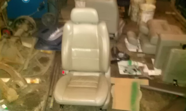

Those infinity seats, what model did they come out of?
Did you have to modify anything?
Where they adjustable?
They're out of a QX4, I had to do some bending a re-drilling on the seat mounts themselves, re-build the front mounts in the 4Runner, which inluded cutting the inside mounts out completely and welding in new ones from scratch, had to weld up a little bracket to come off of the transmission tunnel to catch the flat mount on the seats since the 4Runner bolts right up to the side of it. In the back the bottoms mounted up super easy, and the backs were just a matter of building a mounting plate and welding it in to the floor.
Definitely a lot of work, and not for the faint of heart, but worth it to me. It's the single mod that I enjoy the most on a day to day basis, and the seats are much nicer than any of the factory seats that came in the 3rd gen.
And yes, the seats are Power adjustable, 3 way on the driver's and 2 way on the passenger's as well as heated. It's all very easy to wire in as well.
