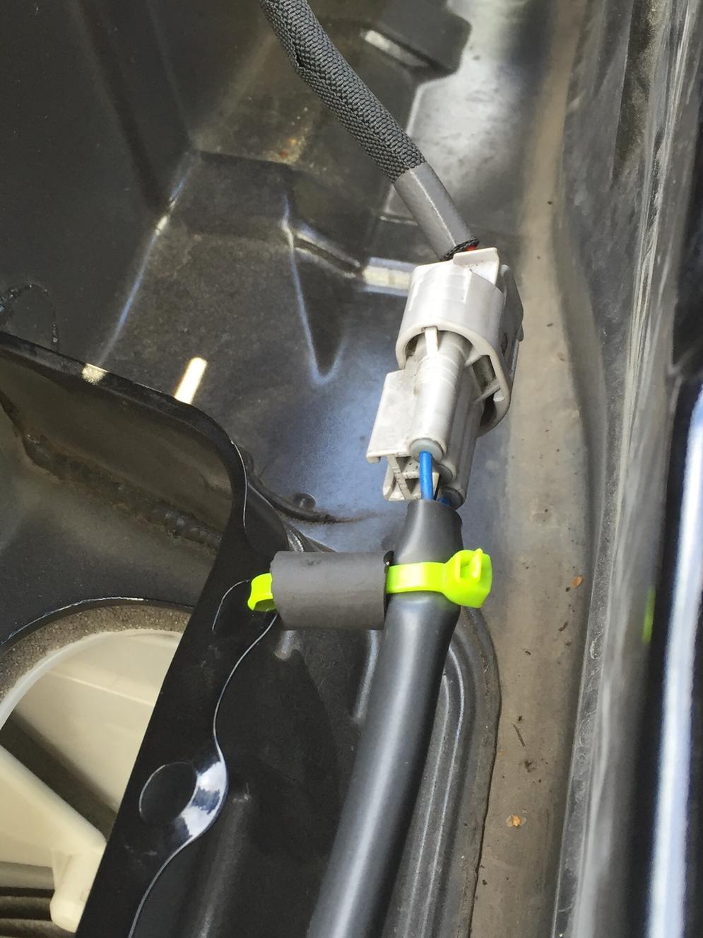

I found my rattle!!!
I pulled the plastic cowl off where the wipers are to see if the rattle was a rock or something, and I found that it was clean as a whistle. But since I had it apart I figured check everything, I found that the wire that comes off of the wiper defroster connects to a gray clip (passenger side) and when I wiggled it, there was my rattle click sound. I pulled it off and zip tied it back on. Over a month now and no rattle. Hope this helps some of you all that still searching

How difficult was it to pull off the wiper cowl? I have a new '16 and there has been a rattle since day one and 5 miles on the odometer. I believe I have narrowed it down to the passenger side near the windshield/dash. My '08 Tundra had a similar issue and it was the cowl tapping against the glass. I want to tackle it this weekend. Thanks!
Same here on my 16 trail
Same here on my 16 LE. I took a few pictures. I zip-tied the black piece in the picture. No more noise.

The piece that holds the connector doesn't look like it should even go where its installed. Poorly designed piece.

I put a 1" piece of 3m VHB tape under the black plastic piece.

I was hoping that squirrly plastic piece was the answer. Just the same, I used a piece of hose and a tie-wrap, and The bracket is removed. So I can at least eliminate that.
