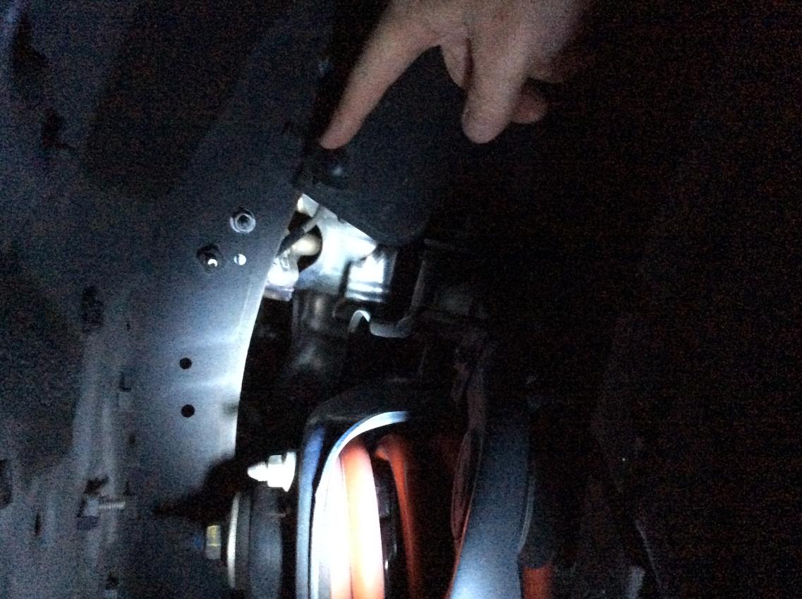

I have had a random rattle that sounds like it's coming from behind the driver side AC vent. That or the wiper area, I could tell it was wind related. After our last road trip it was very prevalent and even the wife noticed...so it was time to find it. She hopped in the driver seat while I ran a leaf blower into the front end at various locations waiting for her to signal that she heard it. It wasn't until I hit the wheel well that I got the thumbs up. The plastic clips that hold the inner fender liner were loose. I put I tie wrap under them for now and the noise is gone. It is funny how sound travels because sitting in the truck you would swear it was right behind the dash.
THANK YOU!! I checked the plastic clips yesterday evening and was able to reproduce the sound I was hearing in the cabin by moving the clips up and down and around in a circle.
I have had this issue for a while but couldn't track it down. I even took it out to the local dealership and they could hear it but didn't know where the sound was coming from either. They thought it was around the hood area but I always felt like it was coming from the wheel well or behind the dash somewhere.
I had some 1/4" stainless steel washers at the house so I put the washer in between the clip and the flap so it wouldn't be touching the metal on the other side of the flap. With the washer on, the clip pulled up tight. On the 50 minute drive this morning there was no sound.
The sound only seemed to be coming from the top two clips. The 4runner seemed so quiet this morning without that squeaking noise. Thanks again for posting this!
