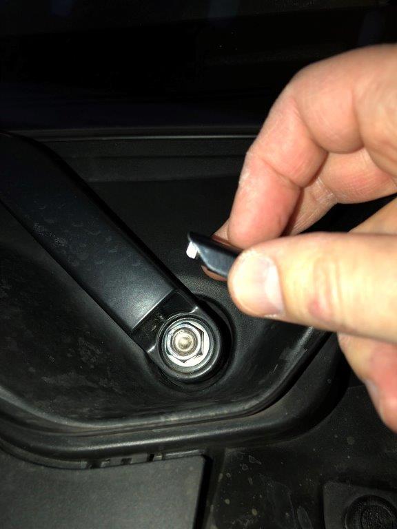

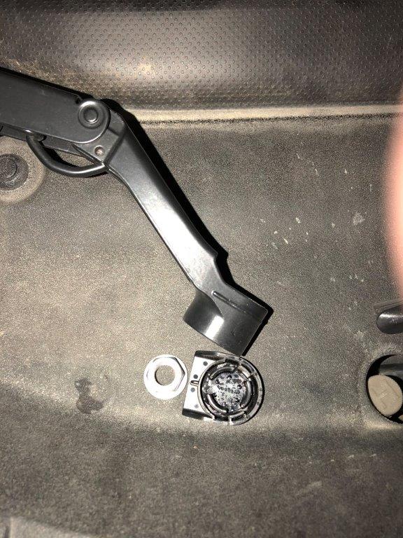

First I had to remove the wiper arms. Once the cap is off it needs a 14mm socket to remove. it's not on super tight. Picture 1 and 2.

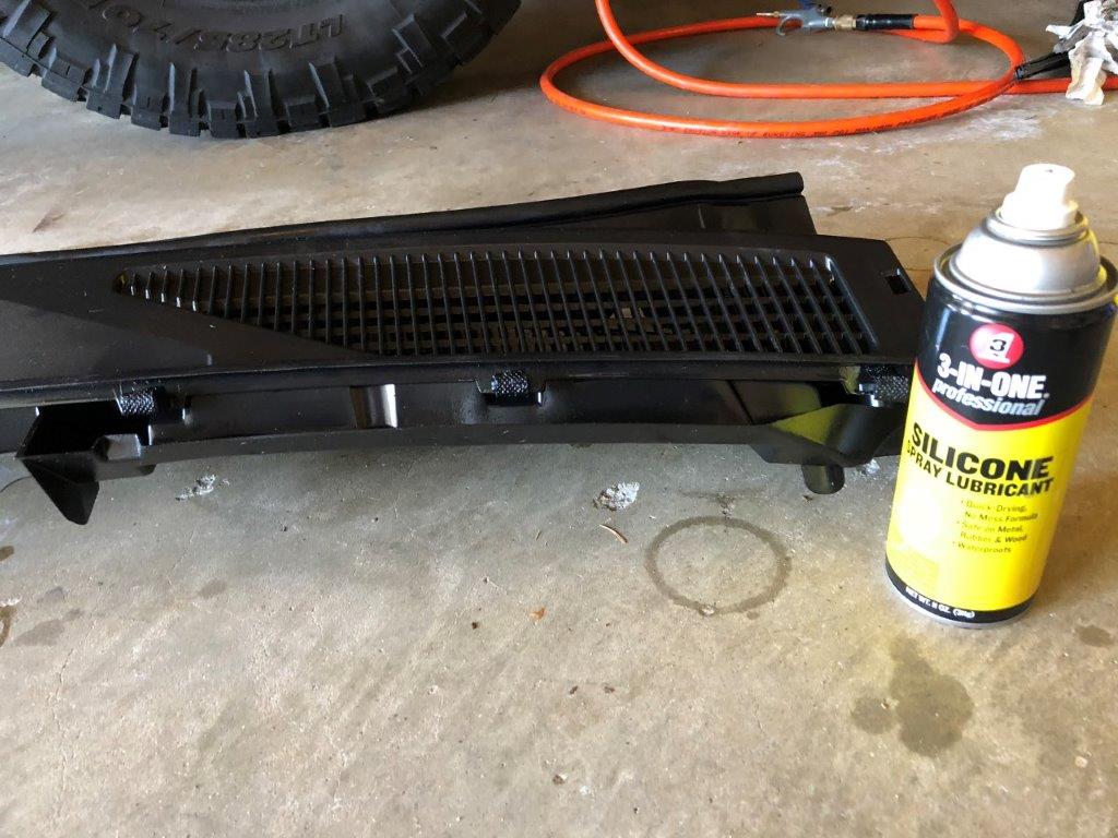

With the cowl off I decided to spray and wipe the contacting surfaces with Silicone spray. Picture 5

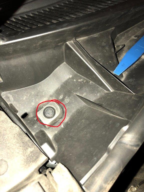

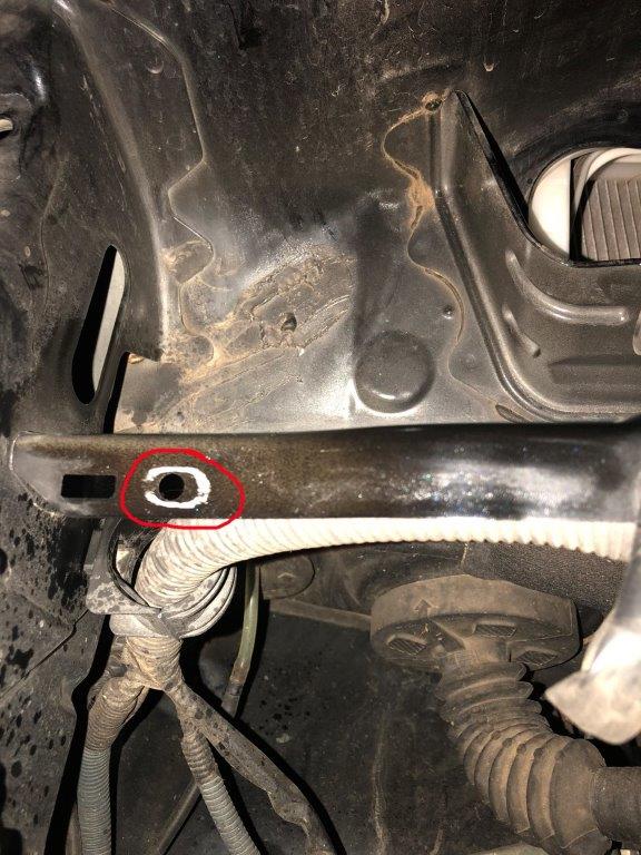

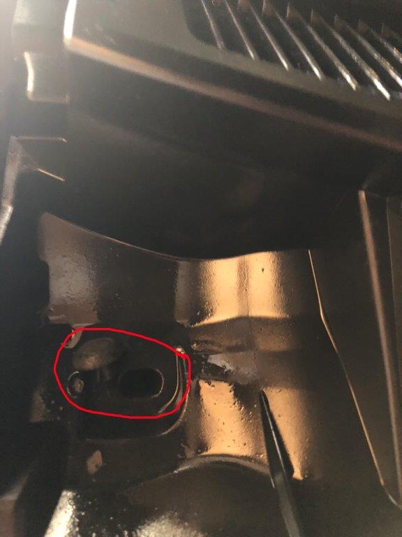

I think I found it! This is the passenger side area where the cowl clips in with the push-button fastener. Driver side was not as worn but did have some wear although the squeak didn't seem to come from the driver side. Picture 6
Double-sided stick foam tape in the holes for the push-button and Silicone spray for all of the contact points seemed to have silenced the noise for now. I will report back after some more weathering on the cowl.
