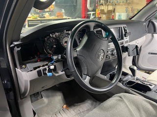

Got it today. Had it out in 40 Mins with some slight distractions.
Found a guide on it but that said to drop the steering wheel which I didn't find was needed.

I will when I get home. Honestly it's not bad. Mostly screws, 10mm and 1 12mm bolt.

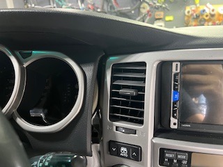

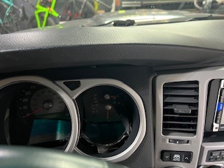

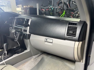

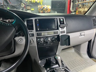

To answer your question, yes, the 2006 dash fits in the 2003-2005 models but with a a caveat.
I have a 2004 V8 and the dashboard was pretty badly cracked, so I started to search for a suitable replacement which was not easy in my area.
Anyway, found a 2006 dash in excellent condition and swapped out the old, cracked one to this newer one.
Everything lined up pretty nicely and I was really happy until I got to the last bit: fitting the bezel around the instrument cluster…which did not fit at all. The 2006 dash has a different contour for the bezel.
Did some research and I found out that the instrument cluster and the bezel is different for the model years of 2006-2009.
In short, when you replace the dash in the 2003-2005 models with a 2006-2009 model dashboard, you will need the instrument cluster and the bezel as well in order to complete the swap.
I did not get the additional parts because I found a dash from a 2003 model in perfect condition (it was a recall replacement) and so I yanked out the 2006 and installed this one.
It’s not difficult to remove and install a dashboard, you will need a 10mm and a 12mm socket, a Philips head screwdriver and maybe a small plastic pryer.
I hope some of you will find this info helpful.
Here’s some pictures of the 2006 dash installed in my 2004 4runner:
