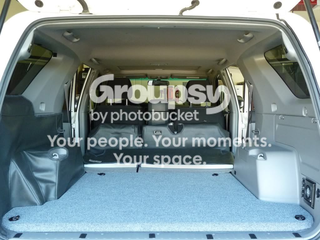

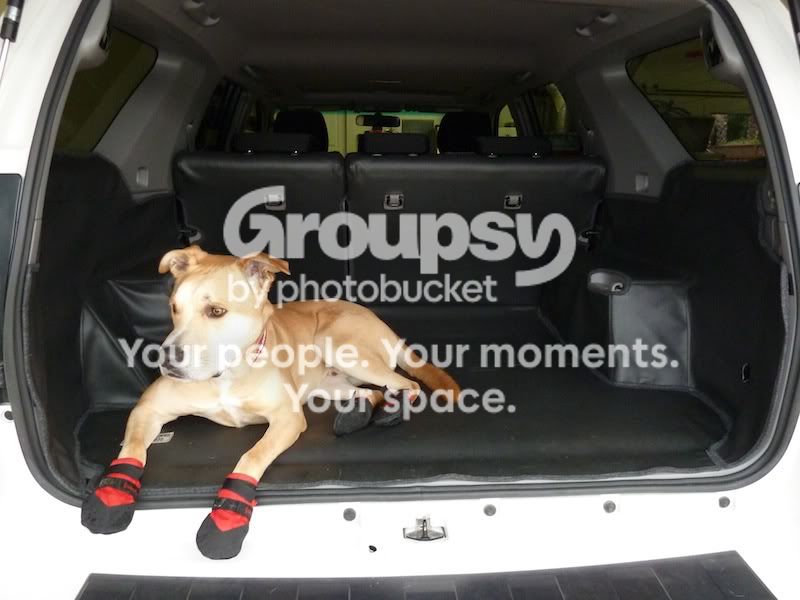

I was wondering how you cut the sheet of plywood for the cargo area. Did you make a template or something similar and then transfer it to the plywood? Would you mind giving a quick run down of that process? I'm looking at doing something similar. Thanks!

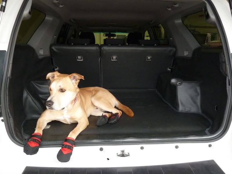

I used the Ultimate Petliner as a template.
P1000791.jpg~original
Placed it over the plywood and traced around it with a pencil. I cut it a little smaller to allow for clearance for the carpet and some wiggle room. After cutting the wood, I chamfered the edge that meets the door sill by routing the top edge with a 45 degree bit. Rounded out all the top edges with a belt sander. The carpet is attached using 3M contact cement and stapled on the bottom.
Using longer bolts, I anchored the plywood to the deck (directly over the factory carpet) at the 4 factory tie-down points. I ended up removing the D ring tie downs from 3 of the points except for the rear driver's location and replaced them with flat washers. I also put spacers (3/8"-1/2" IIRC) between the plywood and the body at the front location to level out the board.

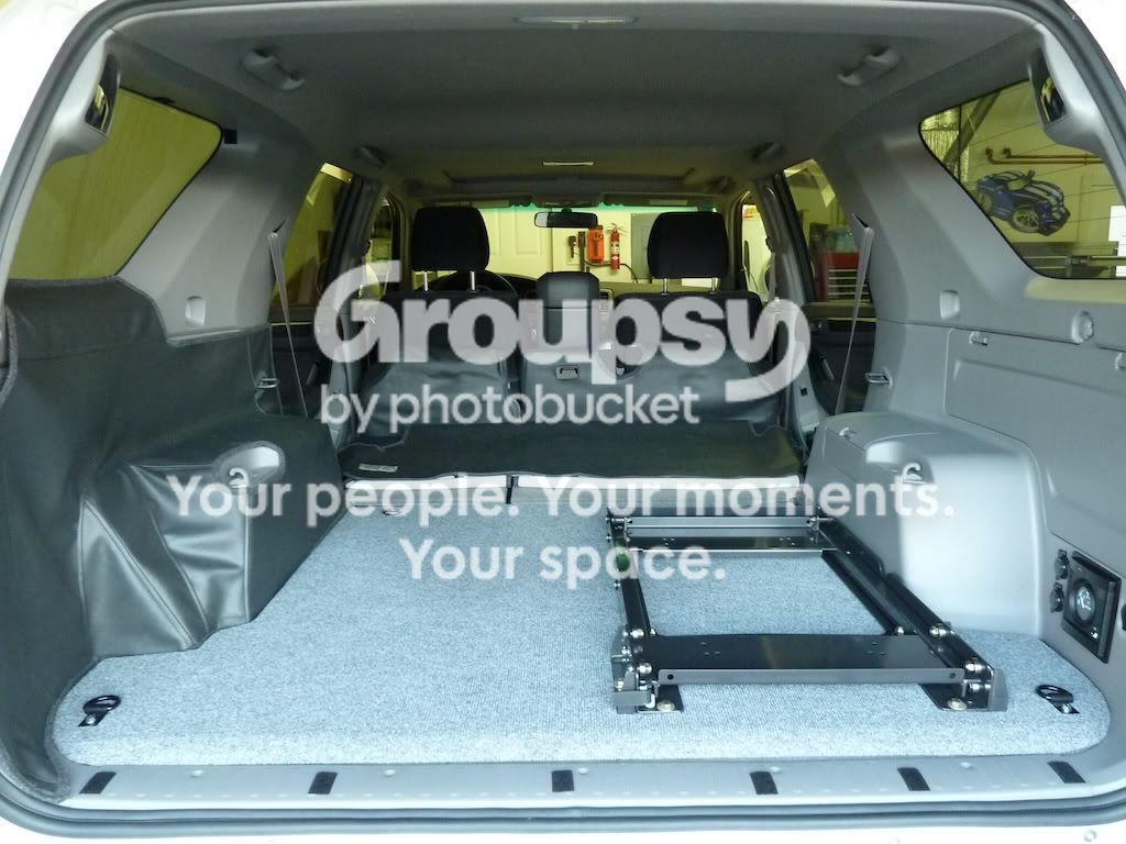

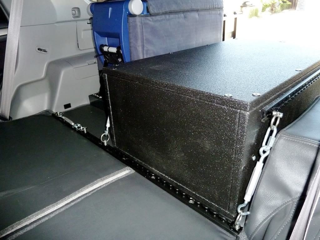

The ARB slide tray is secured to the plywood with 5/16-18 bolts and 5/16-18 T-Nuts on the underside.

Dawg, thanks for the explanation. I'm looking to do something similar for when I go fishing on the beach. I probably won't need the fridge, but I like the idea of the drawer for recovery gear. The way you have it installed, could you remove it if need be pretty easily?

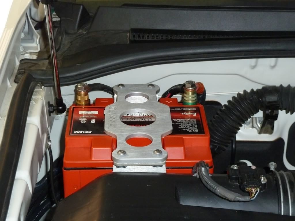

Dawg4Runner, Awesome build sir! Couple of question for you if you don't mind:
1. Where did you get the battery mount, same as who sells the battery? Also does the smaller battery operate just like a regular one?
Its just a matter of removing the 4 bolts and lifting the board out.
The battery and tray I got from Odyssey. The bracket that the tray sits on I had to fabricate myself. The battery provides 1200 CA and 550 CCA and powers all my accessories like fridge, Ham Radio, light bar. The IBS dual battery system isolates the two batteries when the engine is off and allows them to both charge at the same time when the engine is running. They can be linked together if I need more current.

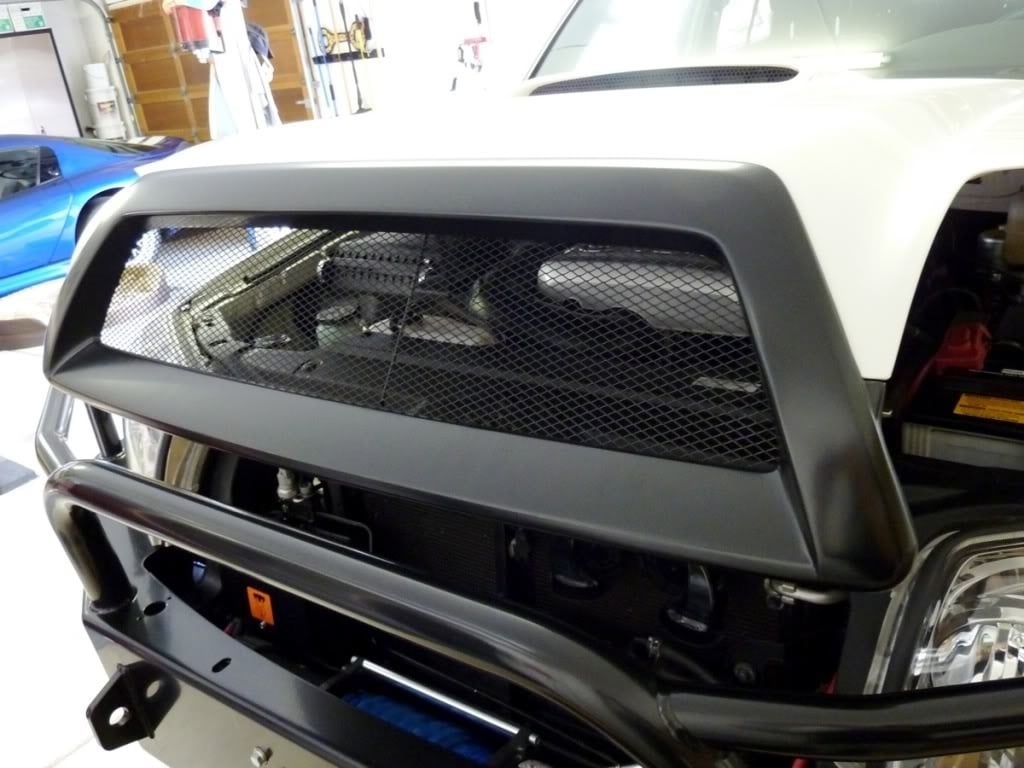

3. Where did you get that grill and does it fit the SR5 or just the Sport?
It's an Aura grill from Jaos. Got if off ebay a few years back. They made them for both 2003-2005 and 2006-2009 but I don't think they're available anymore. The grill is slightly different between those to subsets of the 4th Gen. Gaterose modified his own stock grill to look like that here: http://www.toyota-4runner.org/4th-gen-t4rs/103653-03-06-retrofit-satoshi-grille-writeup-picture-heavy.html

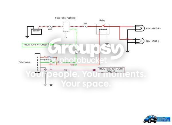

Aux light switch
Dawg, first of all AWESOME build. If I had the cash on reserve I'd be doing very similar mods to my Runner. Well done, slow clap for you.
Onto my question. Where did you find the OEM FJ Cruiser aux light switch? Ebay or something similar? What was the price like? Did you also need to buy the accompanying light harness to get it all properly wired? Then after you had your materials, what was the installation like? It seems like getting the center console removed and wires run is quite the task!! I think some high output LEDs are my next mod and I just love how cleanly you have integrated the light switch so I figured I'd pick your brain. Thanks in advance, really appreciate it!

I used the FJ light switch PN: PT297-35070-AS and wire harness PN: PT297-35070-SH. You can search the part numbers on line for the best price or just go here: Factory Fog Light Switch Kit SK1 SWITCHKIT
I used this wiring diagram courtesy of the FJ site. Be sure to use a relay as this switch isn't designed to handle much current.
