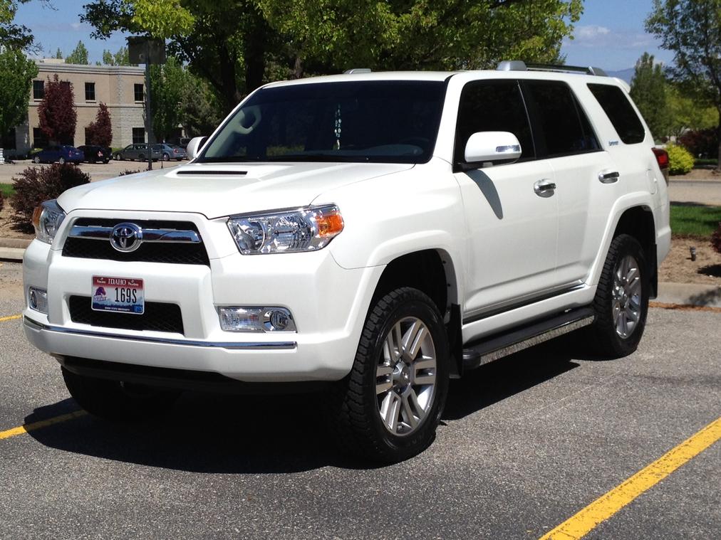

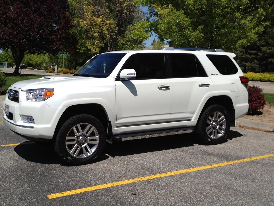

For you guys that have the DayStar lifts already (regardless of which kit), can you please post your new height measurements (from ground to fender)? Reason I ask is that I just ordered their kit, but already have the ToyTec front leveling spacer already installed (the 2" one). I want to see if it is going to be necessary to rip that out to install the DayStar front puck. I know it's slightly larger and being as anal as I am, will probably keep the whole lift DayStar instead of a Frankenstein lift haha. But I just want to see what this kit yielded you guys front and rear. Thanks!! :hatsoff:
ThirdToy,
Here is what I have for heights.
DF 37-1/2" to bottom of fender at center.
DR 38-1/8"
PF 37-9/16"
PR 38-1/8"
Slight dip on drivers front or maybe different air pressure in front tires?
Hope this helps.
I will post a picture this afternoon.
A couple of pictures.

Hey loving the TE hood on the blizzard pearl! Thanks as well for the measurements and pictures!
