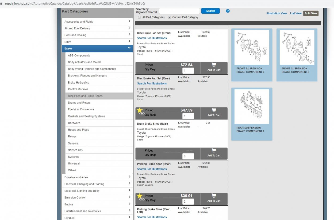

Here is what the dealer lists for brakes through their parts portal... only 1 set for the fronts. I bet they are quoting aftermarket parts.
