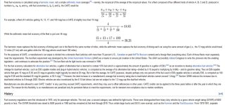

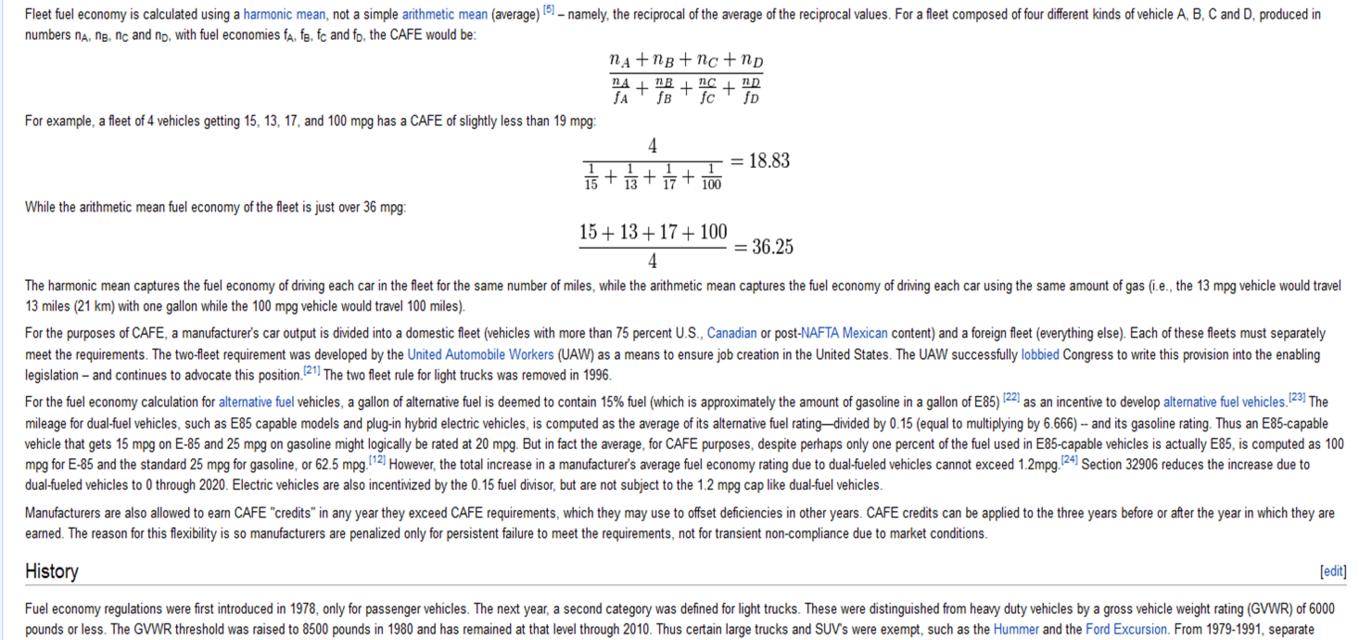

I'll give you one last reason why Toyota would not offer diesel 4Runners in the US and then I will be done. Again, remember the motivation for the manufacturers in the US: CAFE requirements. All the BS about "Customers want it, etc" is simply not true. Actually very few customers want it and they all posted in this thread. In reality very few people want diesel powering their personal vehicles for pleasure. I use 2012 percentages because 2012 is the latest data. Do you think it will go from 1.2% purchased to like 30% in a year Jayhawk? Me either.Anyway, here is the reason:
As you can see on the image CAFE is calculated much differently than a standard arithmetic formula. If I am an OEM I want to make sure my highest selling vehicles are also the most efficient. If I am Ford (F150) or Chrysler (Jeep GC) then I really need to improve those model's efficiency because they are my high production vehicles. The 4Runner sold around 50K vehicles last year here and the Jeep GC sold over 200K units. Chrysler does not have a high volume efficient model. Toyota has the Corolla and the Prius leading the way so they can afford to give the majority of the 4Runner buyers what they want (reliability, durability,) while giving them enough efficiency to make the vehicle marketable and not worrying too much about having to improve it beyond that.
In regards to the diesel engines used overseas, bringing them here is not an option without extensive rework, and some cases complete redesign because of emission regulations. If you want to get upset because diesel is not popular here then get upset at the EPA, not the manufacturers.
In regards to hybrids being used for larger vehicles: Don't think of a Prius application, think more of a "temporary use" application. What if you used a traditional drivetrain for level terrain applications and had the ability to throw maybe 80 extra HP in electrical form when you came to a hill or while towing up a hill? That is the hybrid system being proven right now from Kenworth on down and I know Toyota is working on it too. Think KERS for real world applications.

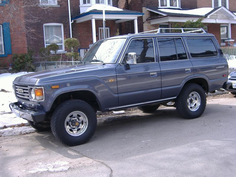

Sticking to the basics is wise, and why there are some HJ60s still around.
