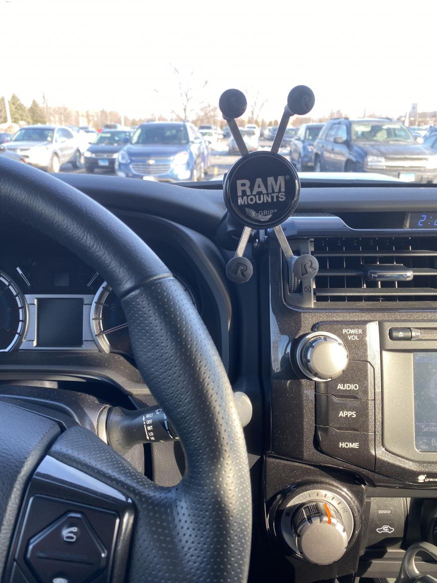

I did end up putting in a Ram X-Grip phone mount attached to the side of the radio during winter. I thought I posted a pic, but apparently I forgot. Just so people know, the diamond plate made for the phone mount does fit in this location. When I put mine in, I didn't see any feedback on whether or not it fits. It's a tight fit, but I made it work. I would recommend the shortest arm possible if you're going to use this location. I have a 3" one, which came in a kit, and I sometimes knock the rubber tips on the mount with my hand on the steering wheel (but I also have small hands, so this would be bothersome for people with normal hands).

How sturdy is this mount in that location?

Very sturdy. I think having two screw locations for the diamond plate, although it is a little trickier to put in, distributes the weight better than just the single-screw ball option. I ended up using rubber o-rings, washers, and nylon-insert locking hex nuts to secure it. Hasn't budged! More importantly, it hasn't cracked either.

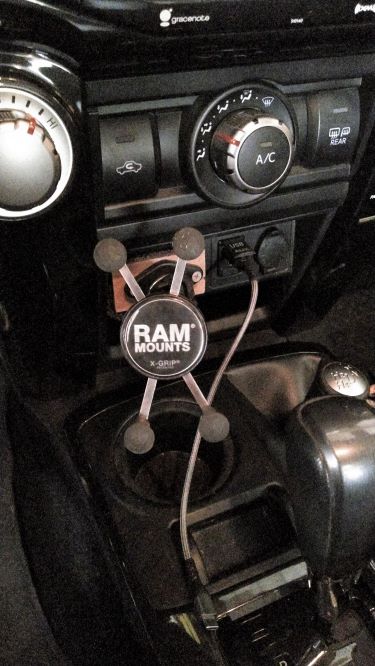

Tapered wood block inserted into cubby. Ram Diamond screwed into end. USB is used to keep power up while driving/using bluetooth.

I really like this idea, especially because it's a non-permanent solution, but I use that forward cup holder way too much (and I realize that's my problem lol).
You could even paint that black to have it blend in more, if needed.
