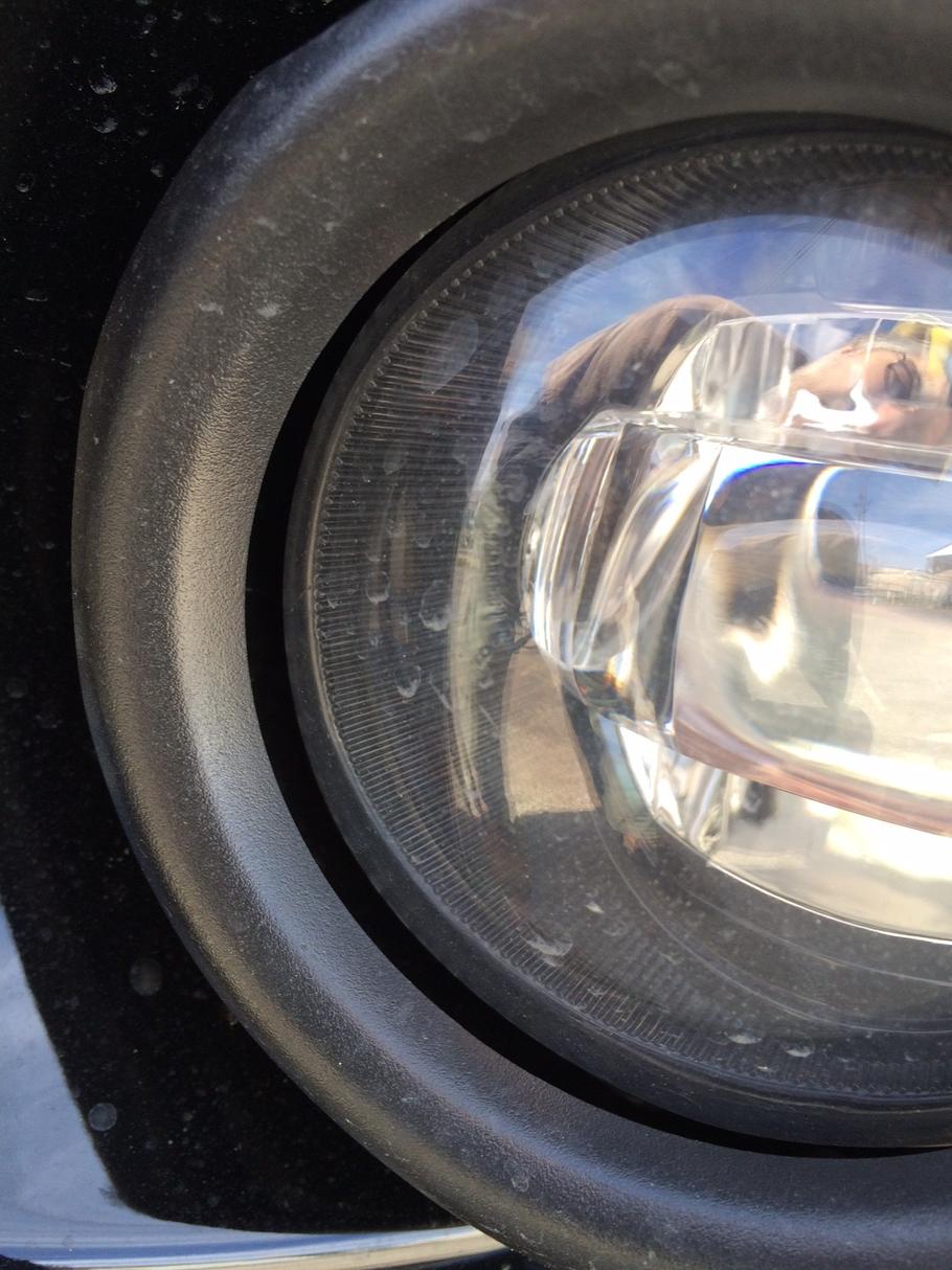

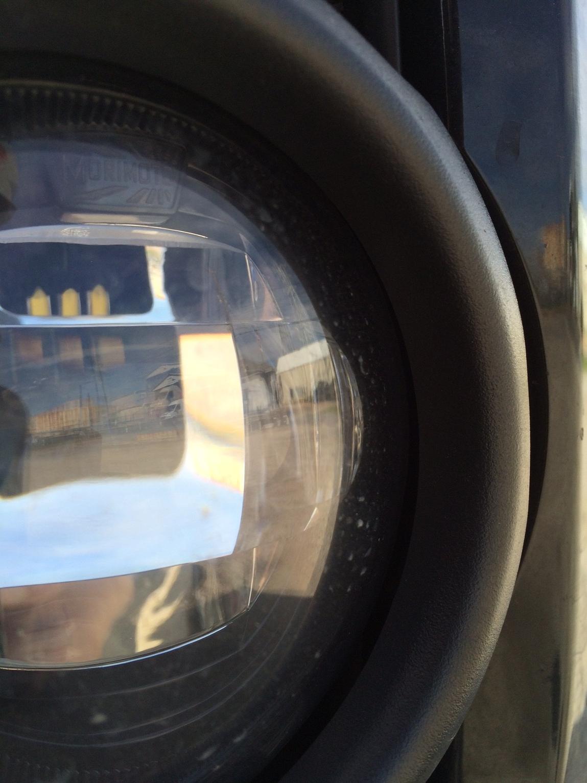

Is it possible to take a picture of the small gap you are referring to?
Thanks, Joe
Joe,
There is a very small gap between the actual projector lens and the bezel it fits up to.
Some people have placed the Morimoto LED unit into the OEM adjustment housing, but I don't know if that remedies that slight gap or not....
I'll see if I can go take a photo.
The gap does not effect the output of the fixture.

Steadymobbin still works for the discount, just ordered mine. Has anyone with 14/15 worked out how to get rid of the gap with the housing?
Yes that code still works for discount, I used it not long ago for spare HID's.
I don't know of anyone posting that they reduced/got rid of the small gap.
I remember someone removed the light assembly from the bracket and used the OEM bracket to install the LED foglight assembly, but never commented on the gap, only that fit was better IIRC. They may have just been referring to the mounting of the bolts/assembly.
When I installed mine, the gap didn't seem to bother me or my non-OCD!
Saker;Thanks for posting those pics. Is the gap due to the diameter of the new fog lamp or does it have to do with the mount point location.? Can something be shaved down in back to minimize the gap?
I don't know, I never compared before the install.
No help....
I (finally) installed mine today. I was curious about this and did a quick side by side comparison and the actually diameter seemed very close to identical leading me to believe that it is the mount point location that causes the gap. Spend a bit of time trimming the tabs with a dremel so that it sits the way you want it. The tabs were a more snug fit for me than in a lot of pictures on this thread so the trimming was a big factor in centring the lamp There will still be a gap but it looks fine to me.
I used barryhiram's method (post #19) on my 2014 TE. The steps were largely the same with a few exceptions. The slots for the tabs will look a little bit different, but same process. I had to do a fair bit of trimming on the tabs to make it fit the way I wanted it, and ended up taking off some plastic on both the tabs as well as shortening them to ensure a solid fit. I would also echo other posters in saying that the passenger side is a bit of PIA with the cover over that lamp. Hard to explain but it is a tab that is holding it into place - I just removed the tab on the right side and that gave me enough room to get the new fog into place.
