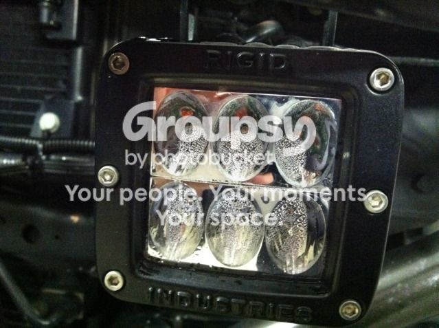

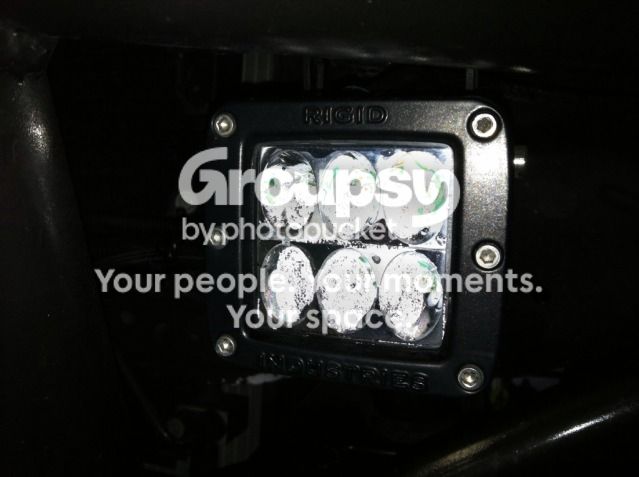

A few weeks ago I was looking the 4Runner over and noticed one of the Dually’s was leaking water. You would think that I would get used to this stuff, but it still bums me out. I guess its just part of wheeling (or my luck).
They have a lifetime warranty, so I sent it in for repair (or replacement). They were very helpful and polite, I got a call today saying that it was done and it was shipping out ahead of schedule, they also sent me email with the tracking number, warranty invoice, etc. We'll see how it holds up but so far they have been pretty stand up about the whole thing.

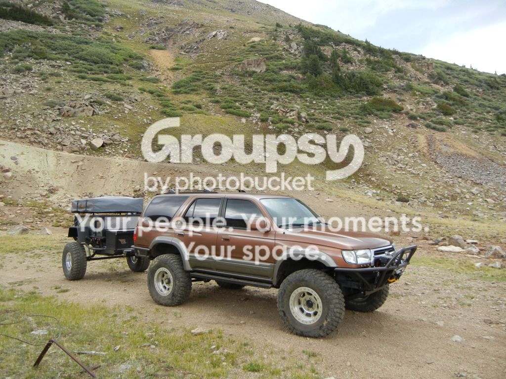

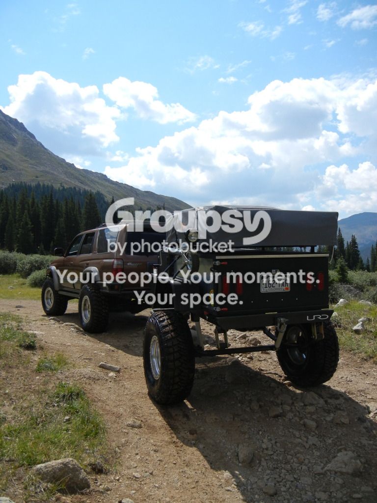

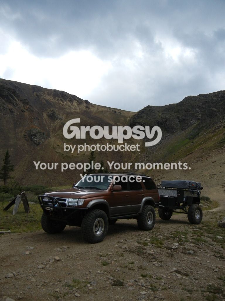

I’ve taken the trailer on two camping trips, but I’ve never really wheeled it. That needed to change!
I decided to hit a couple moderate local trails, and get used to the trailer behind the 4Runner. I ran up Peru Creek, then hit Chihuahua Gulch and Warden Gulch; none of the trails are that hard, but there are rocky sections, steep/loose sections, tight sections and plenty of river crossings. Pretty much a good way to get used to having a trailer behind the 4Runner and kill off half a day, not to mention the views are amazing!
