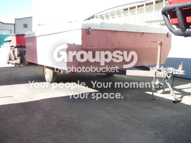

NICE! I've done some moderate trails with my little tent trailer once... when I got it back home... my tow package (which was bolted on at the time) had come down about 1", and the crank jack on the front was twisted sideways from all the bolders I hit! lol!
I've since had the tow package welded to the frame, and fixed the crank jack.... but would definitely benefit from having some 33" tires on there, and some heavy duty shocks and springs! lol!

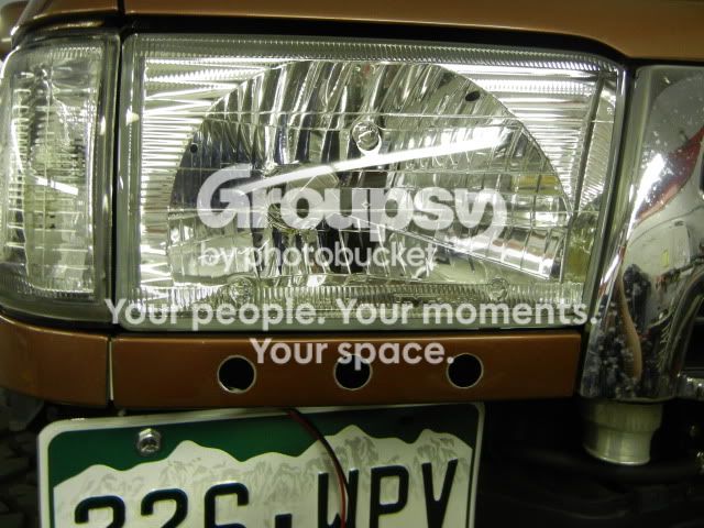

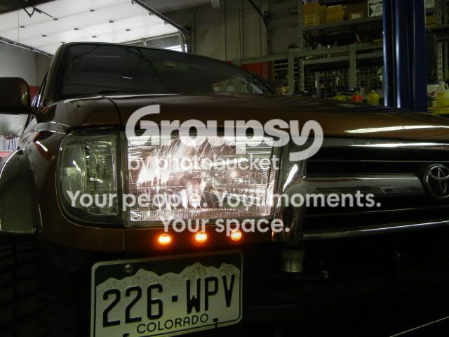

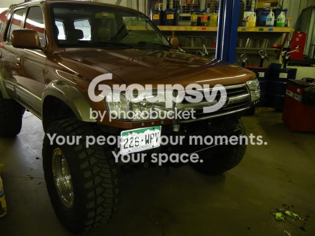

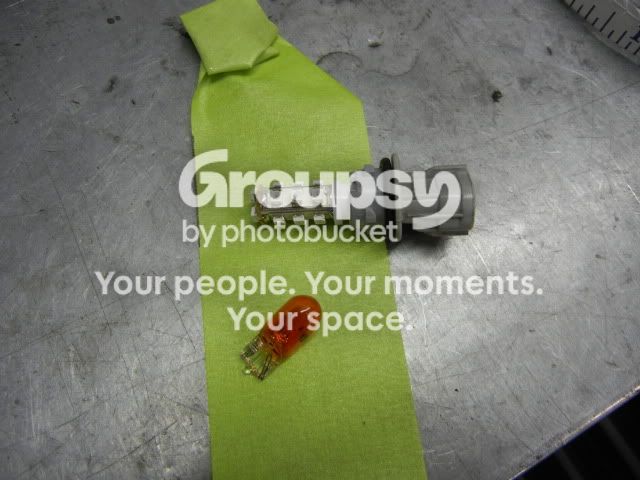

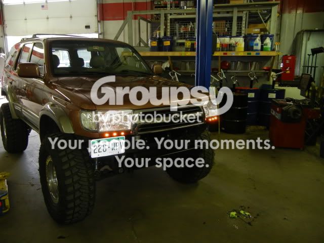

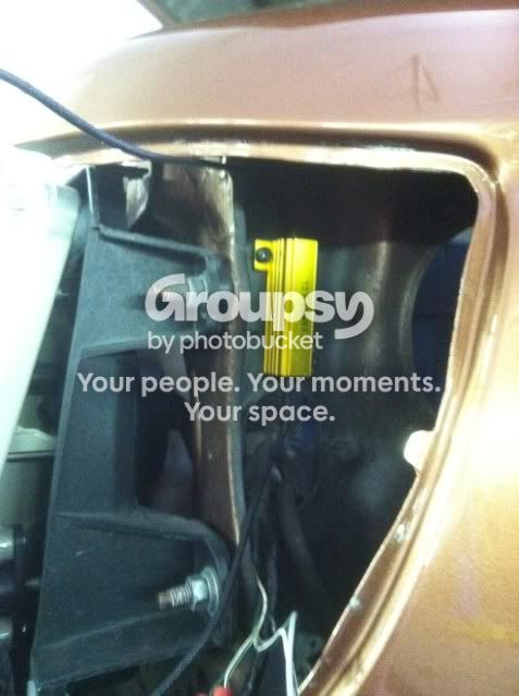

When I took off the front bumper I lost my turn signals. On my last 4Runner I converted the corner marker lights to turn signals using bright LED bulbs and a modified flasher. I decided to do the same thing on this one, so I bought some bulbs and load resistors.
DSCN0575.jpg~original
088c604d.jpg~original

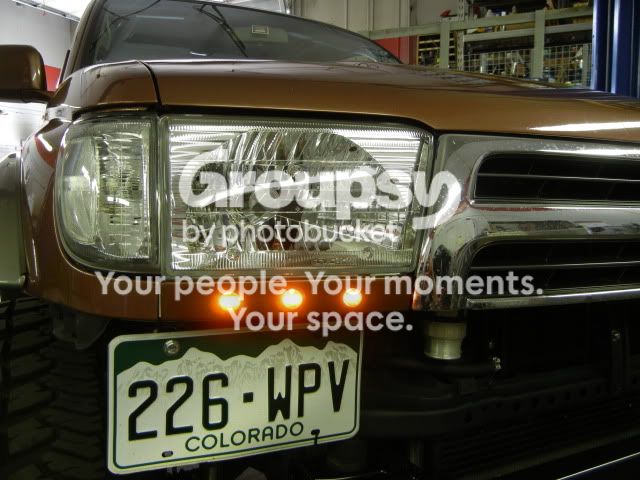

The Turbo 4Runner did not have front marker lights but I figured on this one I should (to keep the police happy). I thought about it for several days, then I saw an Audi that had the LED day time running lights. It gave me an idea.
I bought six 1” LED lights that are clear (to match the headlights and clear corners) but have an amber light. I mounted them in the panel below the headlights. I like the way they turned out, but I’m debating switching them back to my turn signals. It seems like the corner markers are not bright enough and people don’t see them all the time. I’m going to give it a week or two, then decide.

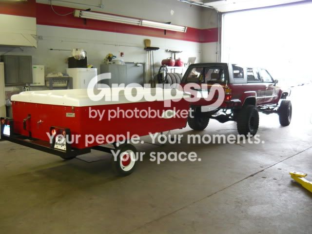

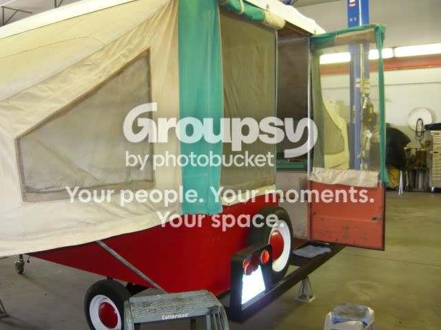

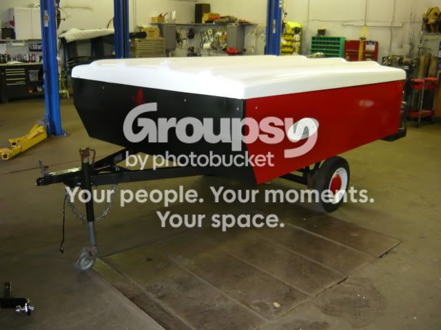

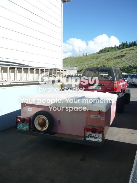

Thanks! Yeah, wheeling with a stock tent trailer can be a little rough! I bought an old antique tent trailer for cheap, and did a decent little restoration on it. I also lifted it 11" so I could tow it behind the Turbo 4Runner and take it down easy to more easy/moderate trails! :D
It was a fun project, but I ended up selling it.

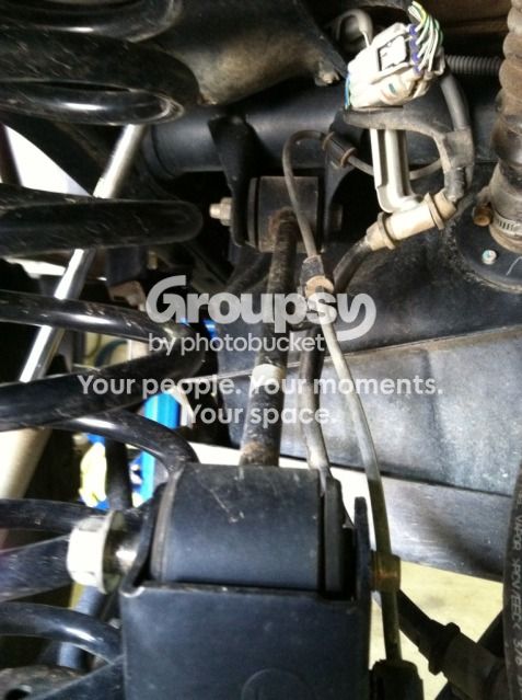

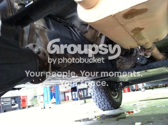

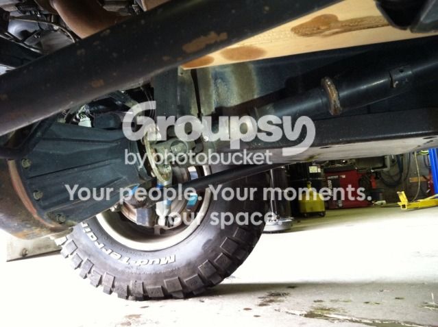

I gots a question on the FROR full float setup!
Did you lose the speedometer when you disabled ABS? I've heard that the speedometer will go out sometimes if you remove the rear wheel sensors. If so, did you install a VSS on the t-case?
Yes, the speedometer still works. I noticed when I first start driving the 4Runner in the morning (or after it's been setting at work all the day) the speedo takes a few seconds to kick in, but after about 10-15 seconds it works fine. I didn't even notice it at first; I mainly use my GPS unit because the speedo is off so much. I saw the needle jump one day after work, and I kept an eye on it after that.

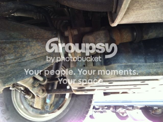

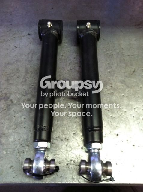

I’ve always been a little weary of the stock rear upper control arms, they are tiny and there are several people who have had failures. After seeing Ripcord’s UCA failure it moved to the top of my list, I also wanted to dial in my pinion angle.
I thought about making my own, but I decided to just buy the ToyTec links instead.
Here’s the old link, not very impressive.
4d3d8bf6.jpg~original
And the new links, these should hold up a lot better.
c6ce2d68.jpg~original
Installed
6adee51c.jpg~original
Make sure you use one of the old links as a jig, get both arms to the same length, and then count threads to evenly adjust your pinion angle. One of my arms was slightly longer than the other, without jigging and measuring them you could run into handling and alignment issues. I didn’t take any pictures of the pinion angle before the install, but here is a picture of a stock 99’ 4Runner that was out in my parking lot.
55f53d46.jpg~original

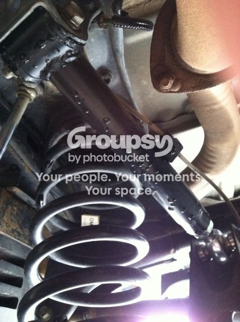

And here is what mine looks like after the new UCA’s
989cbcaa.jpg~original
Looking at this picture you can see that they could use just a little bit more adjustment, but the pinion angle is a lot better than it was.
da628691.jpg~original

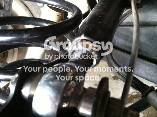

Here is the reason I have not adjusted them more; only a 3rd of the joint is threaded into the link. I’m comfortable with them right now, but I’m not going to adjust them any more until I do some more research on thread engagement for a joint this size. I’m sure it would only take a turn or two, but better safe than sorry. The other issue is that the track bar is getting close to the axle housing at full compression. Like I said above, it’s still a lot better than it was.
e9f5b7d1.jpg~original
Typically, the width of the bolt threads need to be engaged into a nut (eg:1/2" bolt with 1/2" thread engagement). With that said, I don't know about rod ends. I'll be following to hear that answer.

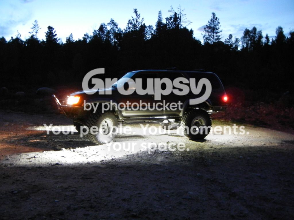

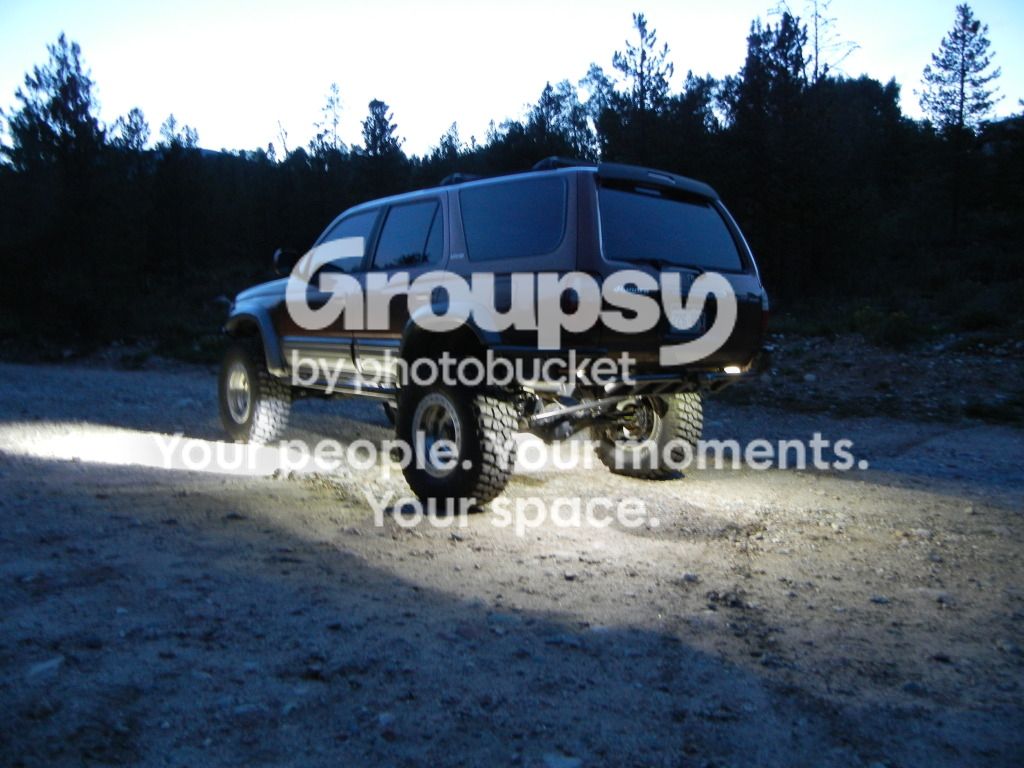

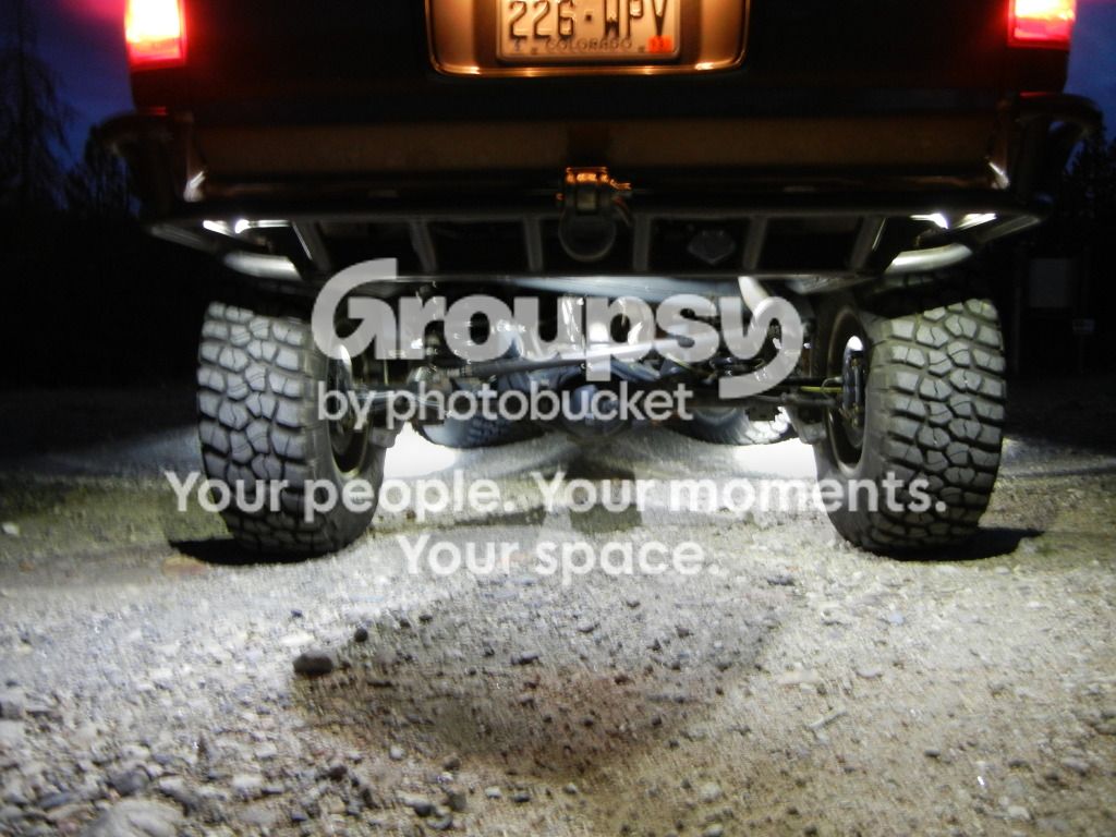

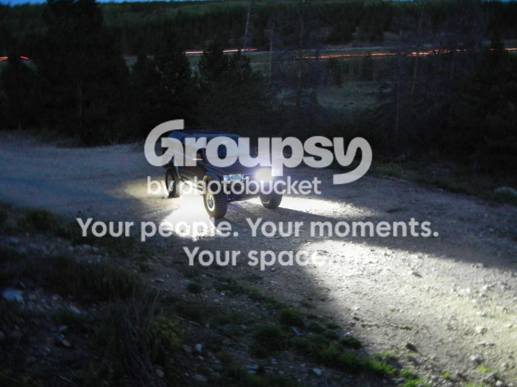

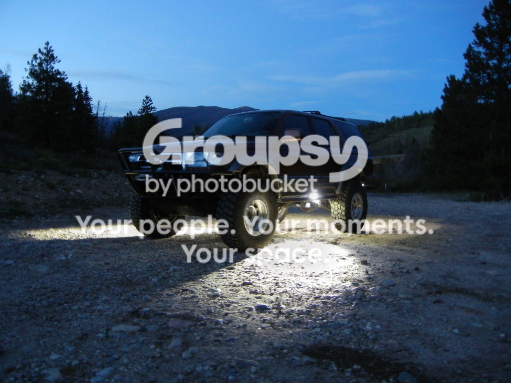

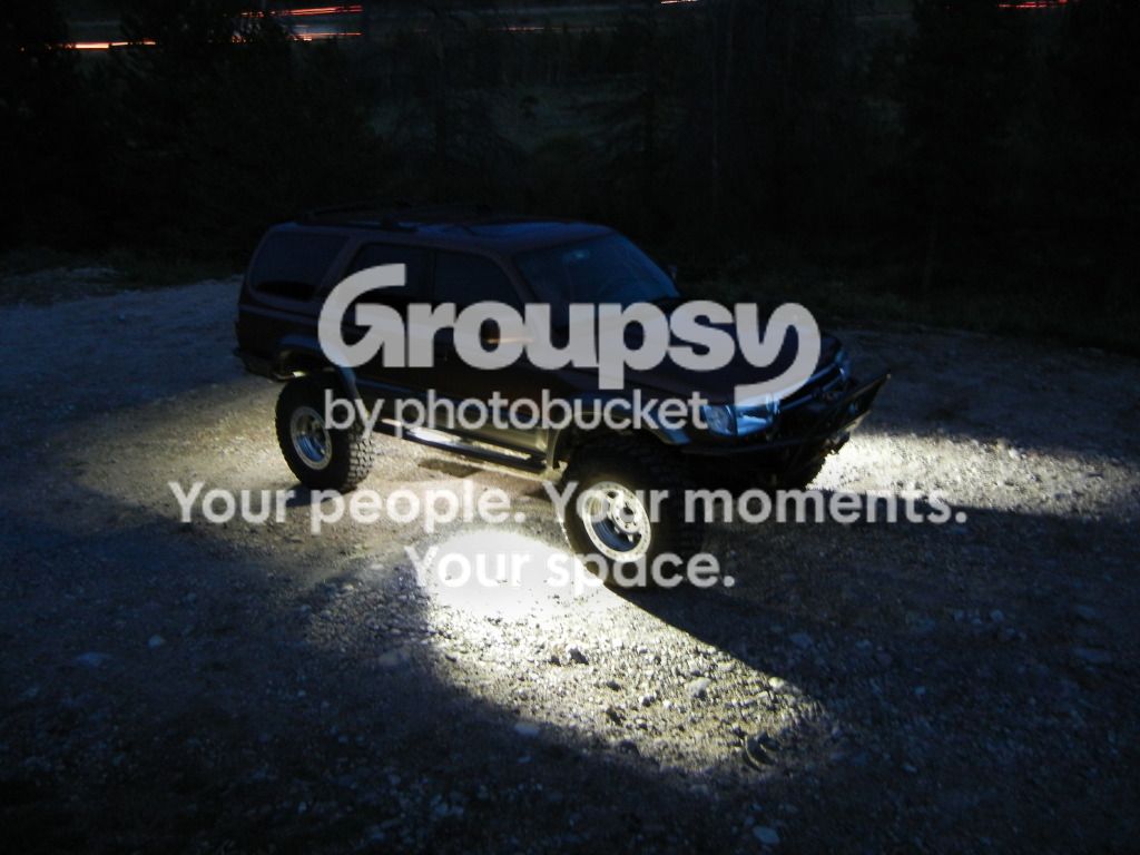

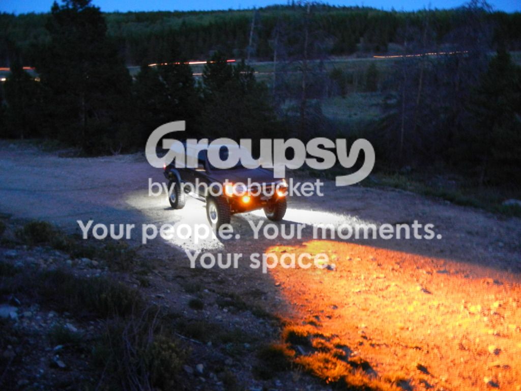

And what everyone wants to see, pictures of the lights in action! I can’t wait to see the trailer hooked up with the rock lights going!
Some of the pictures are a little blurry, when I turn my flash off in low light conditions it over exposes the photo to create more light but it’s hard to keep the camera perfectly still.
DSCN1588.jpg~original
DSCN1591.jpg~original
DSCN1594.jpg~original
DSCN1603.jpg~original
DSCN1604.jpg~original
My take on the rock lights…
- The Oznium lights are super bright for their size, and well worth the price!

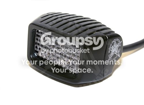

- The Rigid SRM (single row mini) is even brighter than I expected, and the flood pattern is a little intense for a rock light.
I have felt that there has been something missing from my lights; I’m happy with the product and lights but something was lacking. At first I thought I needed more long distance spotlight, but on the rocky/wooded trails in my area that’s not really an issue. If I’m in the desert there’s a good chance I have the trailer behind me and I won’t be bombing down the trail. After playing with the lights and looking at the pictures it came to me, I need a wider beam and more light on the side of the trail. There is a serious dead spot on each side of the truck, the stock headlights help a little but there could really be more light in general off to the side truck towards the ditch.
I’m thinking my solution will be to move the flood pattern SRM lights to the front bumper, aimed at the dead spots, and get some SRM lights with the diffused lens for their replacement. The diffused lens will give me a more spread out light pattern (60 degrees) and it’s less intense. The Rigid lights are pricey but IMHO worth it; they have a lifetime warranty and the electrical draw is a fraction of the old lights (10 watts vs 55 watts each). Once you figure in all the lights on the truck and trailer the wattage starts to add up.
