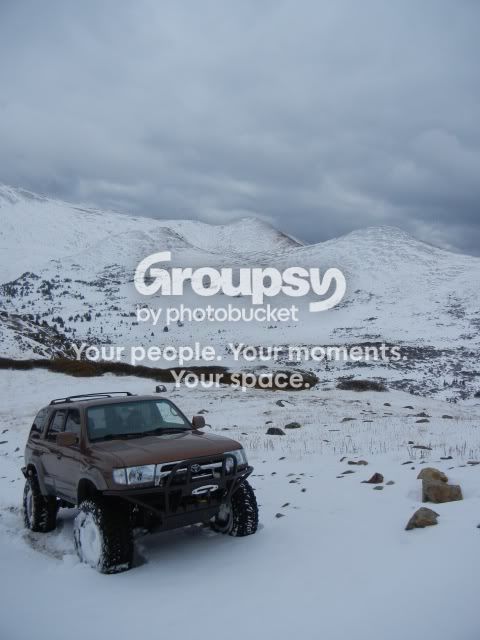

That was the end of the road, the trail that heads over to Deer Creek and St. John's was still snowed in at the really steep section. Trust me, there's no breaking trail up that section, I'll just have to wait for the sun to melt it. Also, the gates are still closed at the beginning of those trails so I wouldn't have made it far.

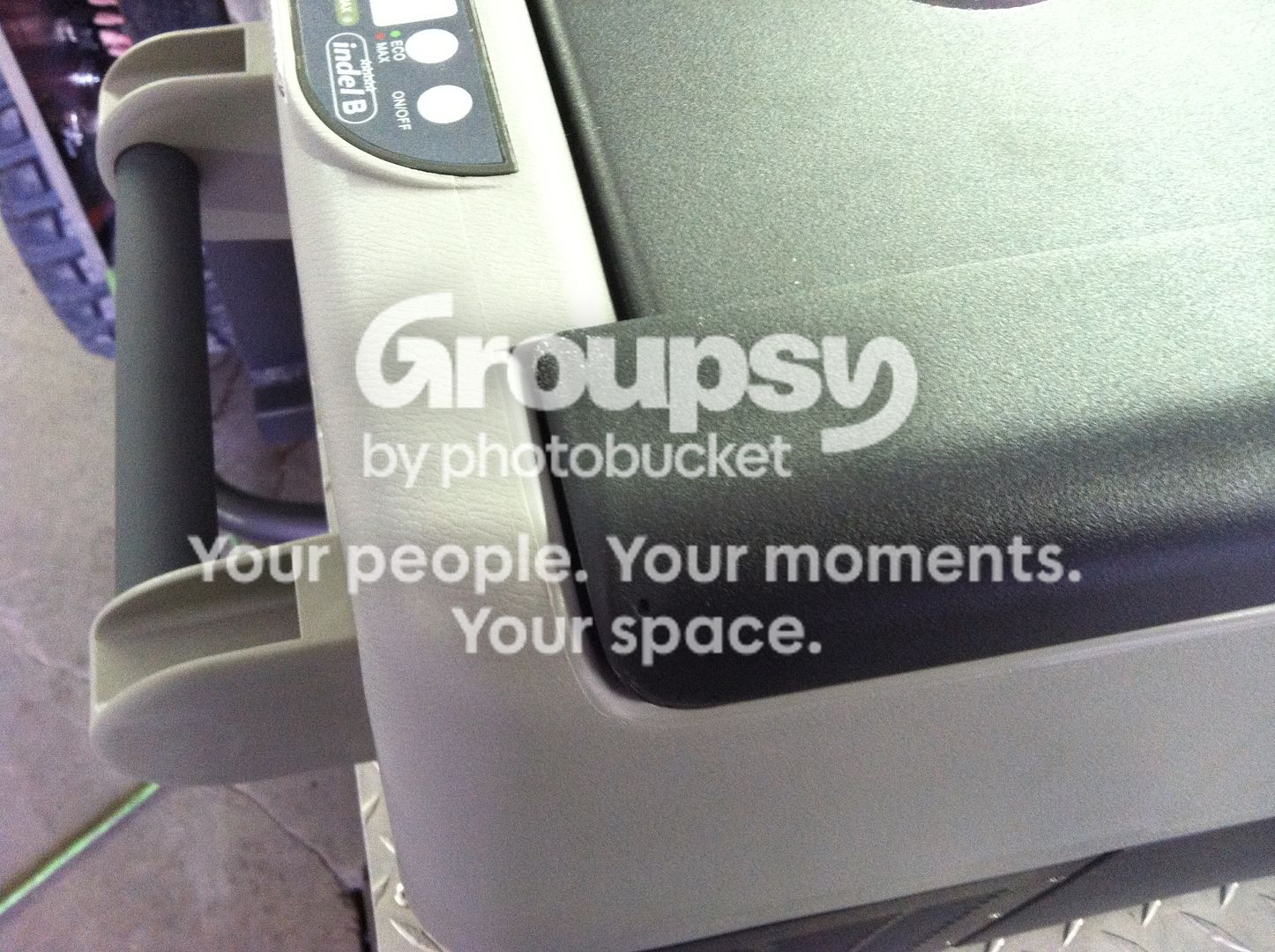

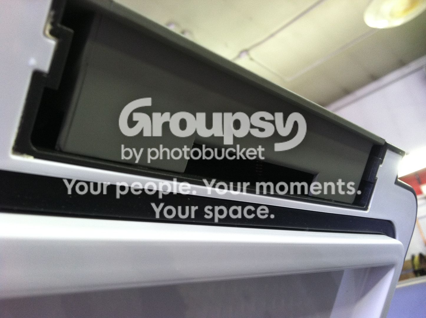

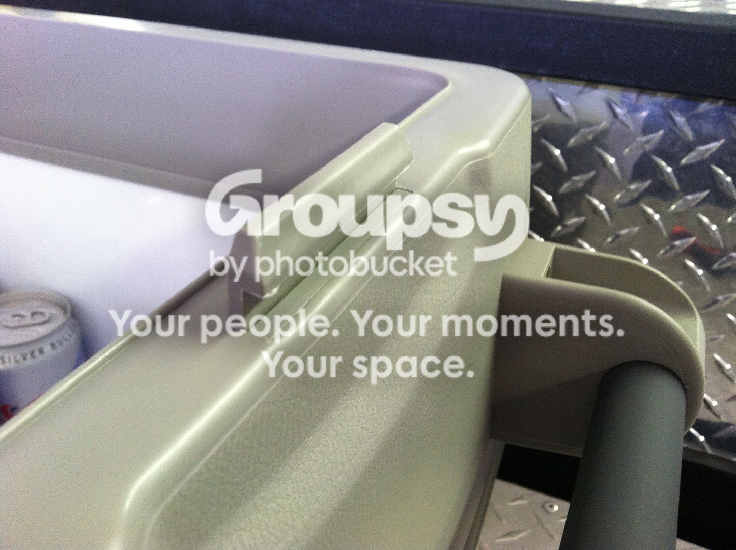

Great find on the fridge, I've been saving up for one but it keeps getting bumped down on the list. LOL. I had decided on the ARB but now this looks like a great alternative and uses the same compressor motor. How does the lid latch, and does it seem like it will stay closed as you bounce up stuff? Also do the hinges look solid like they will stand up to some abuse? Sorry for all the questions but saving a couple hundred on a fridge would get one in the back of my runner much quicker:banana:

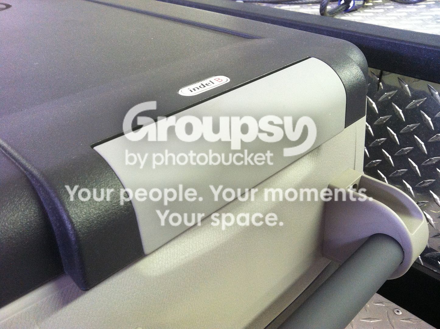

I've never had my hands on an ARB fridge, so I don't really know how the latch and lid compares. This fridge is pretty much on par with the price, it should be fine for food on expedition style trips. But, if it's full of cans or beverages and I'm wheeling harder terrain, I might need to throw an extra strap over it to keep the latch and hinge from breaking, we'll see. Here is a couple pictures I took for you.
One last thing is what is the amp draw on that thing?
It should have the same specs as the Ironman fridge listed here, Ironman 4x4 Fridge . I honestly think depending on conditions that it should be comparable, or at least close to the ARB fridge. I had it hooked up to the trailer for a few hours yesterday and it didn't seem to draw much at all off the battery.

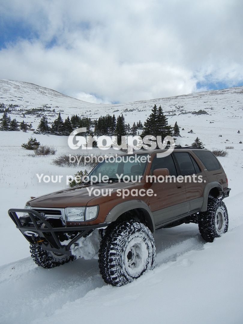

I looked through my pictures and what would you know, I was on Webster Pass October 9th, 2011. Judging by the snow, and the storm that rolled in the day before, he must have gotten stuck only a day or two before I was there (Edit - He must have gotten stuck Friday night, and I was there Sunday morning). There’s no way he would have gotten that thing over Red Cone with the snow I was going through. Here is the first picture, the saddle behind me is the end of Red Cone, and the summit of Webster Pass. I made it to the last switch back and without the front locker being hooked up I couldn’t make it any further. He was only one ridge over to the left of the picture, and I bet if the 80 wasn’t white I might had seen it. It was probably right in front of me!

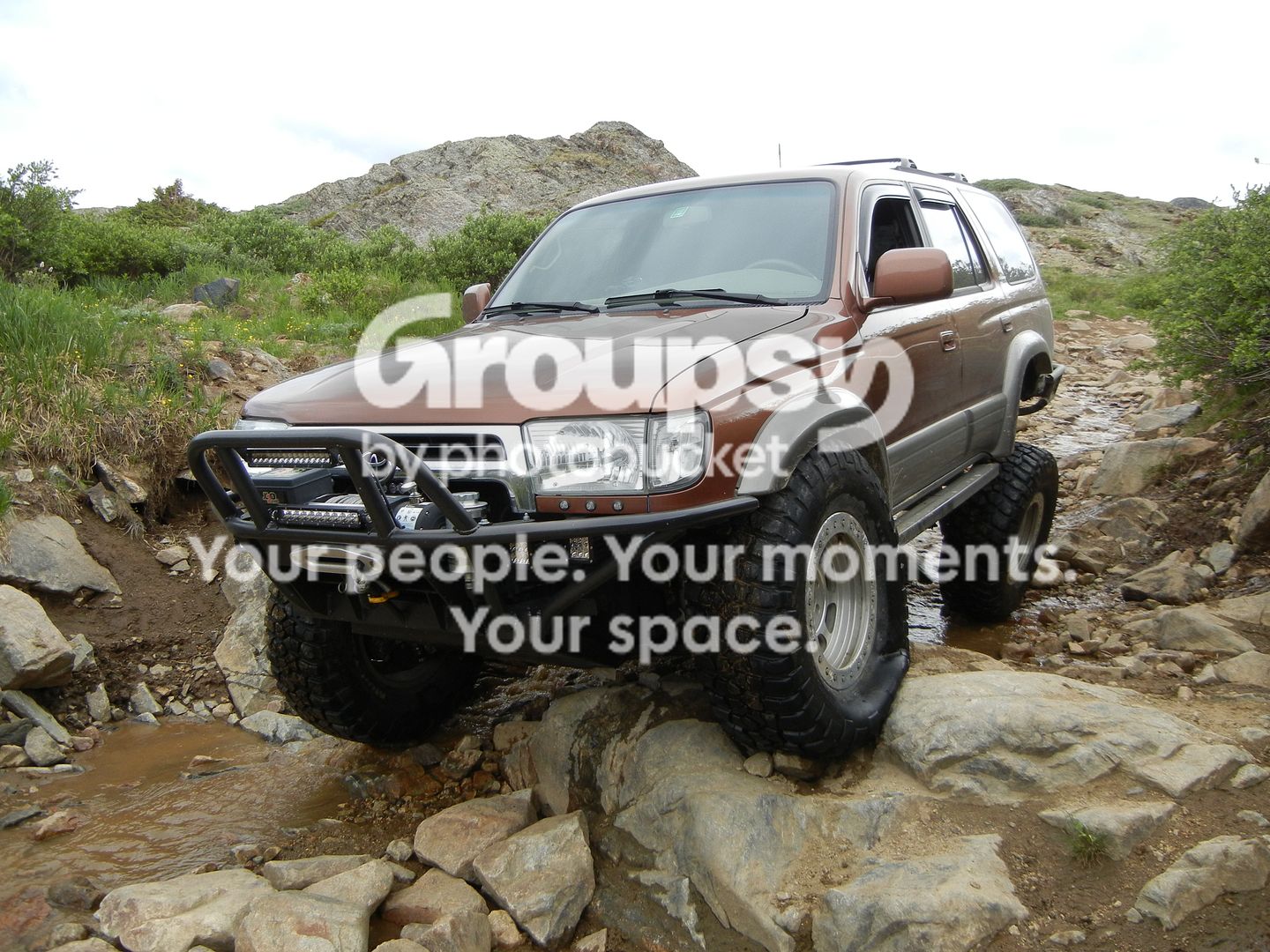

I broke my second Lotus axle CV axle shaft; so far I'm the only one to break one, not to mention two!

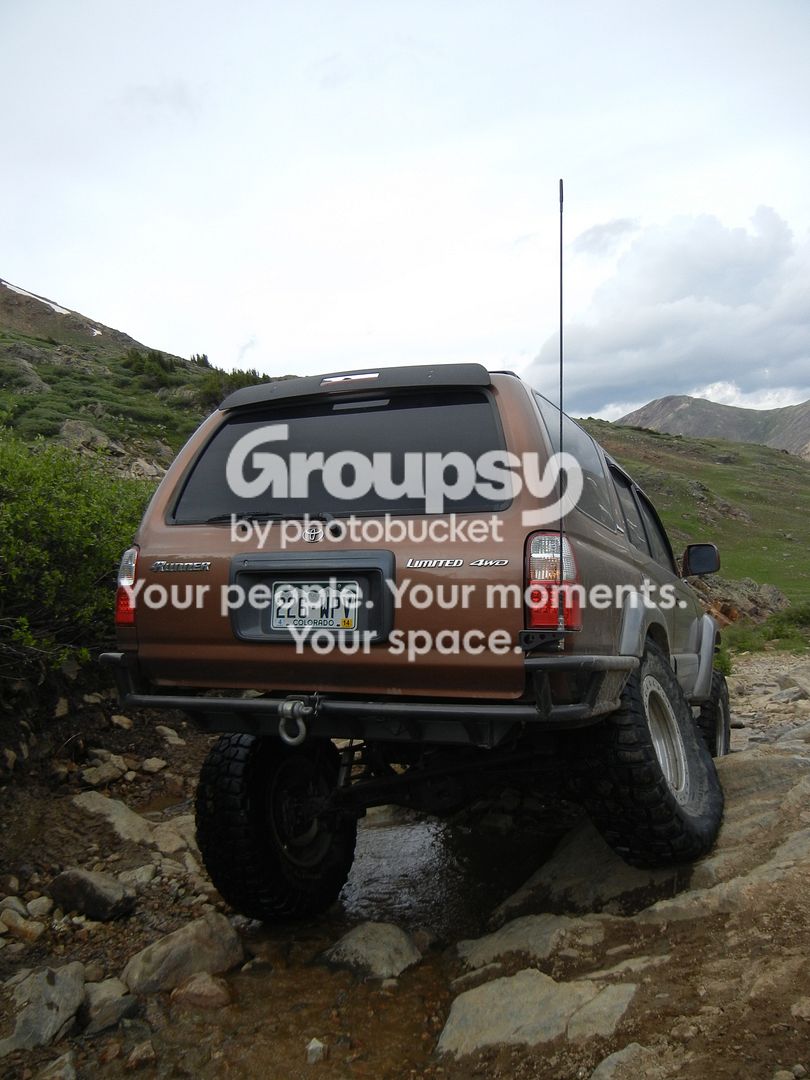

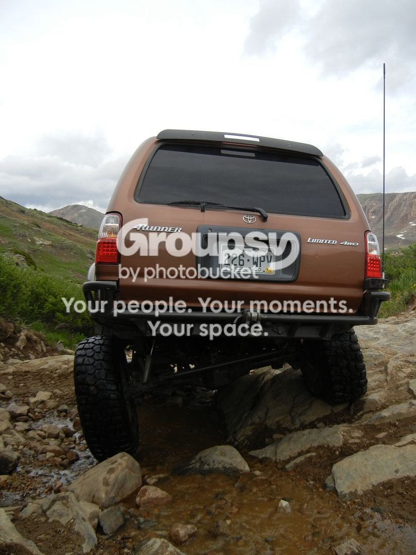

It happened on the second obstacle of Wheeler lake, left fork, right line. I slipped off my line and fell into the largest hole on the right side, I tried to drive out of it and turned hard to the driver side. The front was locked, turned hard driver, and the 4Runner was leaned way over on that passenger side (look at the trees in the background). Watching the video you can hear a small snap, then the sound grinding metal as the 4Runner tries to climb the ledge with the passenger side outer CV joint broken. For reference I do have front limit straps and less droop than most people.

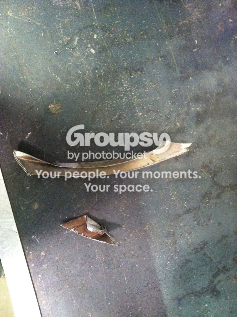

I tore into it and found that the inner star inside the outer joint is what broke, the outer cage is still intact but beat up from all the broken parts. The splines are shot on the axle bar, that's the grinding sound you could hear in the video.
There's no doubt these are much stronger than stock, and Glen has been great to deal with, top notch! But I really need to decide where I go from here, more on that in a few... On to some pictures.

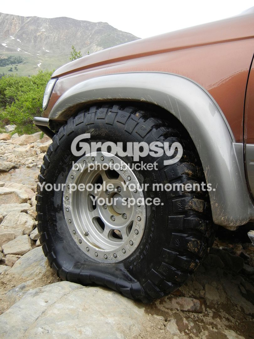

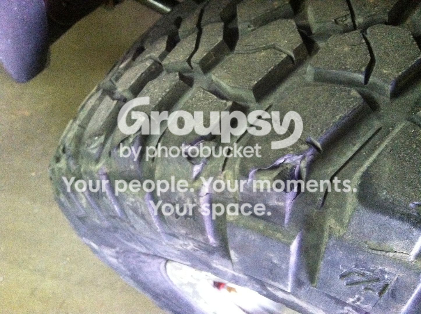

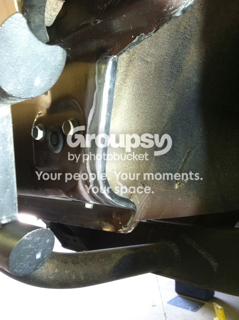

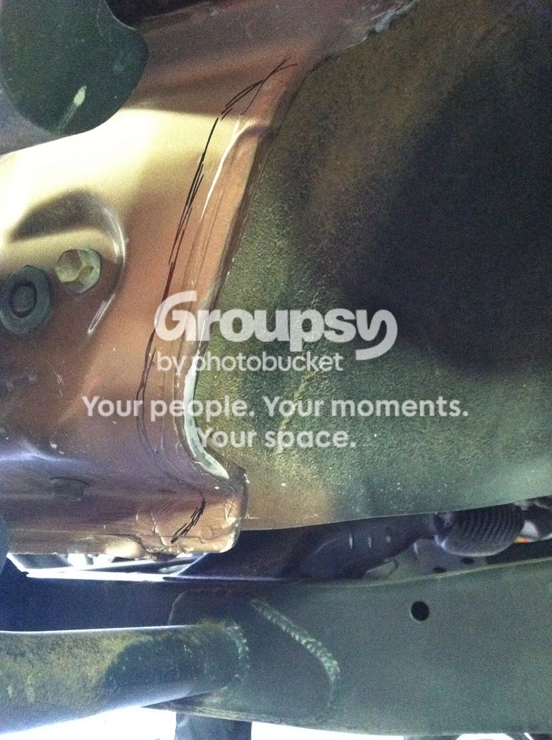

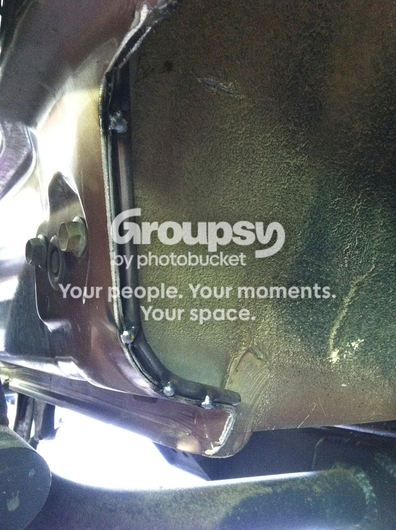

I got twisted up pretty good and slid off my line again on another spot, thanks to the front being broken. The D/S rear tire compressed more than it ever has, and in the process it contacted the body, bent it, and chunked out the tire. Just great! :(
I didn't take any before pictures, but you can see the sheet metal is bent and the corner edge is folded over which tore the tire.
Here is the P/S after the same treatment the D/S got. I welded in some 1/4" round rod to add strength and keep it smooth in case I have another issue down the road where the tire touches it. I still need to address the area below the fender flare and above the cut, but that is pending on the future state of the truck.

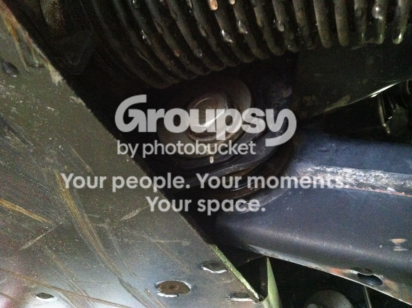

I also noticed my alignment was off after that trip. Luckily I marked my alignment tabs and could tell things had shifted around, so I re-adjusted things back to where they should be (kind of).

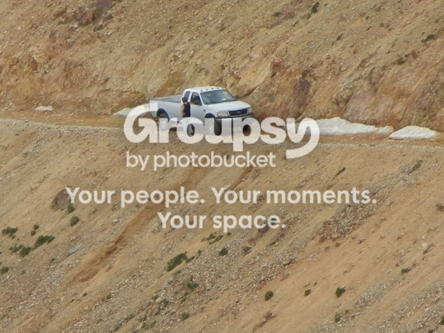

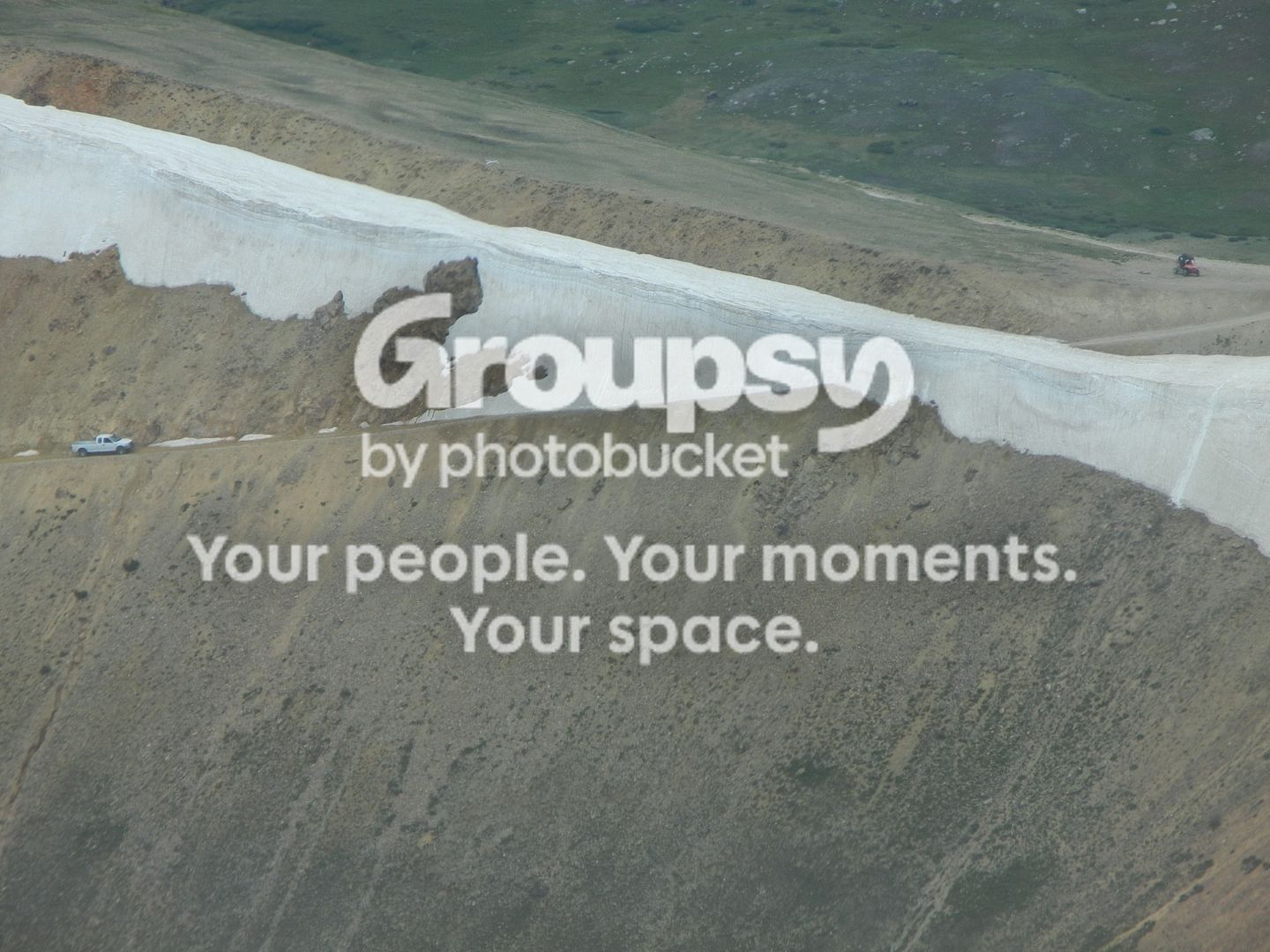

At the top of Red Cone I could see a truck stuck on Webster Pass, I would NOT want to back down that (there is no place to turn around)! It's their own fault, you can see the top of the trail from the bottom. I'm guessing that stock F-150's can just bust though 40'-60' snow banks without an issue?

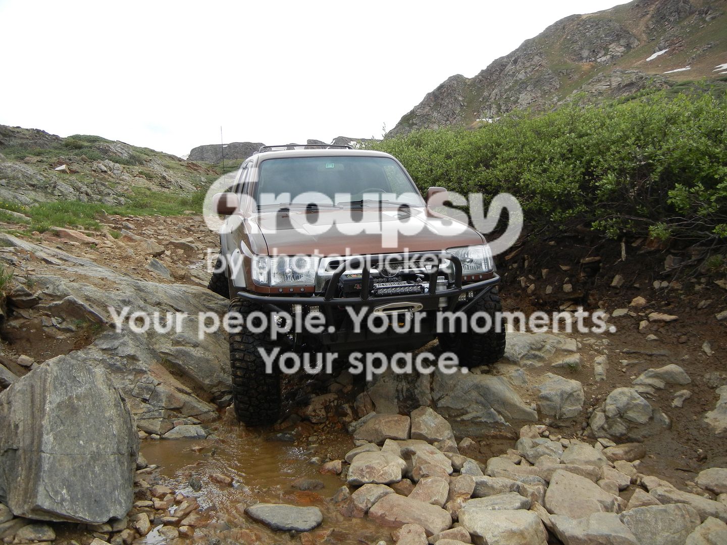

I tried to go over Radical Hill but it was still snowed in. The IFS still flexes pretty good with the sway bars gone.
