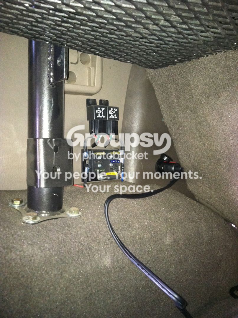

First, I wired up a full time 12 volt outlet for the fridge. Having the rear aux fuse block right next to it made it super easy!

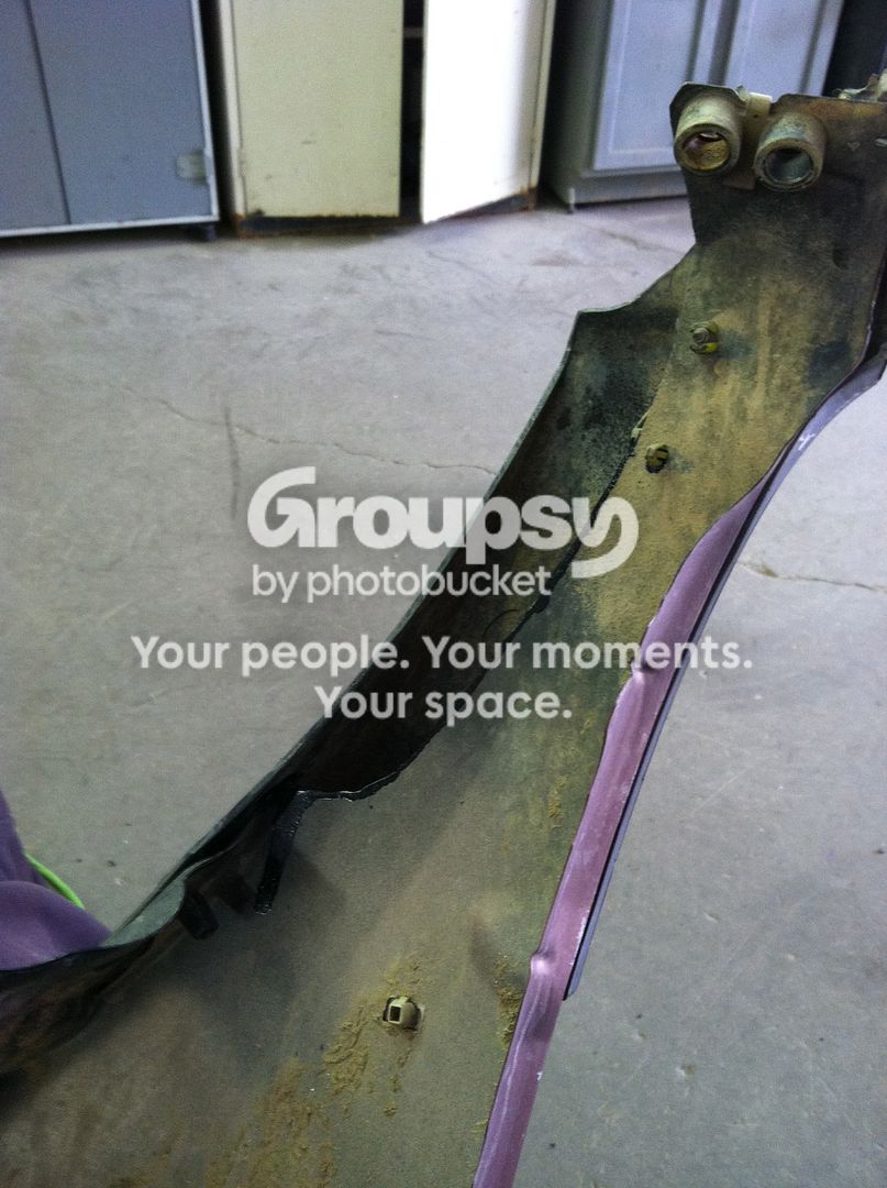

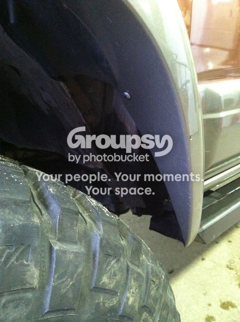

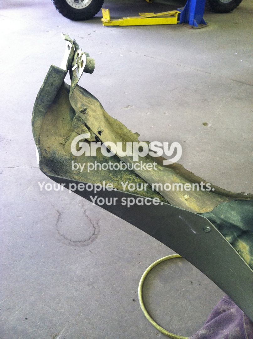

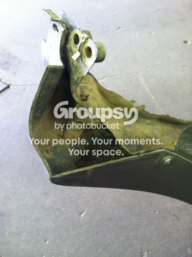

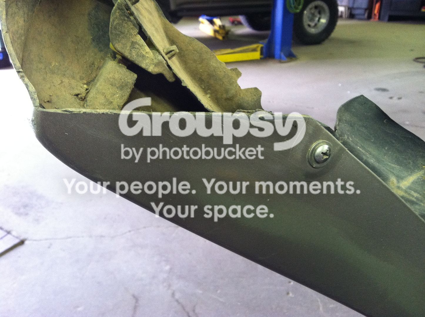

Since I removed the front sway bar the front tires have been rubbing the fenders. The amount of extra up-travel was more than I though it would be, which is a good thing but required some work.
I decided to just dive in and get it over with. I pulled the fenders, and got to work. You can see the rub marks on the flare.
Here is the old cut
And the new cut

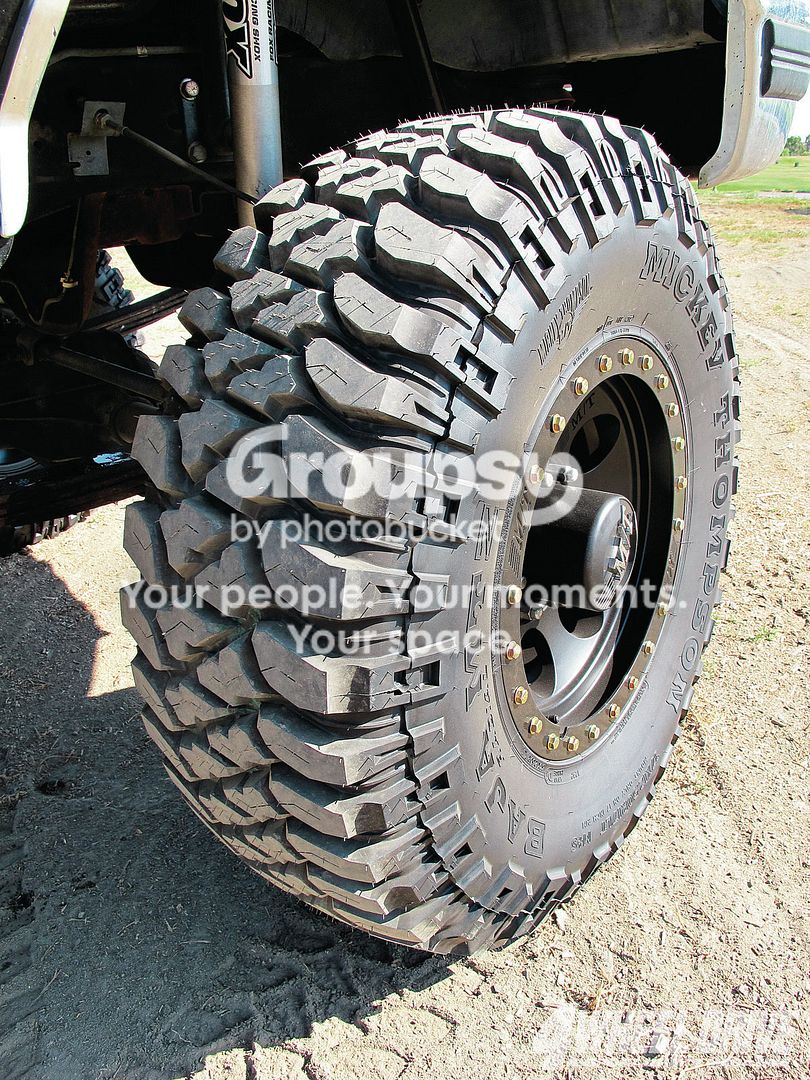

Here is a picture of the MTZ for comparison. I believe that the sidewall alone would make a difference in the amount of traction the tires have in snow, not to mention the rest of the tread. (Disclaimer - I have no idea what size that tire is, so the tread depth could vary.)
